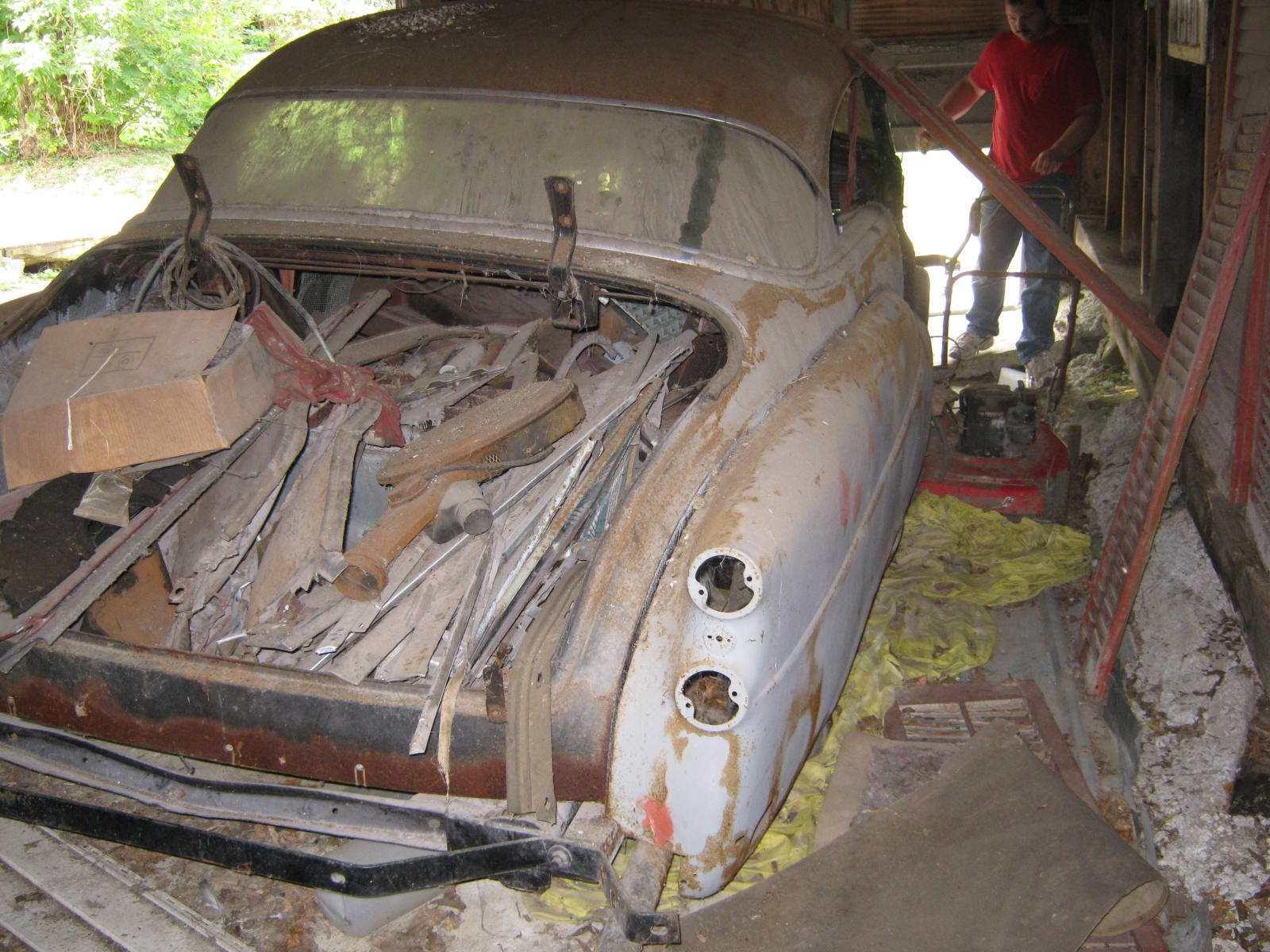

    Three -four years ago I heard about this 53 buick roadmaster that was in a barn, so I decided to go find it and see for myself it was still there, well a long story short, it was, so I talked to the owner and we made a deal and a couple of weeks later it was in my driveway. I got to looking it over and thought , what did I get myself into. As you can see in pictures this thing was all apart and with parts inside the car and the rest of them scattered in different locations in a five mile radis. The good thing about it is that it sits on a 77 Caddy chassis and it is a hardtop. someone had started to build this car but for what reason gave up and the guy I got the car from had bought it the way I got it and just never did anything with it. So now I start my journey. IMG_0324.JPG IMG_0325.JPG IMG_0326.JPG IMG_0327.JPG

    "I got to looking it over and thought , what did I get myself into."
    I guess you must have washed it and taken the parts out by now? maybe it won't look so rough

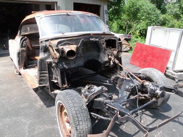

    GEDC0040 (800x600) (640x480).jpg GEDC0059 (800x600) (640x480) (640x480).jpg GEDC0038 (800x600) (640x480).jpg I have been working on the car off and on for a couple of years now, so yes the car has been cleaned out and it turned out not to be so bad. I've been trying to reduce the size of pictures so I could post and got some done so here are some after it was cleaned out

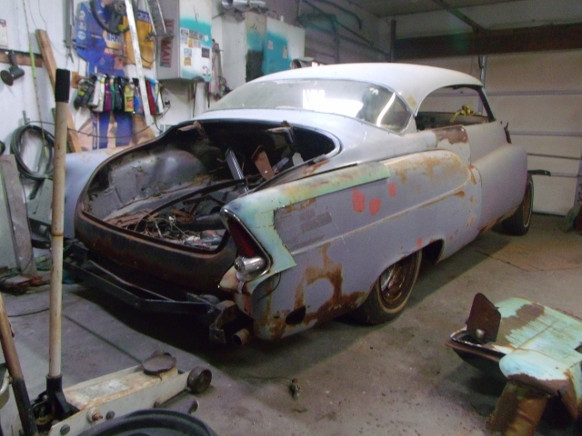

    after getting it all cleaned out and looking at it I decided before I got to far into the mechanics of it I would try my hand at chopping it. I was told that I would have a hard time with it because I wanted to keep the stock back window, so when ever anyone tells me I can't do something, my aim is to prove them wrong. So I went ahead and put the saw to it. I didn't take a lot out, 2 3/4 out of the front to start with and trimmed some more off to get it to where I thought it looked ok. Don't ask what came out of the back, because I never put a tape on it ,I just keep adjusting it till I got the flow to where it looked good to me. The front ended up just a bit over 3",here are some pics. GEDC0061 (800x600) (640x480).jpg GEDC0073 (640x480).jpg GEDC0088 (800x600) (640x480).jpg GEDC0096 (800x600) (640x480).jpg

  13. I hate to be criticle here but I fail to see any bracing inside the car or even the doors welded shut,,,Have fun and Rots a Ruck..you gonna need it

    I knew that was coming. If this was a sedan I would have braced all over the place, but believe me when I say I didn't see any need for it since there is good bracing in the b pillers behind the door, you can not move those sides they are braced so good.

    Mmm beeruick !! Hang those doors just so you can see if anything moves with no bracing. Best to know before it's too late! Is it bolted tight to frame? Doors fit good before ya started? Just friendly advise!!'n I dig it!!! RS59

    Thanks guys. To answer the questions, yes the body is bolted down nice and tight and the doors fit almost perfect so I'm good to go there. The stainless is a must, however I am trying to figure it out or find someone that can modify it for me. to me the back window and the stainless is what makes this car and to do one without either one would not do the car justice. I am also stuck on what to do about the vent windows, I didn't know that they are pot medal and I'm at a loss on how to cut them and put them back together since you can't weld it, any suggestions would be appreciated.
