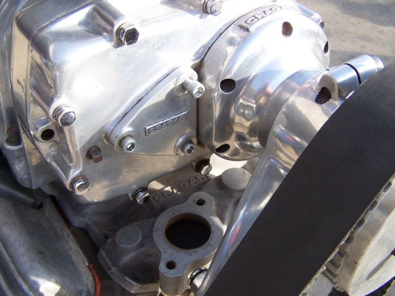

    NIce score Bonesy...looked awfully familiar. Snapped this shot in the parking lot of the Nugget, Bonneville 2009.

    That snout is AWESOME!!! It's a Cragar too right? I mean I don't like the ones like they sell on Ebay that have no character.. I like ones like that or ones with ribs or you know something with some soul. Guess I'll start looking for a hub and some lower v-belt pully's. Thanks for the info again guys.

  8. Well, I'd say the snout on bonesy's blower looks cast with that rib in it. Awesome set up for sure.

    As flamedabone said, I would buy the other stuff first and then measure for the snout. I think as you can see in the pictures bonesy's snout is longer than mine (damn I hated to say that):confused:.
