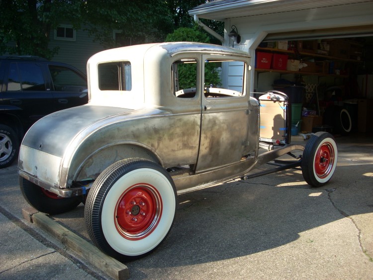

    I have actually been working on it a LOT.... I've pinched the frame 5'' at the front crossmember, finished splitting the front bones, switched from a dropped front axle to a '32 heavy..... Then I decided to go spring behind, and I've been working that for the last few days. For the spring I used a reversed eye that was laying around, and the rest of the leaves came from an F1 spring. I made a spacer from 1/2'' flat stock that I drilled and tapped to replace the nut on the bottom of the spring...... The frontend is finally mounted for real!
    The next thing on the chassis is a little bit of finish welding, motor mounts, and then shorten the torque tube...... Oh yeah and I found a guy locally to machine my flathead...... And found he's done a bunch of flattys for Don Orosco(who restored my favorite ever hot rod, the Pierson Bros '34 coupe!)
    Oh and I bought tires!!! 550-16s and 750-16s and my '35 ford wires are at the sandblaster's!!!!
    front crossmember
    '32 heavy mockup
    full frontend mockup
    late night brainstorm
    new shop.....
  20. Some more!
    I can't wait to get the new tires on this thing.... I'm pretty happy with the stance as it is, but with those tall rear tires and shorter fronts its only gonna get sweeter!

    Dang, man! You're making me look bad. That frame looks GREAT.

  23. Man that frame is cool, can't wait to see it with its new shoes on!
