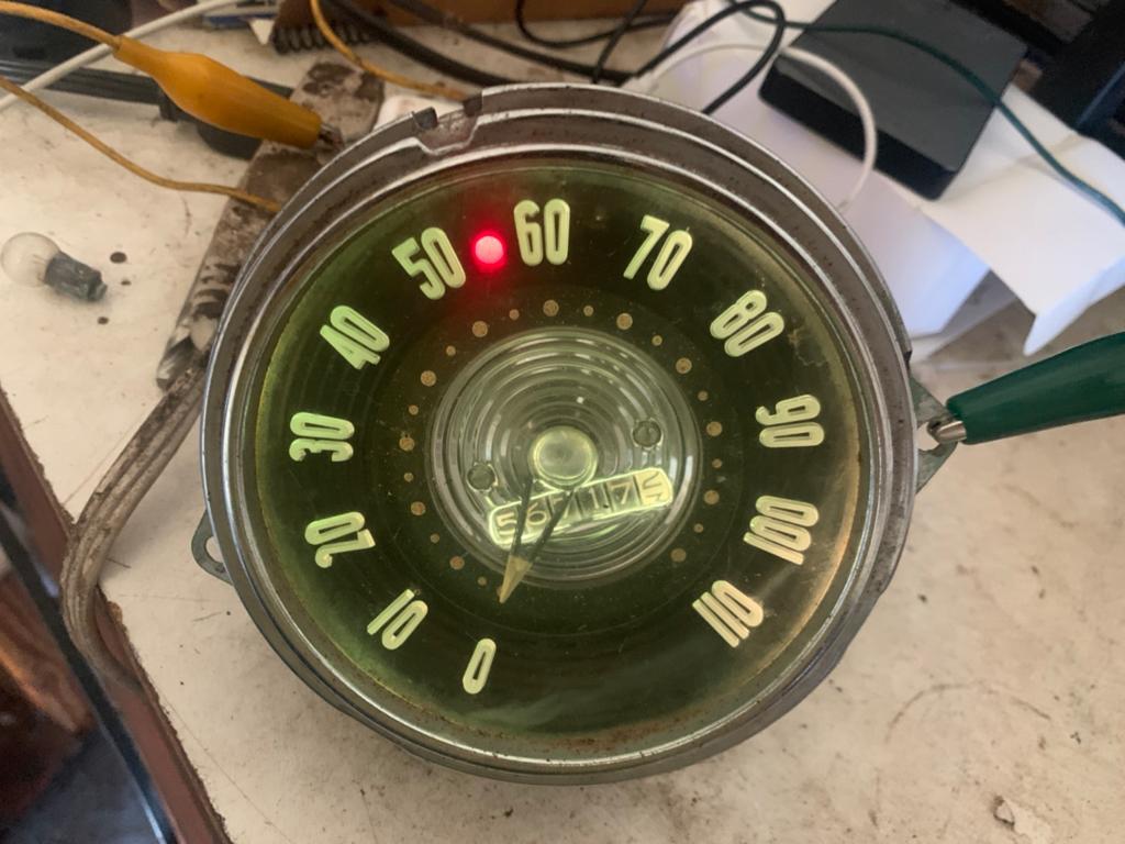

    Not much to show, but here’s another little update.
    It’s ugly as they come, but I made a support bracket for the brake assembly. Next time it comes out, maybe I’ll take the time to grind on it and smooth it out.
    It does the job at least, and really well. The whole assembly is very firm.
    I ordered brake lines last week from Amazon and they never came in. I’ll order new ones again and start running new lines. Once the brake lines are done, it’ll be time to put in a new clutch and throw the engine back in.
    The column shifter was complete frozen together, so I took it apart and freed it up. Works great now. Also got the parking brake freed up.
    Finally threw away the shot-to-hell door panels that came with the car. I decided to save the trim from them. No idea if they hold any value, but it would be cool to use them again. Threw them on the wall for safe keeping.
    And finally, I played with the gauge cluster and lit it up just for fun. Sure looks cool.
