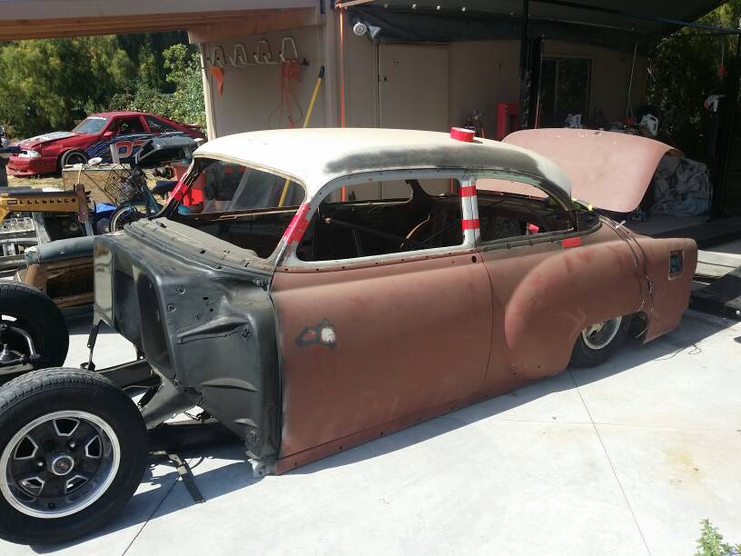

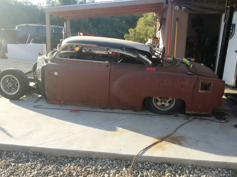

  1. So I guess I've been posting in the wrong spot and nobody gets to see haha I'll kinda work a little backwards and show you where we are as of yesterday and go from there. This is my first oldie to build, my background with cars is mainly offroad suspensions and roll cages.
  2. Heres where yesterday started, I got off early to come home and work on the beast
    50 customcoupe likes this.
  3. Gave her a haircut and put the lid back on

  6. Got the passenger side B pillar tacked in. Gotta give you guys credit that was not easy to line up
  7. Here we go

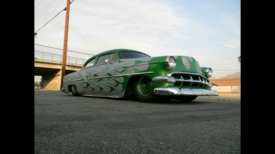

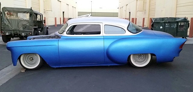

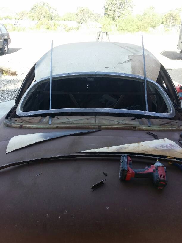

  22. Started playing with the back window last night. Not sure I like the shoebox rear glass as an option. I would like something not as tall and bubbly. The flow on the sides are kinda bothering me. Any opinions?
  23. twenty gallons
    Joined: Jun 7, 2010
    Posts: 443
    twenty gallons
    lower that window down to the beltline and see what it looks like.
  24. I tried that and the roundness of the frame is to much for the shape. I found a 49-52 Chevy rear that I think will work way better.
  25. Heres the 49-52 Chevy glass I like the flow so much better

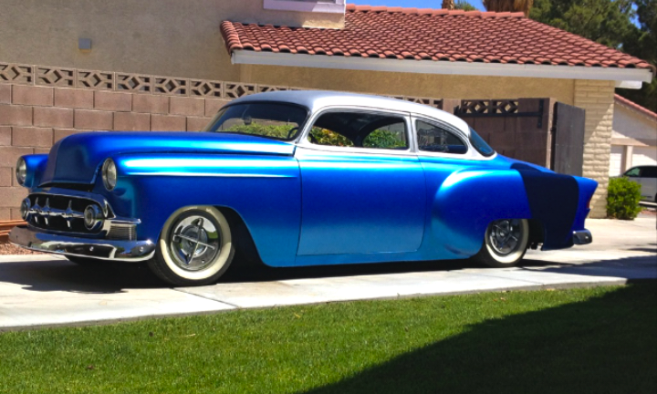

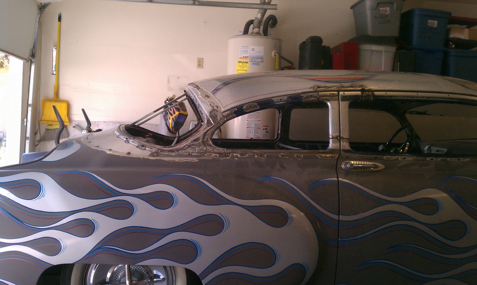

    securedownload-1.jpeg This is what I did to my daughters 53 a couple years ago, worst part of it was hand hammering the transition from the beltline to the new under window beltline, right there at the bottom of the rear window and then making little corner pieces to round the top corner of the opening, Stock rear window. we did make little turn downs for the rain gutter also.

  27. That turned out awesome! Looks really clean
