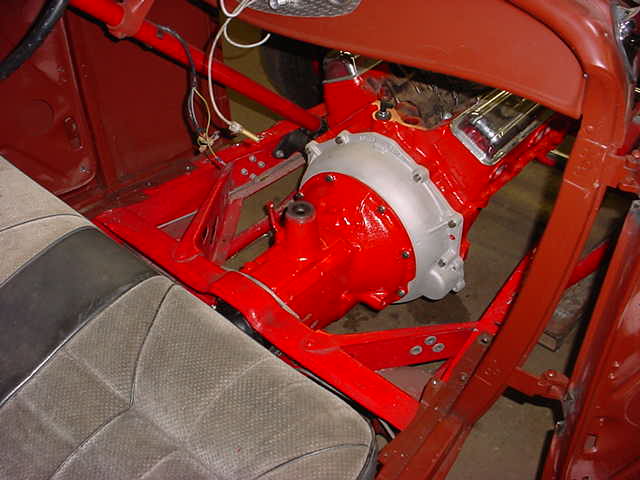

    im gonna get the roadster going for Tuck's motorama so ive been working on it again, should have it driving there if it all works out, got the motor and trans cleaned and painted, got the hole clutch assembly all figured out and bolted in, its an old speed gems adaptor and i think its got a ford truck clutch disc and a small gm pressure plate, im not sure i had the stuff laying around and it all fit together!
    the firewall should be painted white as if this moment, and my sisters boyfriend is going to come over tomorrow and were gonna pull the body off and jam it, the car wont be painted for the show but what can you do, we just want to jam it so when its on the car we dont have to take it off again.
    gonna try and get it close to running tonight, been paint pullys and brakets and am going to ge the tripower intake bolted on tonight also, and on and on!

    body back on the chassis, we basically jambed it, now the body is back on and im fittin the doors and trunk like, then well put the doors and decklid off tape off the inside of the car and paint all the exterior, im not a painter at all, my sisters boyfriend Jay has been helping me a ton on this project.
    i got a bunch of other piddly crap done too, got the pedals done, starter on e-brake and some other trinkety shit, gonna try and get the brakes done tomorrow and some of the wireing done.
