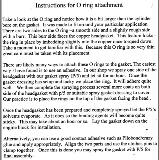

    Does anyone have experience using the "Flat Ring" which is approximately .005" thick in place of using an O-Ring ?

    For candy man......

    One line in there puzzled me: "Our practice is to place the ring on the top of the gasket facing the head."
    I thought the 0-rings seated in grooves in the block, mainly because the bore offers a reference for the groove, whereas the combustion chamber in the head could be any shape?

    I think they are talking about the 'flat ring' Neil asked about.
    It sounds as if there is no receiver goove on the heads?
