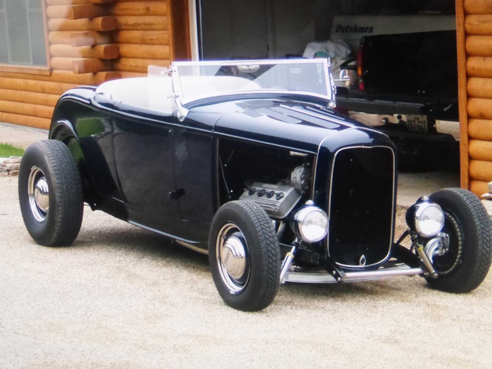

    I've only seen it a few times since 1996. But it is a classic hot rod in my mind.

    One of the famous roadsters from Texas in my mind.

    Set of bias, Absolute Perfection!
    It was 1996...

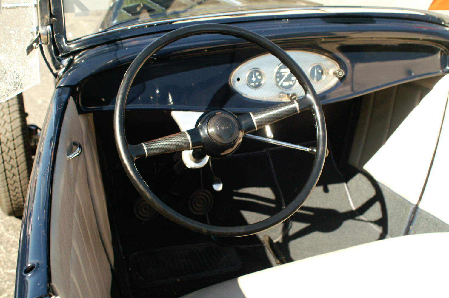

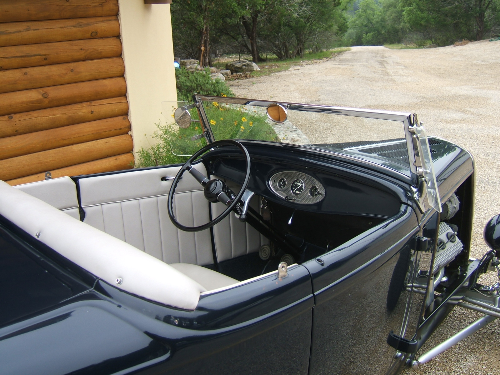

    I knew Dick Smith when I lived in Phoenix. The car was built with a nod to Smith’s car. It has a 40 column shift like Smith’s except he had the lever on the left for dating his wife to be.

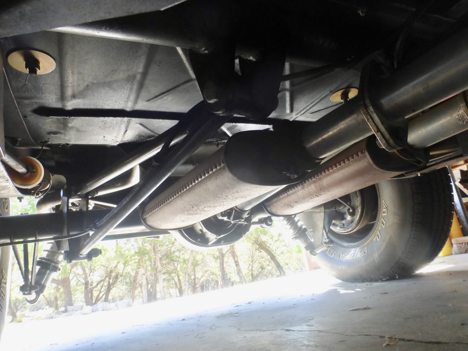

    I would like to share some of the odd stuff on the chasis.
    The K member is stock but I added a torque box and legs to stiffen the chassis. It is very stiff now compaired to before. No cowl shake and the doors open even on very unequal ground. It bolts in to stock holes.
    I had to make a special pedal braket because of the shift levers being in the way The pedals are modified 40 stuff. The Ford throwout bearing fork was bent so it works with the Chevy throwout bearing. The trans is a 57 Chevy
    The rear suspension eleminates body roll from engine torque plus gives equal loading of the tires. The axle housing wind up puts an up load on the pass side with a torque arm which keeps the body level plus it pushes down on the right tire to equal the loads. No need for a posi or a spool. Equal traction. Rear spring rate is 115
    The front suspension features a fiberglass spring. That is how I got the front so low wihout cutting the frame. It is W shaped under load. Front spring rate is 140.
    It also has a rear anti-roll bar. I use it to tune the car so it does not have so much under-steer. Every time I get new tires I have to change the bar.
