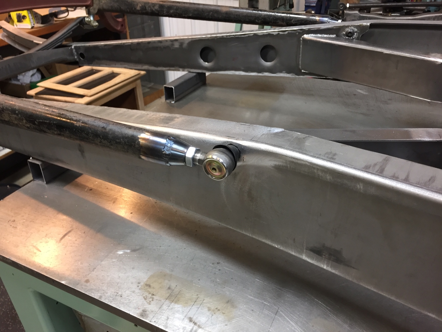

  10. Roadsir
    Joined: Jun 3, 2006
    Posts: 4,018
    Roadsir
    I keep getting a few hours here and there.
    Yesterday I got the 9" rear torn apart and mostly degreased. I need to whack a few brackets off and get it blasted.
    Today I got the bones cut to length, bungs welded in, and used the Horton through frame bungs that allow a pretty clean installation of the tie rod end.

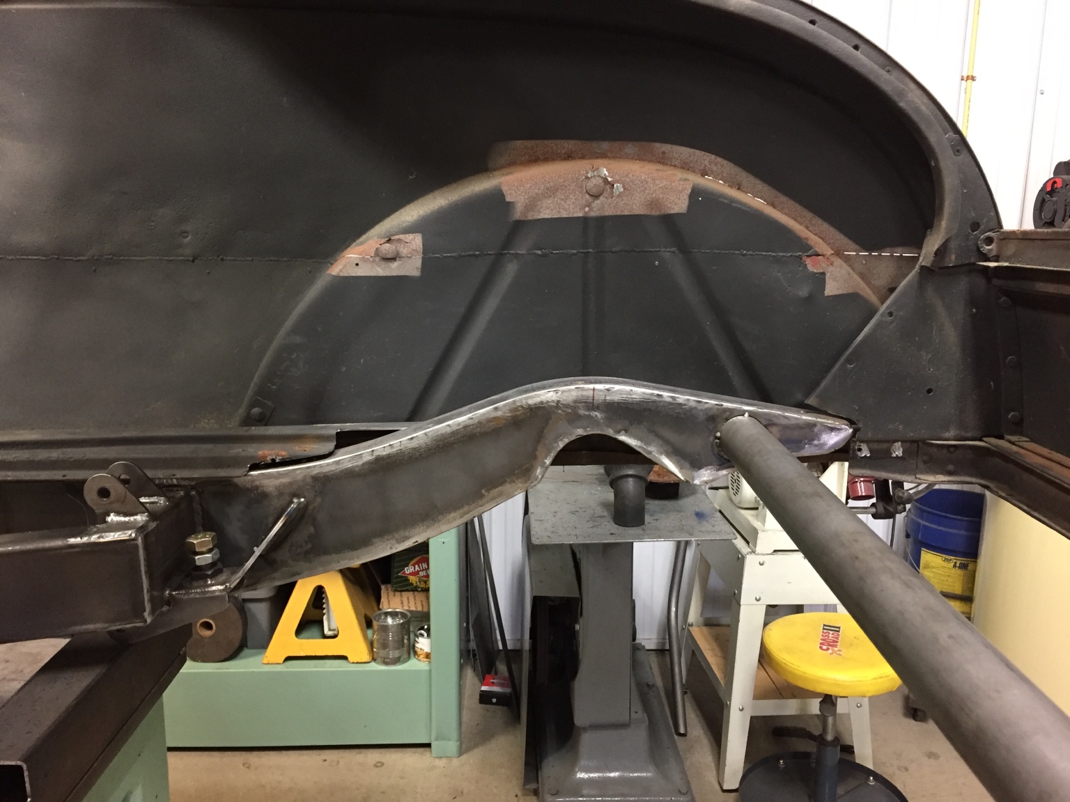

  28. Roadsir
    Joined: Jun 3, 2006
    Posts: 4,018
    Roadsir
    Decided not to hit a swap meet today, and not play with cycle carts, and get the body sitting on the frame. It will need a little taper cut at the cowl, but here are a few shots of where I'm at.
