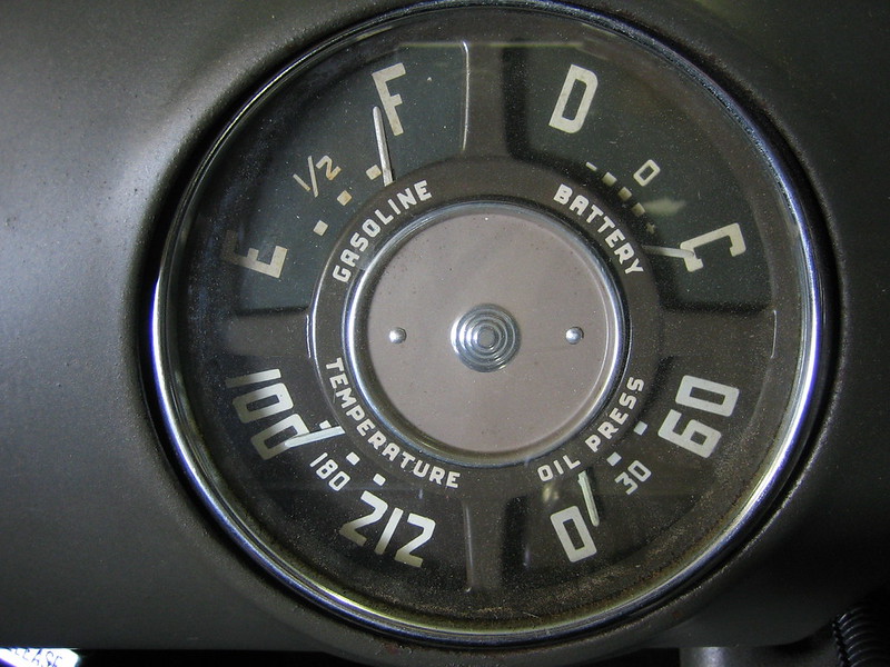

    I managed to free the ammeter needle without doing any further damage. I did some experimentation which indicated that the Chevy ammeter goes full scale at just on 40A. So I made up this current shunt which is wired in parallel to the ammeter. The shunt array has 3 x 1 Ohm 100W resistors which are themselves wired in parallel. So the shunt presents 1/3 Ohm resistance and has 300W power capacity. The effect of the shunt is to roughly halve the current that goes through the ammeter, so now its FSD (Full Scale Deflection) is 80A
    BTW, the chunk of PCB at the top of the Aluminium heat sink is doing something else on my truck -but power resistors do need to be mounted on a heat sink of some sort.
    Here is a Current Shunt that I made up to work with an early Brit car ammeter which has a 20A max reading. The owner had installed 40A alternator. This one has 2 x 1.3 Ohm 100W resistors wired in parallel; this increases the FSD to about 45A. (Lucas moving coil style ammeter.)
    There are four apparent connections on this one because the two connections are twinned. This allowed all the car's wiring connections to be made on the shunt. The heavy orange and brown wires disappearing to the left of the photo are the only ammeter connections.
