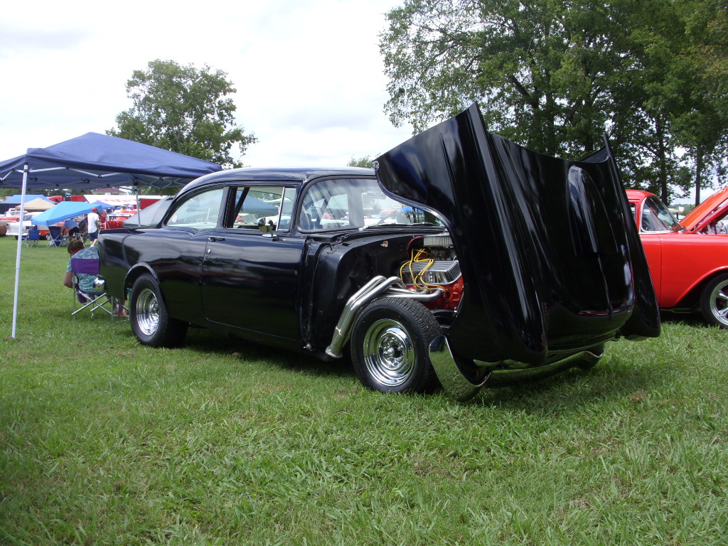

    after a long 2 years of working on it I finial finished it.

    It seemed like installing the big block with fender well headers gave me the most trouble. Everything had to be in almost the stock location to get the headers to clear the stearing box. I had to raise the motor for the headers to clear the box and still have the clutch z bar in stock place. I had to use raingear wipers under the dash because distributor was raised and original would not fit. All it likes to be finished is installing new steering box if Jegs ever sends it to me. Its been on backorder for around 6 weeks

    it took a little work to get everything to work together

    not the best picture but I do have the skull

    it got a lot of looks at the tri5 nationals last august
