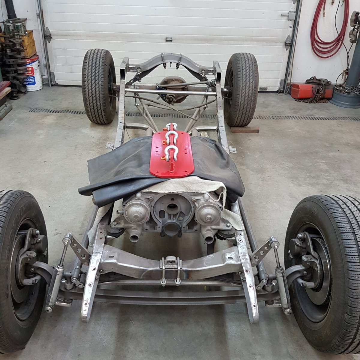

  27. akoutlaw
    Joined: May 13, 2010
    Posts: 1,265
    akoutlaw
    Here's the one that I made.
    teach'm, JUNK ROD, VANDENPLAS and 2 others like this.
