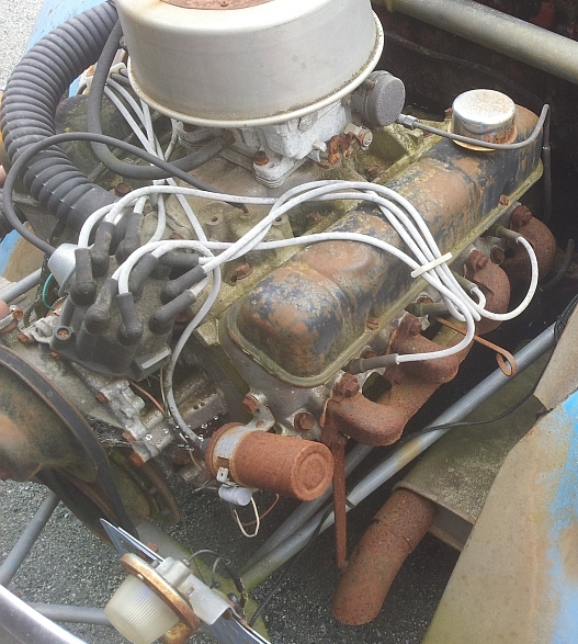

    I am looking to purchase this old moth balled project. Its powered by a Buick 215 V8. This motor has been sitting outside exposed to the California elements for around 15 years, it is close to the coast and has had some salt fog hanging around causing surface rust. It was parked full of anti freeze years ago. The dipstick shows no water in the pan.
    Being an aluminum motor are there other types of issues different then a iron block I should be concerned about and looking for? Can I treat this like a typical "long time sitter" and fill it with diesel for a few days to loosen everything up?
    Thanks for your reply, appreciate it.

    Thanks for the replies. Corrosion of the aluminum is what Im concerned with also and wondered if there was a way to check for damage while inspecting the motor prior to purchasing it?

    Corrosion was a problem on those engines for 2 reasons, OK maybe 3.
    1) The antifreeze they made in the sixties was corrosive to aluminum. They added corrosion inhibitors but they wore out in 2 or 3 years. If you did not change antifreeze regularly they would corrode inside.
    This changes some time in the late 70s or early 80s. I noticed in the 90s you could take apart a neglected old aluminum engine from the early 80s and the inside was pristine. Since then I have never seen an engine with bad internal corrosion. They must have changed the antifreeze to a non corrosive chemical when aluminum engines became popular.
    2) Filling them with water. A lot of old timers did not use antifreeze or used it only in winter. This was fine on their flathead Hupmobile but not on an aluminum engine. So old aluminum engines ended up corroded.
    3) Cast aluminum is not as dense as pressure die cast. The Olds and Buick blocks were pressure die cast but the heads I think were sand cast.
    If you wanted to be real careful you could take the heads off and inspect for corrosion. That was the downfall of these engines, corrosion in the coolant passages that ate away the head sealing surface until the head gasket failed. Or, you could be sneaky, take off the water neck and look inside. If the inside of the coolant passages looks clean you should be OK.
    If the coolant passages in the head are corroded they can be welded up. Or if the engine is junk all is not lost, Rovers used the same engine for years.

    Rusty O'Toole, that was the answer I was looking for thank you for your time on that. The gearhead/builder that owns it says he was aware of the issue and made sure the antifeeze was right. He parked it 15 years ago so that (with my feeble math skills) puts a park date of 1997 on it, should be ok but I will take your advice and pull the water neck off and take a peek before pulling out my wallet on this project.

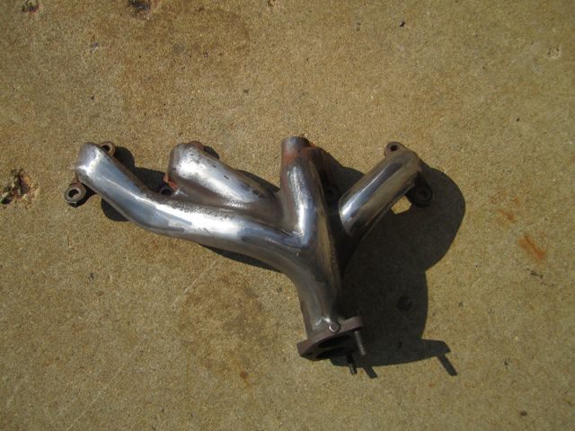

    Just finished building up a '63 Buick 215 for my "A" coupe. I'm running a set of reworked 300 heads, vintage Kenny Bell cam, and back it up with a t5 and Jag rear (3:31). For headers I am running two left hand mid '80's Rover cast 4 into 2 Discovery headers. They look pretty decent plus they tuck in within a half inch on the block. Not only that they are cheap as dirt on Eplay. (photos to follow) For now I'm going to run the a reworked QJ4 on the stock four barrel manifold and a mid 70"s HEI.

    Here are some pics of the Rover cast headers. The block is a dummy block for setup.
