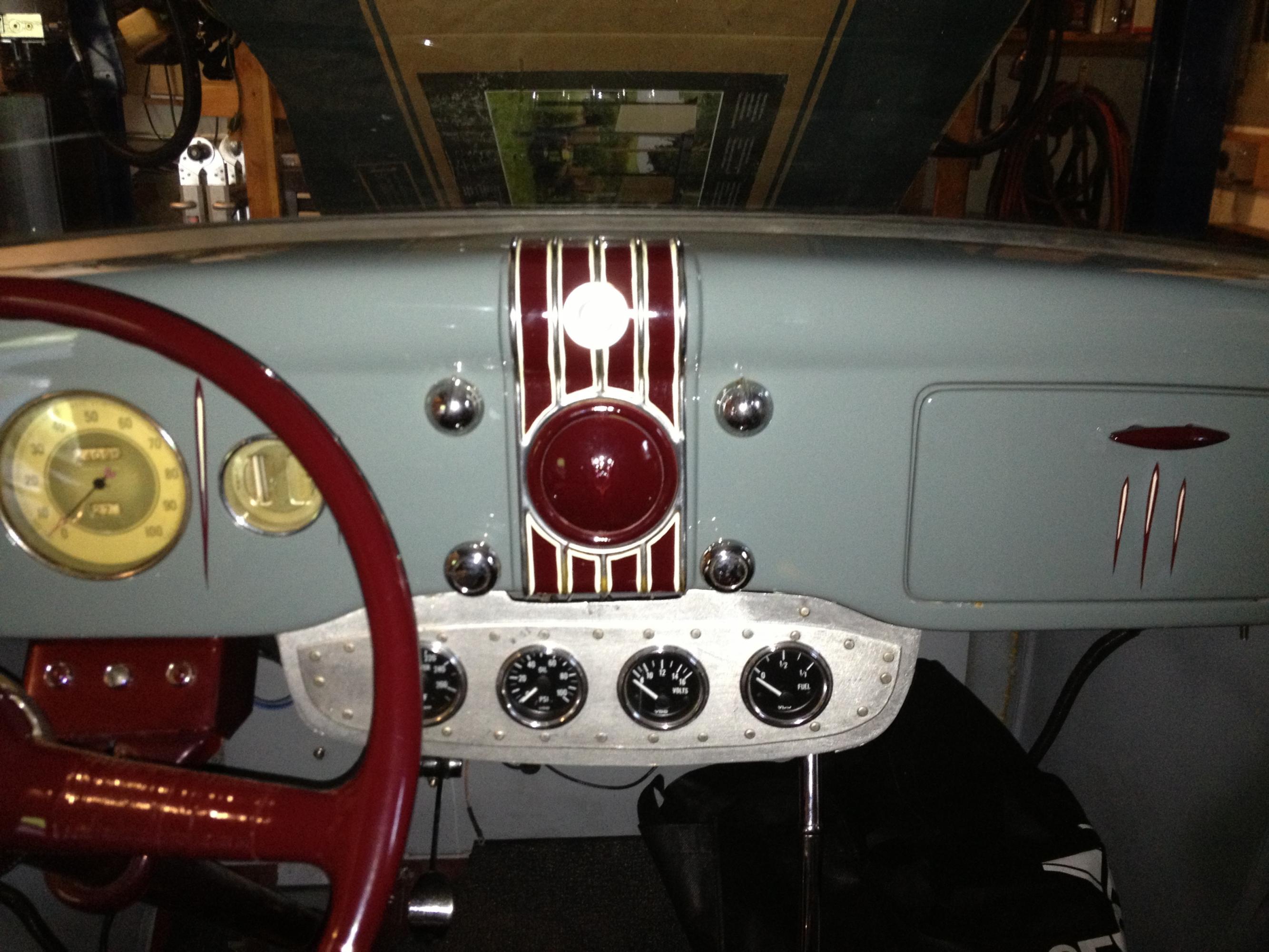

    I'm almost embarrassed to post this because of the awesome work posted by others, but here's a gauge panel I whipped up this weekend....yeah, I like rivets...

    I'm making sure to install 1/4" closed cell weatherstripping foam tape between the skin and the body metal. I don't want any rattles or oil-canning noises.
