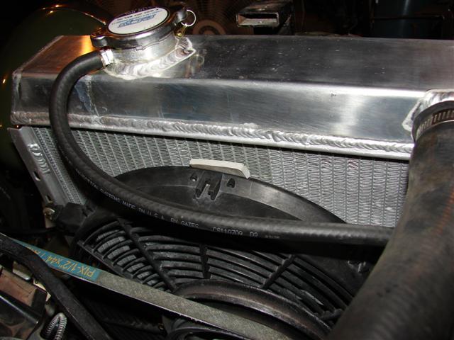

    Hmmm. Lots of good points. You need to know how hot it's running before diving off the deep end, but, in general, the stock Mustang radiator is hard pressed to keep up with a 289 2bbl, let alone a blown performance engine.
    I had a stock aftermarket copper/brass '65 'Stang radiator in my '36 with a mildly massaged Cad 472, and it was totally undriveable. If you're interested in the gory details, I have lots of posts about this, but I'll cut to the chase and say that the addition of one of those ebay purchased, 2 row aluminum, 200 dollar Oriental replacements was the ticket. The car NEVER runs over 200, even idling in 90 degree temps.
    The core is 3/4" thicker, the tubes are closer together, supposedly increases capacity 30%. The quality looks good, the appearance is great, one year warranty. Mine has welded tanks, look for one that the filler is NOT recessed into the upper tank.
    For $200, I'm impressed, and can drive my car without worry. Do it. The guy I bought mine from is from Chicago. I ordered it at 5 pm, it was on my doorstep at 3 pm the next day. Best thing I did for the money to the car, hands down.
