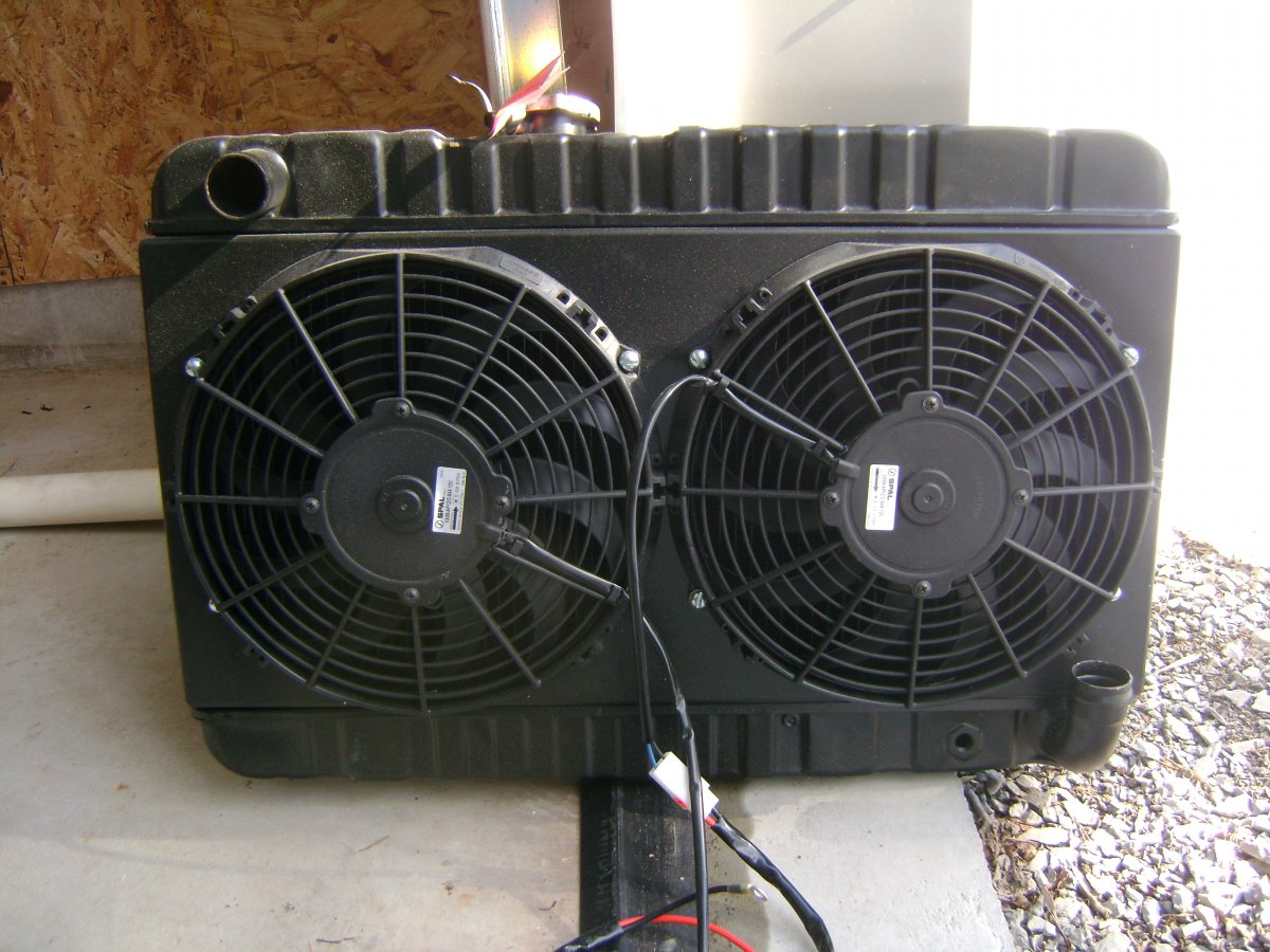

    rad.jpg Last winter I took the leaking original rad out of my 40 Ford to my go to rad guy. He said he thought he could fix it. A few days later he called and said he'd misspoken. It could be repaired but it'd be about 600 to 700 dollars. I don't have that kind of jack so I ordered a Champion aluminum rad from Bob Drake. It works great and while I guess it's not trad I like the way it looks. I really wanted to polish the upper tank on the original rad but it wasn't worth 700 bucks to me.
