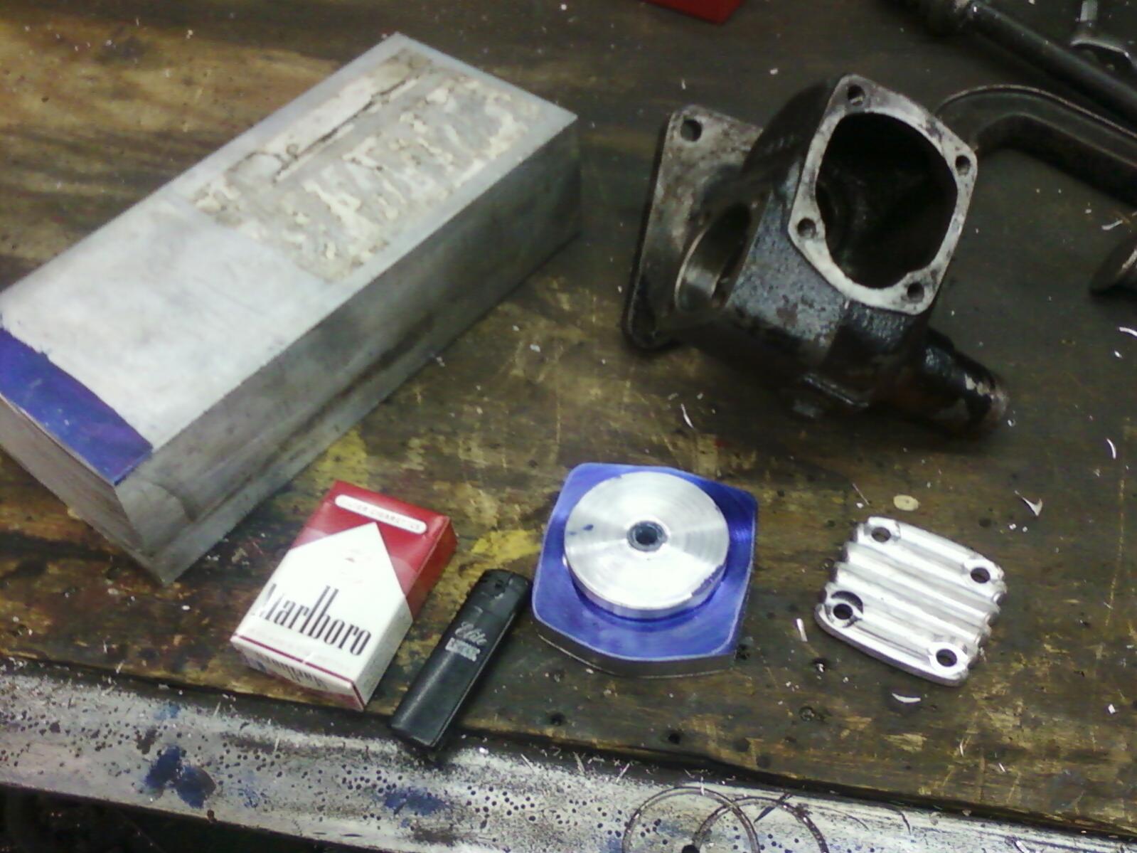

    once again i have gone way to far.
    hated the look of how i had to mount the steering box to my 2x3 frame and did not feel like welding all kinds of tabs to mount it nice. also figured while i was at it i could use some roller bearings on the pitman arm shaft.
    it uses all stock f-100 parts except the pitman arm bushings. also set it up to use orings to keep it from leaking like a stock one.
    all the machine work was done on a bench top mill and little 9x20 lathe.
    still have more shaping to do on the out side but i have assembled it and tested it out. it turns so easy and smooth it feels like i have power steering.

    little too much work for me to make them to sell.

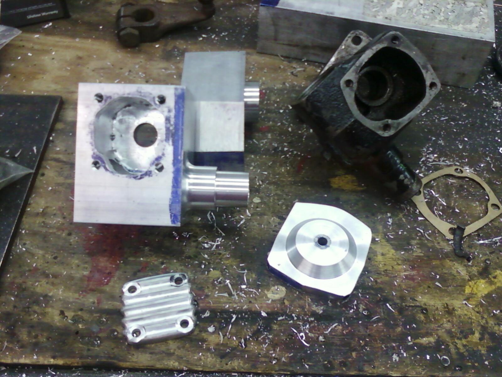

    it does get a third bolt on the bottom of the box to the inside of the frame rail. just been holding off on welding that tab on till i get most of the shape right.
    as much as i can shape it in the mill or lathe there will be a ton of hand shape done with a file.
    the weight is just about half of a stock one even with making it twice as thick.

    there will also be a huge weight saving when i counter bore the pitman arm shaftout to 5/8 or 3/4 about 2.5 inches deep.
    also have some 1.25 7075 im thinking of making the pitman arm out of.

    i found it at the scrap yard it still had the lettering on it stating 6061
    paid $1 per pound for it. started as 3x5x24 cost was $38.00

    on the 56 box the pitman arm ony has a few splines at the bottom. figure i could make a grooving tool and do it in the lathe with the spindle locked.

    started on the pitman arm. well atleast making a test part to see if i can get the splines right.
    there is an 1.25 bore but on the bottom the splines stick into the bore about 1/8"

    Box all welded together. Test asembled it works so smooth with the roller bearings on the pitman arm shaft. I hope i did not make it to easy
