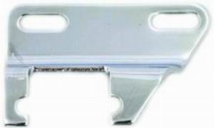

    I have brackets for ram horn mounting but have switched to headers. Can I some how use those to mount with headers? The lower bracket used to bolt to the Ram Horn but now those are gone. I am just trying to figure out what I need now to mount the altenator.

    There are several brackets that mount to the Header bolts. Depending on what car you have and what else is in the way, is there a spot where it would work better for you?
    On one of my rigs I used a stamped smog pump bracket from a late 60's early 70's small block. I think I still have a cast one out in the shed. It bolts to the right side of the intake and sets the alternator right up between the thermostat housing and the right valve cover. The only issue I had was lack of adjustment on the belt. It really needed and Idler on the belt to get it tight.
    There are lots of low mount brackets if you want to put it down on the drivers side low and if you don't have power steering.
    Pieces like these two and your stock top bracket will let you mount it on the header bolts. http://www.speedwaymotors.com/Alternator-Base-Brackets,7769.html
    This is a slicker shiner version of the smog pump bracket I mentioned earlier http://www.speedwaymotors.com/Small-Block-Chevy-Upper-Alternator-Brackets,3458.html

    What water pump do you have short or long? I bought the passenger mount from so cal and made it work for my short pump, They said it was for the long, really if I didnt have the front fill tube It would have been fine. I made a spacer for the adjuster bracket to push it out a little. Its pretty cheap or you can get the one from the welder series site (short pump) its even cheaper. I have had no luck with those chrome brackets posted above ever. They always cracked on me.

    Just got a set from Jegs, works pretty good with the curved, over the top tension bar.

    Looks like you have a short water pump, which limits your choices... BUT, at least you have mounting holes in your heads. There are a few out there that will work. A lot of the choices that look real "street rod"...
    I have a short water pump and double hump heads (no mounting holes), so my choices are next to none...
