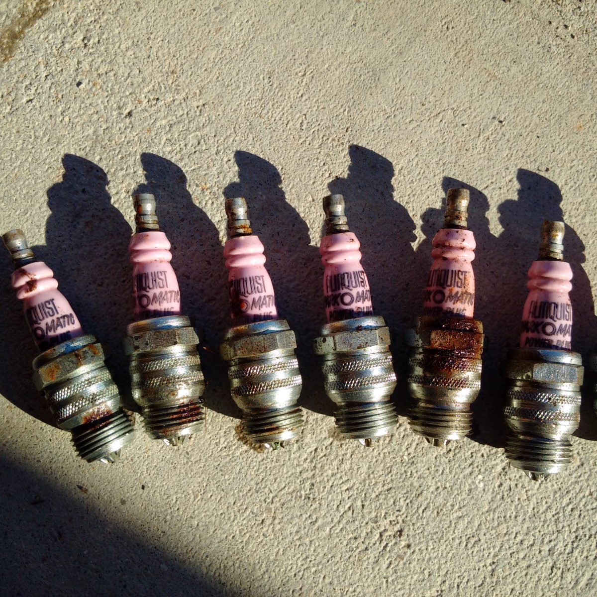

    Been looking in a few old boxes and found these nos plugs anyone no the age 50s?60? Also the are a few surface rust spots. What's best way to clean up with out messing them up ? IMG_20160919_171345.jpg

    I seen these in the early 50s. 1950 to 1953. Except they were called Americal Eagel. Looked the same.

    They say Spark o Matic on them.
    We're the two companies connected. Spark o Matic started in Milford PA in 1953 and Almquist was one town over

    To clean the porcelain and slight rust on the steel, I would first try a cutting compound, the plug with rusty area and all the thread grooves might need a quick hit on the wire wheel

    +1 I would put them on a buffer with some compound and a very soft wheel/pad. I clean up chrome parts that have surface rust sometimes.

    Try a copper scrubbing pad and Pledge.

    The first thing I would use for the rust problem would be "EvapoRust" or an equivalent. It is death on rust but doesn't harm anything else. Only if it didn't work (doubtful), would I resort to harsher methods.
    X2

    2nd on Evaporust. The trade name is accurate and says it all.

    Thry toothpaste on the porcelain
