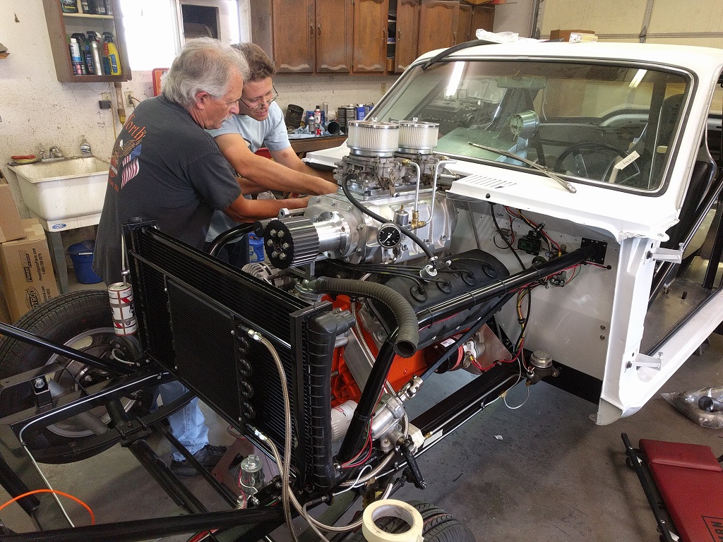

    Looks like you got some great help from the younger generation over the weekend. That's priceless and makes the whole thing worthwhile. Building a great car with great people. Cherish that time.

    yup, great help! Dan ( my co pilot on Drag Week) has been over putting in some hours, too.

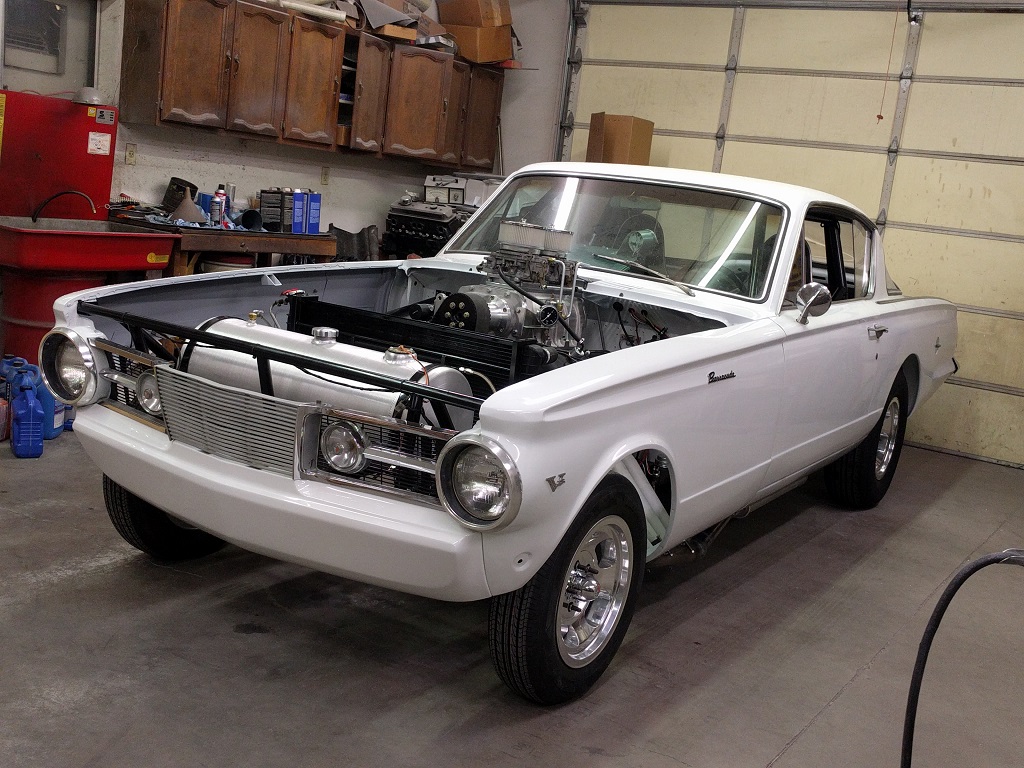

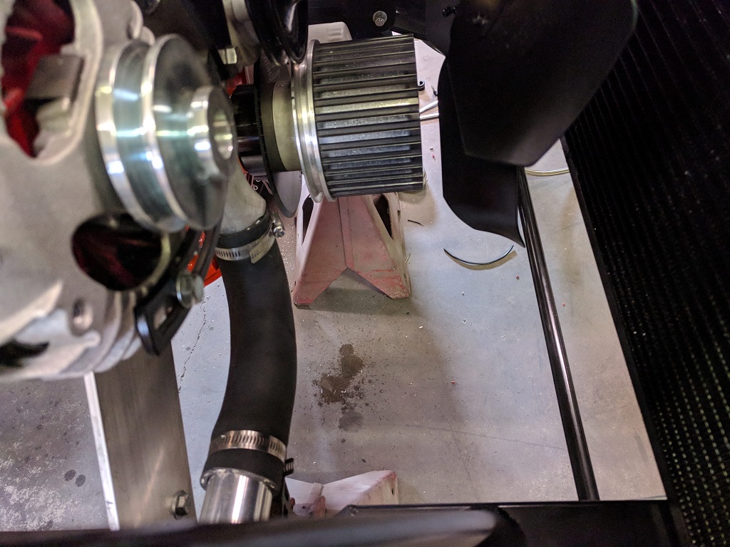

    Started filling it with water, found the first leak....I guess that's progress!

    The water pump leaked, we fixed it. Starter motor works at least a little bit, one tail light works, the horn works, the gas gauge does not work. It holds water now, but haven't put in gas yet. Still have to get one collector connected it's muffler, I want it to be kind of quiet when I fire it the first time.
    maybe in a few hours it'll make some racket, we'll see.

    well, sorry, no video, but it fired up and ran. Letting it cool off, then check some stuff, and run it a bit longer.
