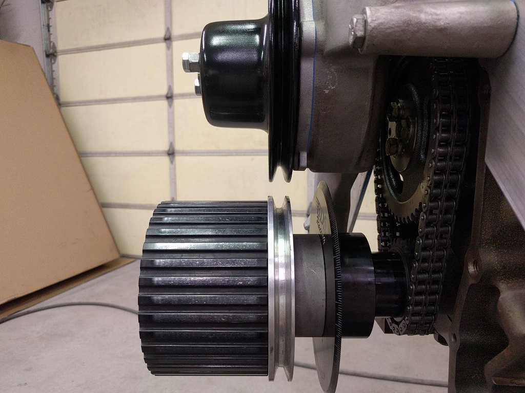

    my replacement crankshaft showed up yesterday, and it seems to be the right one. So I'm back at work on the engine, making things fit. I have the crank in the block, and the hub on, so I can get the blower drive finalized, hopefully. Oddly, the water pump pulley aligns with the crank pulley using a 1" spacer I already had. And the upper blower pulley seems to be real close to lining up (there's 1/2" extra width on the pulleys, so it's not critical that it be perfectly aligned). I put a piston in a hole, and the deck height looks right. The bearings feel right, although I still need to check oil clearance. And I think the oil pan and pickup and windage tray will all work, I had to do a little massaging to get them to all work together.
    Still so many things to check, I should have heads back in the next day or two, although the valve job won't be completely finished yet. I have to check valve to piston clearance, and get the valvetrain assembled enough to figure out the pushrod length, and hopefully get pushrods made in time.
    Lots more work to do, I have to be on the road in two weeks, and there's a holiday weekend coming up, to speed things along :)

  21. Manton offers adjustable push rods to get the correct length. They have a jam nut to lock the adjuster in place. They get sent in and they make pushrods to match. The kit is around 35 dollars. They work great.
  22. RichFox
    Joined: Dec 3, 2006
    Posts: 9,968
    RichFox
    I made my own. I am cheap and so were they.
    SR100, egads, loudbang and 1 other person like this.
  23. squirrel
    Joined: Sep 23, 2004
    Posts: 47,191
    squirrel
    I have the Manton checking pushrods.. I'm a little confused about where to set the adjuster on the rocker arm, for one thing.
    But it is fun to watch the pretty parts move when I turn the crank.
  24. 1 to 2 threads showing on the adjuster. When ordering talk to Al. You need to also provide the size of the adjuster screw ball and the size for the lifter. I highly recommend the tool steel screws and cups. If the cups get smoked they can replace them. I would get stock outside diameter so there are no interference issues with the head or gasket. They can be made with a thicker wall for added strength. Al will get you set up.
