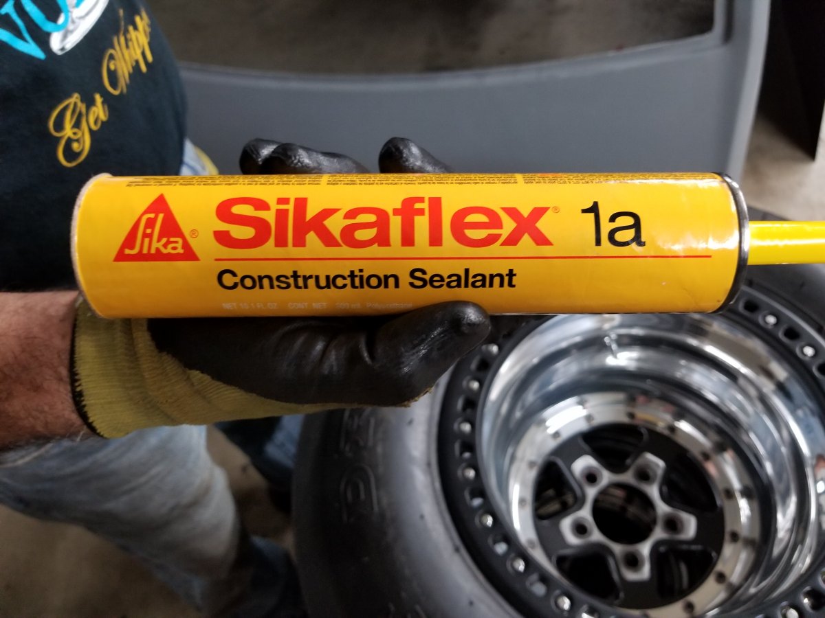

  5. You know every Tuesday I have lunch at a chassis shop, he uses this stuff to bond metal to fiberglass, when used with aluminum the aluminum will tear before the bond will give up.
  6. DDDenny
    Posts: 19,258
    Curious why he uses a sealant rather than an adhesive?
  7. Dick Stevens
    Joined: Aug 7, 2012
    Posts: 3,716
    Dick Stevens
    Sikaflex may be listed as a sealant but it is a great adhesive! It was used where I worked and it holds great!

  10. Because it works !
    Some of his cars go over 200 mph and he has never had a problem with separation.

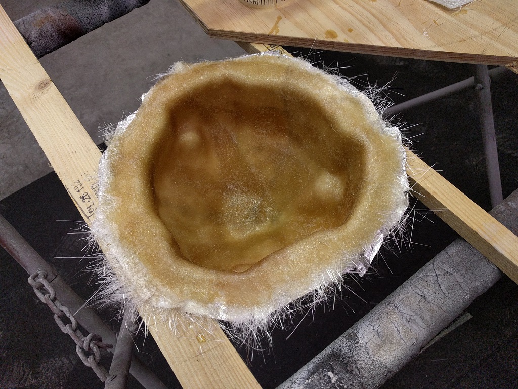

  30. squirrel
    Joined: Sep 23, 2004
    Posts: 56,073
    squirrel
    I'm not too worried about the car coming apart...at least, not those parts!
    I started playing with fiberglass. Making fiberglass parts, that is. First is a headlight bucket. I have 3 steel ones to play with, they are the same part on left and right side of the car. The steel bucket weighs 1.6 lbs, and is spot welded to the fender. Since I'm making 'glass fenders, I decided to cut the buckets out (drill the spot welds), and make them as separate parts. I decided to try to make the bucket as a male part, using the original steel part as a female mold. The new part will be too small, but that's ok, it should still work. I dont know if I'll be able to get the thing to separate, this is kind of an experiment--and I have a couple more to use, if I mess this one up. I sanded the inside of the bucket, and coated it with wax, and covered the holes and the flange with sticky aluminum tape. And sprayed some PVA in it. Then brushed in two coats of white gel coat, and layed up two layers of 1.5 oz mat. I ended up tearing the mat into strips, sort of, to get it to conform to the weird shape more easily. I expect I didn't get the flange area properly laid onto the mold, so it'll probably have air pockets and won't work, or will need some rework to be able to use it. If I can get it apart, that is! It will teach me a lot, at least.
