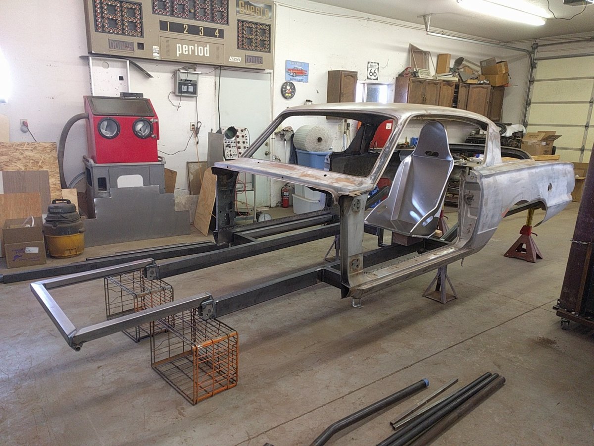

    I got to spend some time cleaning up the shop so I'd have all this room to work in...it was a mess, but after fixing up the old horse shed to store parts in, and spending a few days sorting and cleaning, it's nice again.
    I set the block on a dolly, so I could position it to get an idea of what the firewall situation is, etc.

  5. That is a great mental "connect the dots" project, and everyone gets to see it exactly like it "should" be in their mind right now. Can't wait to see how it looks inside your head!

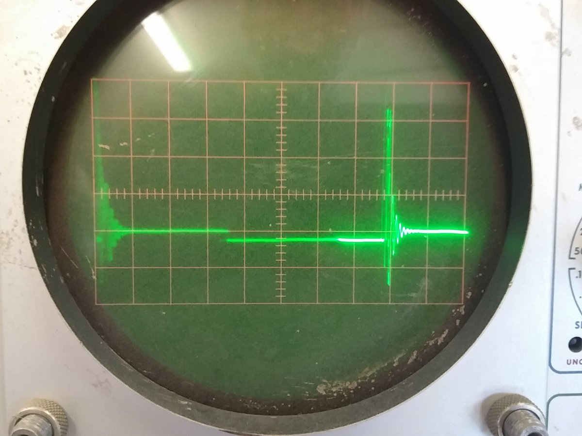

    I couldn't help but notice your Sun Engine Performance Tester in background. It looks a few years newer than mine and I have never been able to get the O-Scope to work on mine, just the hazey green screen. I know you are pretty good with electronics, is that something an old "Eniac" vintage tech with no real hands on for 30+ years should try and tackle?

    The Sun machine...got it in 1989, used it until about 15 years ago, the scope display died (it's basically a black/white TV display). I haven't bothered to try to fix it, they are kind of a pain to repair unless you have quite a bit of experience with them.
  11. I have had a lot of luck with the old machines by just replacing the electrolytic capacitors when I don't have a schematic.
    One of my hobbies is working on old tube type electronic equipment, and they are a lot easier to repair than the new surface mount stuff.
    I use an in circuit ESR tester to check the capacitors in circuit, and it often saves a lot of work pulling them all. It is amazing that as old as the electrolytic caps are, that most of them test great. I short them out before testing them, but I imagine the machine has been sitting long enough for it to have lost its charge.
    I have a good selection of tubes if you happen to need something.
    Just remember, that if you are going to power up the unit, to start with about 30 to 50 volts and increase slowly to allow the capacitors to re-form.

    It's from the 70s, so it is a solid state thing...
    I might mess with it one of these days, but it's pretty low on the priority list. I can use my Tek 535A scope if I really need to see a waveform on an old car :)
  13. Yeah, I hooked up my 2246 using some wire wrapped around the coil wire, to compare the waveform with my Precision auto scope. No big difference, but the Precision has other advantages plus portability because it is a 12 volt unit that is designed to work while the car is in operation.

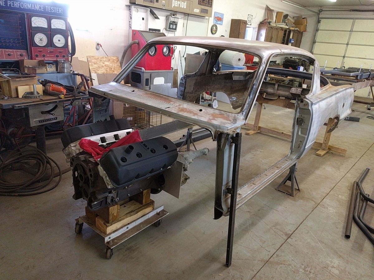

    are we having fun yet?

  24. Nostrebor
    Joined: Jun 25, 2014
    Posts: 1,282
    Nostrebor
    Milk crates... the Engineers have arrived!:D
    It's looking good man. Keep steppin'

  26. Fabber McGee
    Joined: Nov 22, 2013
    Posts: 1,287
    Fabber McGee
    Is the long front frame an illusion, or will the fenders be stretched a considerable amount, not just getting relocated wheel openings?
  27. squirrel
    Joined: Sep 23, 2004
    Posts: 56,077
    squirrel
    The fenders will be extended about 15 inches, as well as have the wheel opening moved 6 inches forward. And the rear wheel openings are 8 inches forward.

  29. GearheadsQCE
    Joined: Mar 23, 2011
    Posts: 3,402
    GearheadsQCE
    Alliance Vendor
    I like the way you incorporated the fish plates to serve as the rear spring mount. Did you use your mechanical CAD program for that?
  30. squirrel
    Posts: 56,077
    squirrel
    nope, I just sketched it on some scrap paper...
