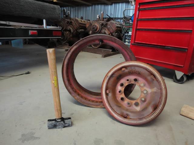

  10. LSGUN
    Joined: May 26, 2007
    Posts: 1,259
    LSGUN
    from TX
    I did a pair a few years back using Buick hoops and early Ford centers:

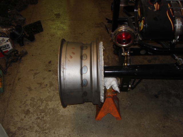

    1. Aussie HAMBers
    made these out of four wheel drive rims and customline centers for my OT wagon, trued them with a bar clamped to the leaf spring, idling in 1st

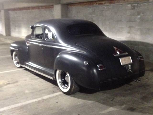

  13. Smokeybear
    Joined: Apr 20, 2011
    Posts: 319
    Smokeybear
    Did the rears of my 48 Plymouth. Cut the rivets out, then used 8" hoops from Speedway. I actually bolted them to the car and used a dial to true them. Here's an older pic. car2.jpg

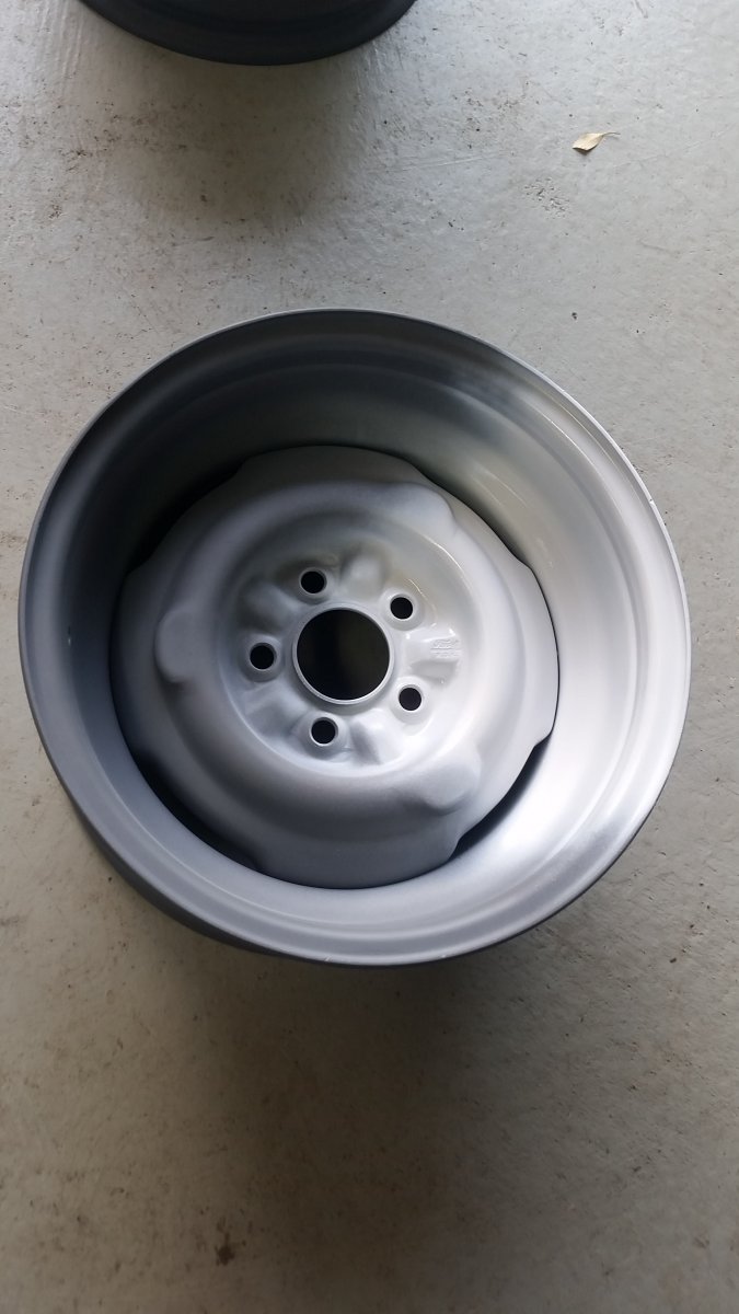

  18. Marty Strode
    Joined: Apr 28, 2011
    Posts: 4,268
    Marty Strode
    I did these a while back, picked up a couple of inches in offset. IMG_2809.JPG IMG_2956.JPG

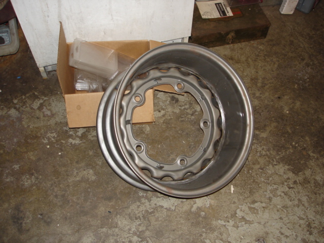

    I did these last week. I was told that the beading is different inside vs outside and the beauty rim may not work. I had no choice and had to reverse these, the beads looked the same anyway. 045.JPG 003.JPG

    No donor, the rim part is new 10" and the inner is Wide 5. To be honest I widened these wheels ages ago and felt the steel Ford used was too thin and they worried me, I drilled out the rivets and got the new outer rim part.
