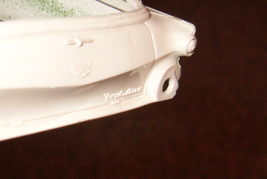

    A bit of trivia for the model builders. Air suspension was apparently supposed to be offered by Ford in '59 but was canceled; however the early promotional models of the station wagon produced by PMC had a Ford-Aire script on the tailgate:
    town sedan and s55mercury66 like this.
