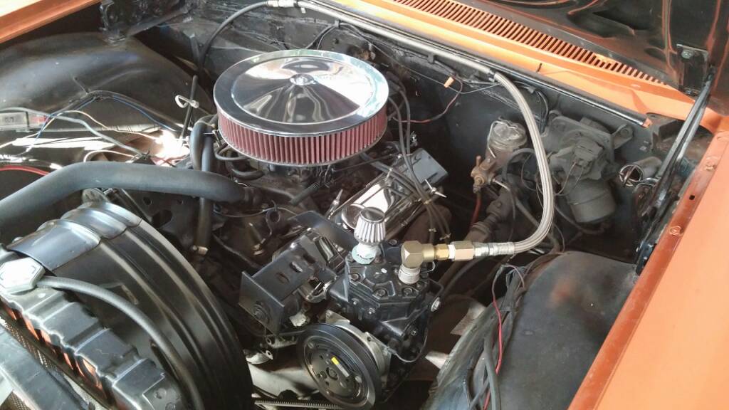

  24. Chuck-A-Burger Ryan
    Joined: Aug 20, 2006
    Posts: 511
    Chuck-A-Burger Ryan
    York 210 on my impala
    Post sent by carrier pigeon
  25. rocknrolldaddy
    Joined: Aug 24, 2006
    Posts: 336
    rocknrolldaddy
    Are you still running a tank, gauges, valves, censor, switches? or does it just keep the bags filled when it on and dumps when its not running? How does it work?
  26. bigpokie
    Joined: Oct 23, 2011
    Posts: 142
    bigpokie
    Yes you still need to run all of that. I assume that by "censor" you mean pressure switch ? If so, then yes. Some people run a separate one just for the edc but I don't think it's neccesary. It will always spin bravo use of the belt, but will only work when the clutch engages. You also need to build an unloaded to get rid of the pressure inside after it stops
