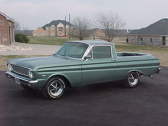

    They were probably Monroe Max-Air. I've had a set on my Falcon Ranchero for 311,000 miles now and they just started to leak. Guess it's time for new ones.

  7. That's a good looking Falcon. HRP
