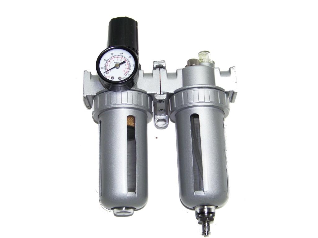

    Controlling water moister / humidity in the compressed air lines goes above just “not being lazy” and draining them everyday. In my shop we drain several times a day (plus use auto drains in areas as well). Just because your “visually” draining water out of your tank or lines doesn’t mean you have dry air. Dry air is crucially important for paint shops (such as myself)
    So in addition to the easy task of draining them we:
    ~First incorporate an aftercooler (think a condenser with an electric fan blowing across the fins)
    ~After that we have another drain in the line to drain the condensed water vapor after the fan cools off the warm lines from the compressors.
    ~From there we go into a pair of filters to trap any particulates, oils or contaminations (these also have drains)

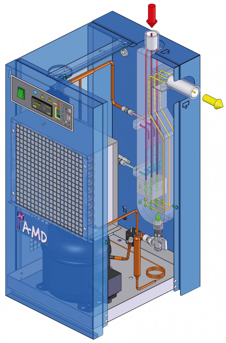

    ~Next we go into a refrigerated dryer (basically run the air through an A/C unit) this is a little further down from the compressors so it’s not dealing with hot air (again this has an auto drain)
    ~From there we are plumbed throughout the entire shop with “drops” in the air lines to physically give a low point drain in each station along with a last water separator/ water filter and drain.
    ~At the actual paint booth we have a pre drain followed by a 3 stage filter and desiccant system.

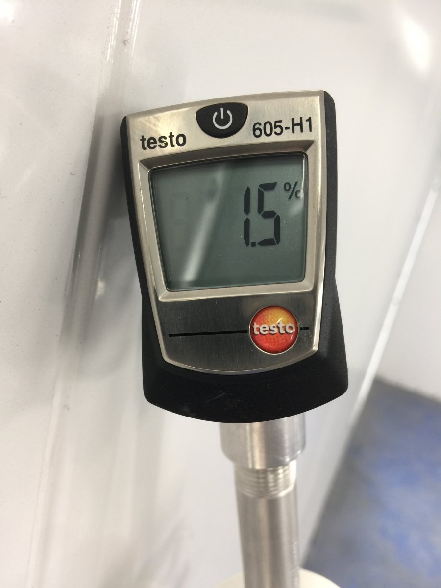

    We have randomly moisture test at several points in the system and each of these systems do their part in reducing the humidity / moisture in the lines. For proper painting you shoot to be around or under 7-8%.
    Attached are several generic pictures of the systems and an actual picture of the true reading of our moister in the spray booth (high moister will affect the paint in many ways....none for the good)
