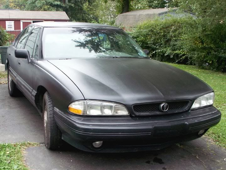

  1. i know the car is a late model an not hamb material, but i hope this is worth a look, I had been reading a lot on the internet about roller painted cars. My daily driver was really starting to bother me with it's blochy worn out factory paint job, bad primer in the 90's i have been told.
    Not wanting to pay $400 bucks for an average looking paint shop job, i looked to a homemade job. Since blowing paint with a compressor in the driveway seemed a little uncomfortable, I opted to try the hand painted method.
    I could not find a local shop that carried John Deere tractor black and I did'nt know if i wanted to bother dropping 40 bucks on good car enamel. I've painted my metal shed and my oil tank with Rustoleum. So I opted for a quart of satin black Rustoleum outdoor enamel at 8 bucks.
    Rain was forecast for 9 pm on saturday so i got started wet sanding the old finish at 8 am. note to Scarry Larry - your Jalopy Showdown stickers are very durable. I had to sand them and the car lot logo down to bare metal. I primed the bloches with 2 sprays of black rattle can primer. After more sanding I put down the first coat with foam brushes, my next coat and all the other coats i will do will be by foam roller (much better plan). But keep some brushes handy for tight corners and body indents. The first coat was thinned with acetone (about 30 percent acetone to 70 percent rusto) which went down a little thick, but i am not shy about sanding and i wanted good coverage to protect against the elements. My second coat was about 40 percent acetone to 60 percent paint. My next coats will be about 60 percent acetone.
    The Rustoleum dried very quickly in the overcast 60 degree weather and I was able to get the primer and 2 coats of paint down before i had to go to work at 5.
    i think it looks a lot better than the old paint. sorry for the small photos, i am having trouble with my photo bucket link. On close inspection you can see the over lapping strokes, but i hope more wet sanding and thinner layers will eleviate some of the strokes.
    If you have the garage to use a sprayer, it is still most likely a smoother job, but so far i have about 40 bucks in the job, including the thrush sticker I got for the window. add another can of Rustoleum that I will most likely buy. But if you want a little adventure, I testify that the roller paint jobs on the internet are not urban legend.
    We will see how it holds up to another tuff Philly winter, but by spring i will be looking for a late 50s early 60s beater with bad paint to park in my driveway for another paint job.
    Will post more when I get another day to lay more coats.

    Heat decals with a hairdryer then peel them off. Any citrus based cleaner will dissolve the residue. Tuff to say from the pic, but it looks like the hood needed more sanding. Paint is 99% prep.
    If the base is failing, the new paint will fail too.

    Do a search. You can do professional level paint jobs here for 300 bucks. MAX. ;)
    Looks like you still need more prep work, cut down on the acetone and try switching to lacquer thinner....it'll dry faster than if you use enamal reducer but not so fast that it won't flow out a little bit (acetone dries very fast and makes the paint look dry). Mix a small amount and do a test panel before using the thinner....back in the old days with older enamel formulations you could use this trick on things like tractors/farm impliment and ,uhhhh, OT cars like yours and get away with something reasonable....but not with a roller.
    Good luck with it.

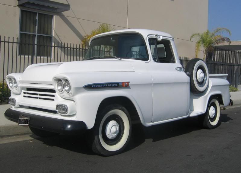

    100% roller painted. Been sitting outside with no cover for at least 6 months now. Never even buffed/polished the final coat... just some wax in a can like any other paint job.
    Looks great, super durable, hasn't lost it's shine. And when I dropped my garage door on the hood (stupid) it scratched but I was able to repair the spot in about 1hr with a little scuff and roll.
    I would never do it again on a large project becuase it was time consuming ... but I did it purely for the experience. It was well worth it for me.

    Don't use lacquer thinner if you have already applied paint to the car. The lacquer thinner will lift the paint. I worked in a body shop that we used lacquer thinner to thin acrylic enamel but only over factory baked on paint. We used the lacquer thinner for quickie panel repair jobs we wanted to turn around in a day because the lacquer thinner would make the paint dry faster. Once in a while we'd spray it on a car that we thought were factory original only to find out the panel was repainted and the paint lifted.
  7. the truck looks great, my paint job was easy because i used black over black, i think white was a more ambitious job, what color was it?

    I don't really mean to burst your bubble, but that Bonneville doesn't really look any better in the after photo. I learned how roll enamel (and spar varnish) once I got a Chris Craft. I use tractor enamel on the bottom of my boat, rolled. You need to use GOOD reducer, no more than 10%, not laquer thinner, not acetone. One coat will cover, it'll dry slow enough to flow out, you'll have a job that has no more orange peel than a sprayed job. Roll it, black foam rollers, not napped ones, tip it IMMEDIATELY with a foam brush. ALWAYS roll to a wet edge, and as with any paint job, it's only as good as the prep. I'm not say'n, I'm just say'n...

    Thats funny I'm still looking for the "After" picture,,,did I miss something?

    A satin black late model looks way worse than a peeling paint late model. You also just tagged it with a big sign asking to be pulled over. Cops don't like road warriors, car thieves, & tweekers, and you just identified yourself as one of those groups
    The whole point of sanding roller paint is to get a smooth base to allow a gloss finish to come thru without texture. By using satin finish you're completely missing the point and doing a shitload of sanding for no reason. The non-gloss surface won't show the orange peel.
    Switch to a gloss finish and you might be onto something. Current path is an exercise in futility. Just an opinion from a guy that's done a bunch of similar shortcut paintjobs. Good luck either way

    That truck Goozgaz did with a roller looks awsome! Is he sure he didn't use a HVLP gun? I've seen numerous pictures like that on the internet. However, from my experience so far I don't think it is attainable. I've sanded, sanded, and sanded. Oh, by the way, did I mention I sanded? If they say preperation is 90% of the job then apparently I'm applying the paint wrong because it still looks WT. It has horrible orange peel after each coat.

    I think you thinned the paint too much. The car looks more stained than painted. It's the pigments that provide protection so at this rate you might need quite a few more coats.
    Don't wax satin paint. If you want to be old school, wipe it down with a 50:50 mix of kerosene and water.
    Rustoleum probably will not hold up very well. Valspar or something like Benjamin Moore Industrial Coating Alkyd Enamel (available in satin black) might be a better choice.

    Hi Jimmy, just so you know, thinning paint is to be done only as much as needed to get the paint to flow/laydown without runs/sags. This varies depending on temperature/humidity, so you have to adjust accordingly. The comments you have gotten about your paint job looking a little thin, are due to over thinning. If you apply your paint, with less thinner you will get better coverage/richer color. You will find the thicker you use your paint, (less thinner added) the more texture you will end up with. Achieveing that balance between flow and coverage is what you are going for. Temperature will play a biger role as the temperature gets closer to 65 degrees. At that point the paint's cure cycle really slows down and you gain more flow. On the other end of the scale, temperatures above 90 degrees will make the paint setup too quickly, you will need a little more thinner, toulene to slow it down a bit.
