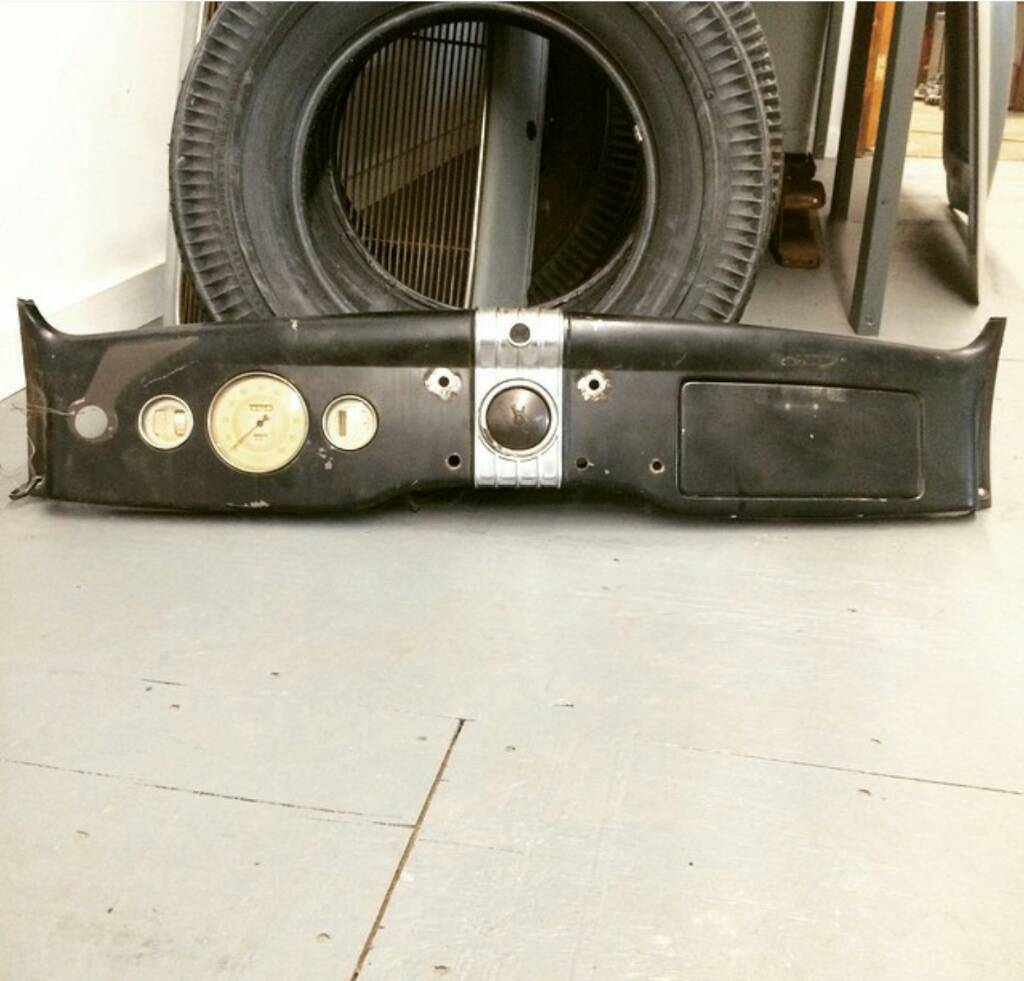

    So for the last 3 years the car basically sat and got shuffled around the shop. The car began to become more of a source of frustration for me than anything else. I continued to collect parts and formulate my build plan but nothing much else was really happening. One major change was deciding to go with a T5. I had a chance to drive a flathead/T5 powered coupe and was impressed with the drivability. In the mean time I bought a pretty nice 40 Tudor that was not so much of a project. Here's a few pix of some of parts acquired over this time
    Scored these Offy heads on a sweet trade deal
    Super stocked on this Pathfinder light
    Used my Hamb discount and bought my Flathead to T5 adapter from Cornhuskers Hot Rods.
    Shot the Wide 5's in black.
    I really dig 35/36 dashs. I scored this one for pretty short money
    I traded the stock frame to the local Model A guru in return for this Brookville frame at his dealer cost.
    My pal Steve (Peters) picked up the engine, tore it down, cleaned it, painted it and reassembled the engine in about 3 days. He also did some machining to the T5 adapter to ensure a better fit. I cant thank Steve enough for the bang up job he did.
    The 40!

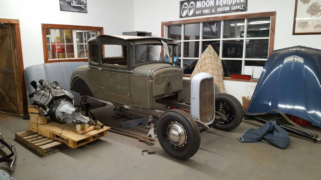

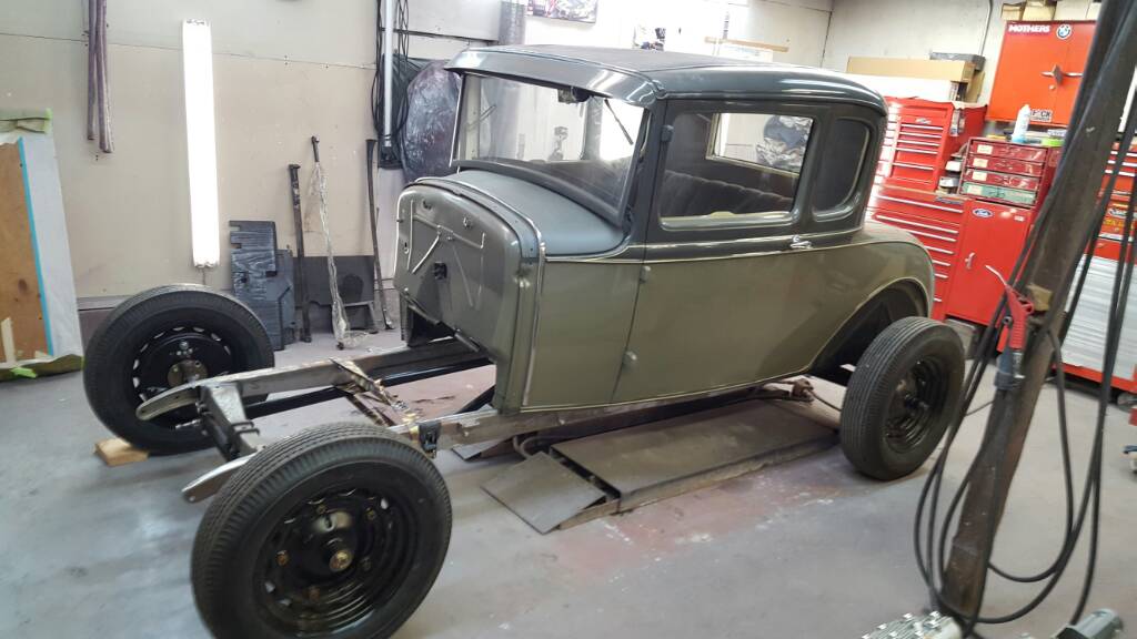

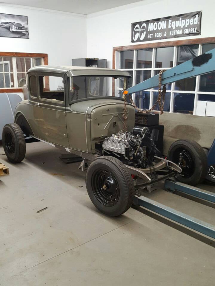

    At the end of this past October I made a decision to no longer be a partner in New England Speed & Custom. It wasn't an easy decision to make but I have zero regrets over it. A huge amount of stress and worry was lifted from my shoulders. Getting my stuff relocated lit another fire under me to get this car back on track. Last winter myself and a few buddies did make a roller out of the frame. I struck a deal with a good friend and excellent fabricator and a few weeks ago we moved the car to his shop. My fabrication skills are slim to none. So Mike is handling majority of the fabrication with help from myself and our pal Brett
    At NeSpeed some last winter mock up.
    Mocking in the motor and checking for clearances. I bought a new pulley set up from Ben Haag shortly after this to move the fan to the generator providing more space from firewall to front cross member.
    Brett's FJ power parking at Mike's shop
    In Mike's shop. This was Friday afternoon. (By Saturday 12pm the motor was in the car)
    32 grill shelf mocked up with the radiator
    Prefit of the hood.
    Motor and trans mated to the car. Next up is suspension
    Mike's #northmaine34 and the Afterhours.

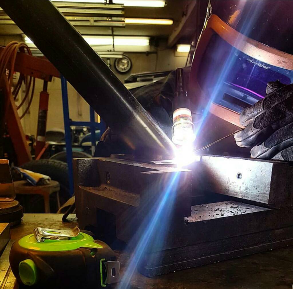

    The original plan of a 39 trans was to be mated to the car via a modified F1 x-member and pedal assembly. I probably collected a total of 4 to 5 of these set-ups before I changed my mind about the trans choice. The change to the T5 called for making a trans mount. My plan was to make a mount that could be used in correlation with a stock Model A cross member. After some discussion amongst Mike, Brett and myself. Mike set out with a plan and fabricated the necessary parts for the job. An F1 pedal assembly will still handle the duty of both brake and clutch pedals
    The plan for this car has always been to run an unsplit 32 wishbone upfront and 35/36 rear radius rods in the rear. I decided to make one significant change to this after being inspired by NathanXStewart's y-block powered coupe build thread. His use of a "johnny joint" on his rear radius rods I thought was a particularly genius idea. I followed his design and emulated the same radius rod set up utilizing the yoke from a 33/34 wishbone. Additionally I will be using a "Johnny Joint" on the un split 32 wishbone. Since I am already running a non traditional trans I'm not heartbroken about make these small alterations
    Mike tigging up the trans cross member
    Trans cross member flanges that will be bolted to the frame
    Mike working on the 35/36 radius rods
    The "johnny joint" attached to the 33/34 yoke
    A gusset was added for extra strength
