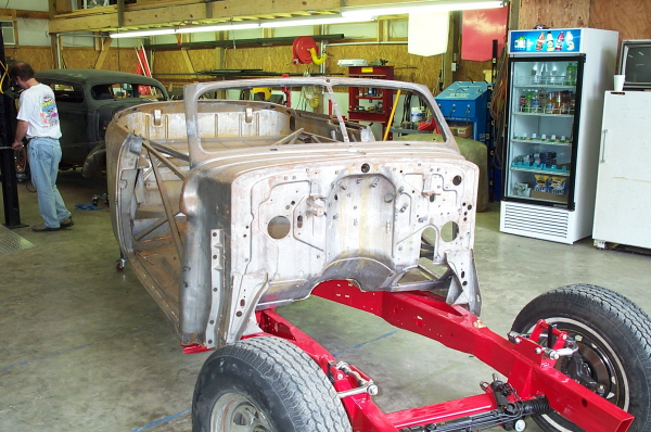

    I used a M-II from "JW's Garage" in my 49 Super Sedanette. They advertise in most hot rod publications. There are some modifications to their directions that I can give you to make the install easier if you decide to go this route.

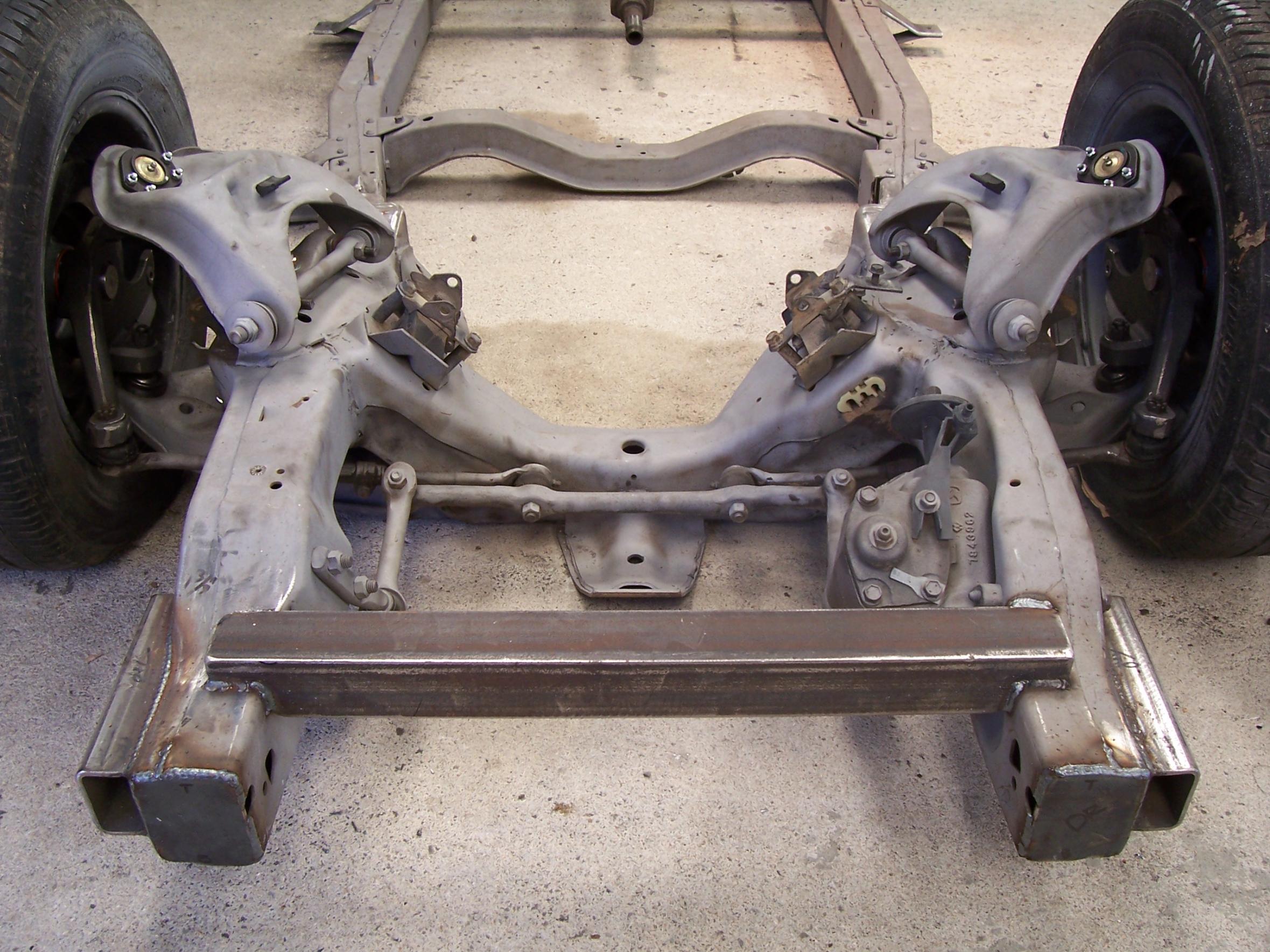

    [​IMG][​IMG][​IMG][​IMG][​IMG]

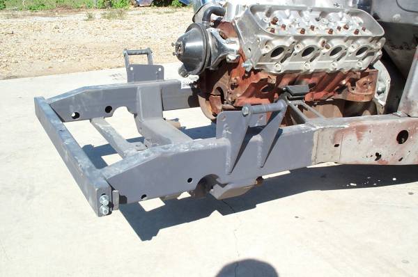

  30. I have seen Fatman clips welded on post war Buicks, a 51 Mercury, and several Hudsons. No complaints from any of the owners.
    The stubs are very simple and you could make them out of heavy wall square tubing.
    A Corvette IRS fits into the Buick frame like they were made for each other.
    I'll bet you could have Art Morisson or Progressive automotive build you a front clip that would accept Corvette suspension as well. Or you could fabricate your own brackets out of plate steel. Been done before.
