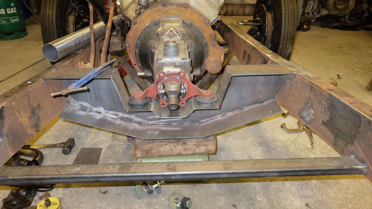

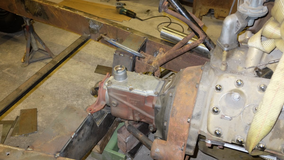

  8. redoxide
    Joined: Jul 7, 2002
    Posts: 402
    redoxide
    from Scotland
    Volvo 4 speed

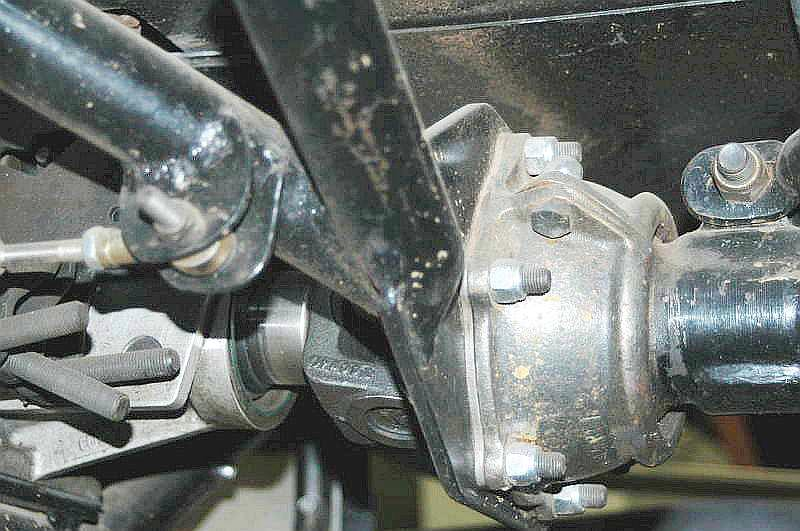

  14. Pete1
    Joined: Aug 23, 2004
    Posts: 1,630
    Pete1
    from Wa.
    With my system, you can use any transmission with NO mods to the transmission.
    You have to shorten the torque tube and shaft for the particular car.
    Cosmo50, 31hotrodguy, rwrj and 2 others like this.

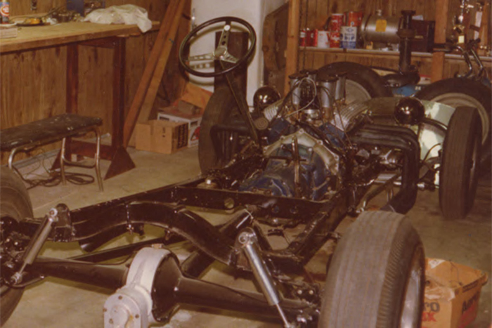

  15. x77matt
    Joined: Mar 2, 2004
    Posts: 560
    x77matt
    My roadster with a Jeep t5 using #Katokings adapter...
    Cosmo50, Cliff Ramsdell and teach'm like this.

  17. Hnstray
    Joined: Aug 23, 2009
    Posts: 10,427
    Hnstray
    from Quincy, IL
    While I think the setup is very clever, I agree with those who question the ‘arc’ of the ujoint versus the ‘arc’ of the torque tube. Looks suspect, but if it works, I guess it works.
    Ray
  18. Tim
    Joined: Mar 2, 2001
    Posts: 9,535
    Tim
    from Raytown Mo
    I think it’s one of those “yes, if this car had a normal long range suspension that would see movement/ compression of 3 inches or more then the math says this will fail”
    But a buggy spring car would be hard pressed to push 1.5 inches unless the springs are just worn slap out. They just don’t move much which is why something like that is feasible to do. By the time you move thst enough to bind or become a problem you’ve got worse problems to deal with
    Hnstray likes this.
  19. Pete1
    Posts: 1,630
    Pete1
    from Wa.
    The rear end has 4 inches of travel. With no spring on the rear end and the car jacked up so the rear end can be moved up and down to the limits, you can move the u-joint with finger force back and forth. There is NO binding.
    If the joint were bolted to the transmission like stock Ford, it wouldn't work very well.
    RICH B, 48fordnut, alchemy and 2 others like this.

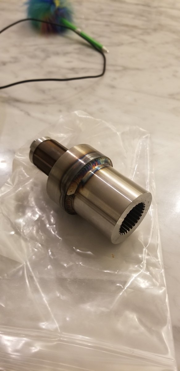

  23. enjenjo
    Joined: Mar 2, 2001
    Posts: 2,457
    enjenjo
    from swanton oh
    I have adapted both S10 4x4 and Jeep T5s to torque tubes. There is a guy near Akron Ohio that makes an adapter for the S10 4x4, and I have used it because it is cheaper than making it myself, but I have made them too. He broaches a Ford Ujoint yoke to the 27 spline S10 mainshaft.
    I have also adapted the Jeep T5 but it gets a bit more complicated because of the 23 spline mainshaft. The only yoke that I have found that comes close is from a Toyota Tundra, also 23 spline, but the Jeep mainshaft splines have to be cut deeper to fit the Toyota yoke. You also need to make a bearing support for the Jeep tail housing.
    I have also adapted a T5 to a Chevy torque tube. It's posted in the T5 info.
    31hotrodguy and Tim like this.

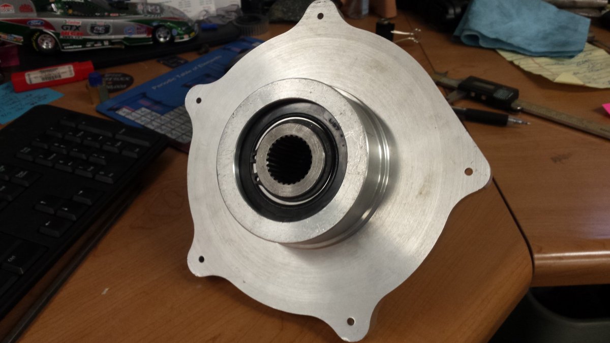

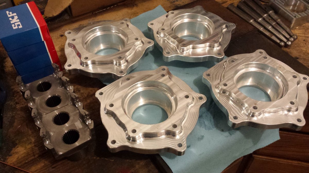

    Over the years, I have made and still make quite a few S-10 4x4 T5 to torque tube adapters. I initially focused on the S-10 T5 because at the time they seemed readily available and were inexpensive. They also lent themselves very well for the adapter as there is plenty of room in the tailshaft housing for a support bearing.
    Sure, everyone has their own opinions of the T5 and I get that the T5 has some inherent flaws, however behind a 6 cylinder or a banger, they work really well. One advantage of design an adapter for the S-10 4x4 T5 is that they will work in conjunction with NV1500's as well as the correct 200r4's and 700r4's from s-10's.
    I am currently working on a torque tube adapter for the Jeep family of transmissions. AX-5, AX-15's, B10 and Jeep T5's are way more available and still can be inexpensive. The jeep transmissions are much shorter than the 4x4 S-10 T5's as well which certainly helps with X-frame cars. Like my S-10 adapters, I am machining completely new components so that there will not be any modifications needed to the transmissions. I personally am hesitate welding on driveline components since I basically don't trust my welds, so they are machined from solid 4140 and will be splined to fit the 21 and 23 spline output variants.
    I have also worked with converting the Ford RTS 4 speed transmissions. When they are done, they are a very elegant solution, much like the Volvo transmission mentioned previously, however, they take a lot of work which makes them expensive. Most people do not want to spend that amount of money.
    KatoKings does make a nice kit for the Jeep T5's and enjenjo, we have talked at great length regarding your conversions. Basically, most any trans can be adapted with a certain amount of effort however, the 4x4 transmissions lend themselves nicely since there is a nice large flat area where the transfer case bolted to.

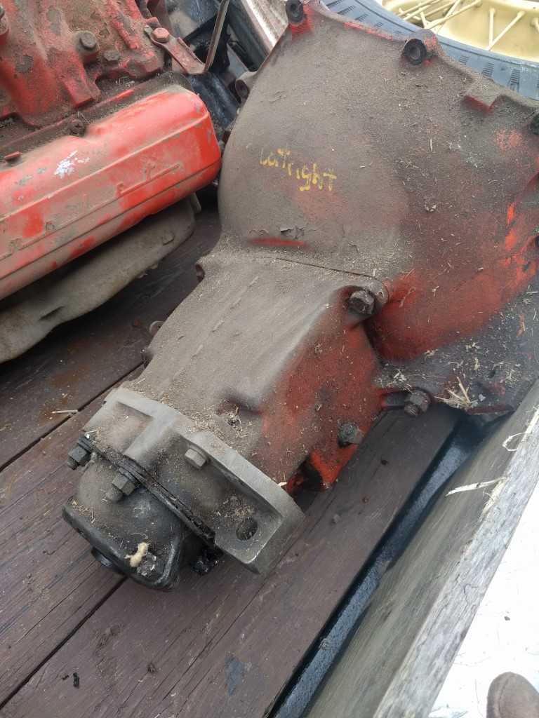

  26. I saw this old set up on a Chev 3spd; thought it was kinda cute. Neat if you could combine it with an X shift case and some close ratio 'vette gears inside.
    31hotrodguy likes this.
