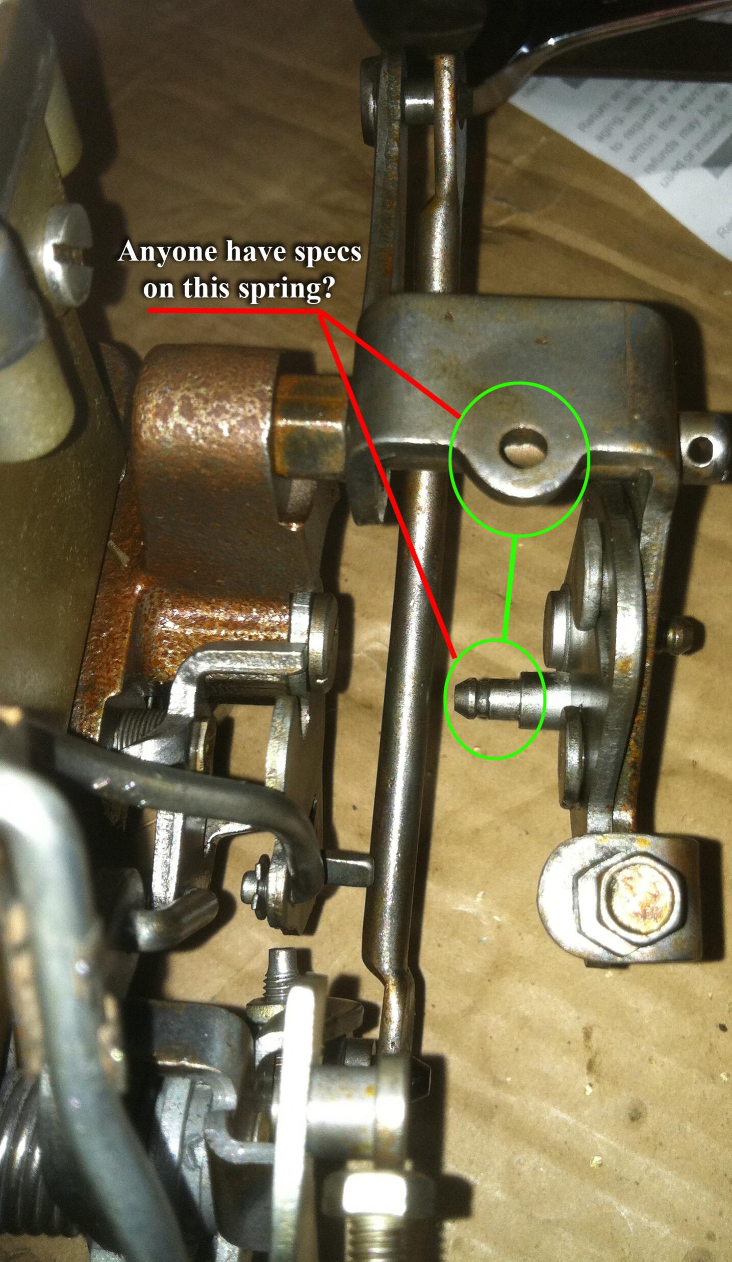

    Yeah, you're right, it's actually not that hard a carb to dig into. I actually think this is easier than some of the one barrels I've opened. More room to work.
    So far, the only thing that I'm seeing that makes me wonder, is this threaded port that is open to the secondaries. I never noticed it before, and now I'm wondering if I don't have a huge damn vacuum leak causing the thing not to want to stay running once it fires.
    From what I'm seeing, nothing is sticking.
    Next step is checking the float levels and seeing about all the adjustments per the manual when I put it back together.
    The port I circled in the picture that's open to the secondaries... What should that be plumbed to, and should I just plug it for now? I have the vacuum advance port plugged.
    Initial settings on mixture screws? I haven't read that far in the manual yet, but anyone got a good number of turns out off snug that is a good place to start?
    Oh, and what the hell do some of these guys even bother with the shitty gold carb paint for? A drop of gas and that stuff shits the bed and looks fucking terrible. I wish I had a tank of stripper so I could just go back to a bare casting. Better than this fake paint plating.
    Thanks again for all the help!

    Ok... Carb is back together. No extra parts! I went through and adusted everything for clearances according to the manual that could be done off the motor. Going to reinstall tomorrow morning. Hopefully this problem is a combination of vacuum leaks and minor adjustments being made.
    I'm also missing a spring, I'm pretty sure, anyone have specs for it or know if there is a supplier that carries these?
