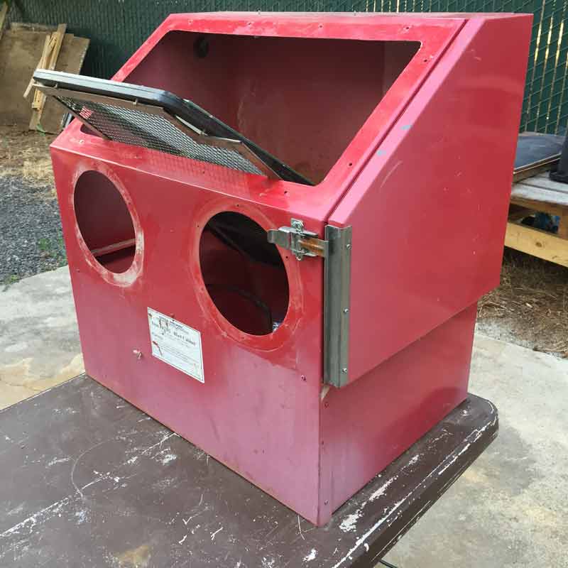

    Josh, my son has the same blaster. I mounted it on a roll around platform to getit out in the drive way easily. The light is pathetic. I would stuff a sealed box and a fog light up in one corner to improve the lighting if it were mine. All of that stuff is readily available at the hardware store. Look at TIP's website to get some ideas. They sell a ton of blasters. I have had one for over ten years. Great machine.

    I did run silicone in the seams and upgraded the light in this cabinet back when I got the thing... It was a craigslist acquisition. I need to redo the silicone and seal up all the openings with actual weatherstripping rather than the glorified meringue that HF supplies it with. Stripping that crap off of it was the majority of what I did yesterday. I'll take a look at the site you mentioned and see if I can do any other improvements. Thanks!

    Well, the commie blaster is sealed up as best I think it can be, and I attempted to make one of the TP style double barrel pickup tubes. See if that helps me or hurts me considering my compressor is not very big.

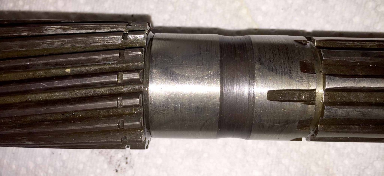

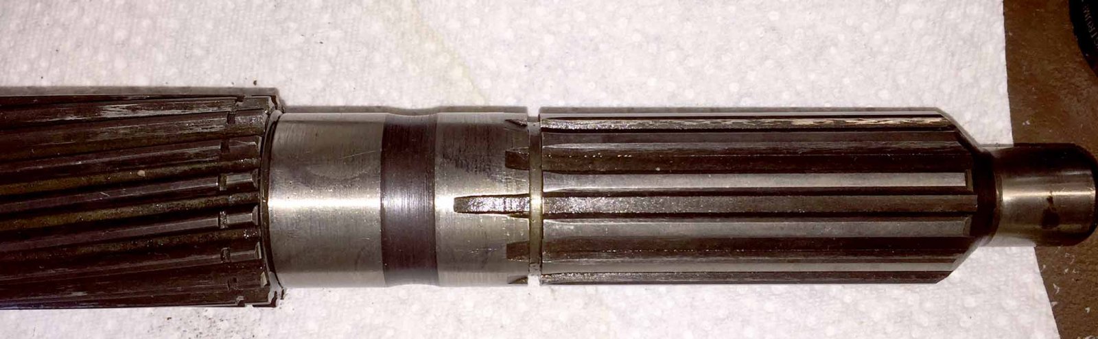

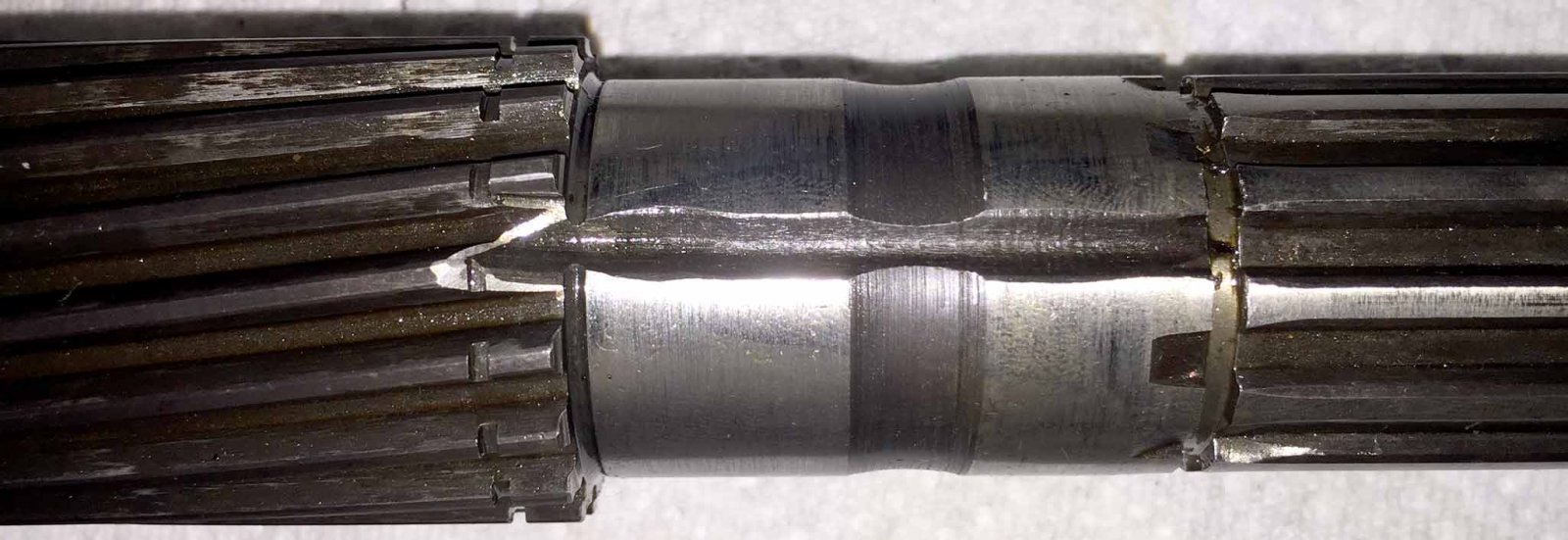

    Ok... Got the trans all torn apart. The snap ring holding 2nd gear on the rear main shaft was a nightmare to get off. One side was bound and it took a while to free and then it just didn't want to come out. Took an hour just to get enough screwdrivers in just the right positions to open it up and finally slip it out of the groove completely. Other than that... My only issue is the speedo drive gear. I don't have a press. Maybe I can have it pressed off at the shop I found last week. I'm curious about your opinion of the rear main shaft bearing.. It is shielded on one side only. The rear facing side is open. Do you guys think I need both main bearings to be open on both sides? The bearing number is 47606. The tail shaft seal number is too pitted to read. I'll call NW Transmissions on Monday and see what they can tell me.

    I wonder if you are missing a small piece.
    Under that snap ring, there should be another ring hidden. It looks like very thin hardened wire...never measured it, but lots thinner than 035 mig wire.
    I don't know why it's like that. It seems to hold the regular ring up higher in the groove so you can get ring pliers on it easier. If it is missing like one mainshaft that I had, it was harder to do, as I recall..
    Also, did you have the rear bearing and mainshaft, pulled out of the case, and angled up in front to get the ring better?
    I spotted a mainshaft this week, and I know the rear bearing had a shield at least on one side. No idea what year.
    I can't say what to use, but you can ask that trans place.

    That's interesting... I certainly didn't see a ring that small behind the snap ring. It was the snap ring, and then a thrust washer with an indexing tooth to keep it from spinning on the shaft.

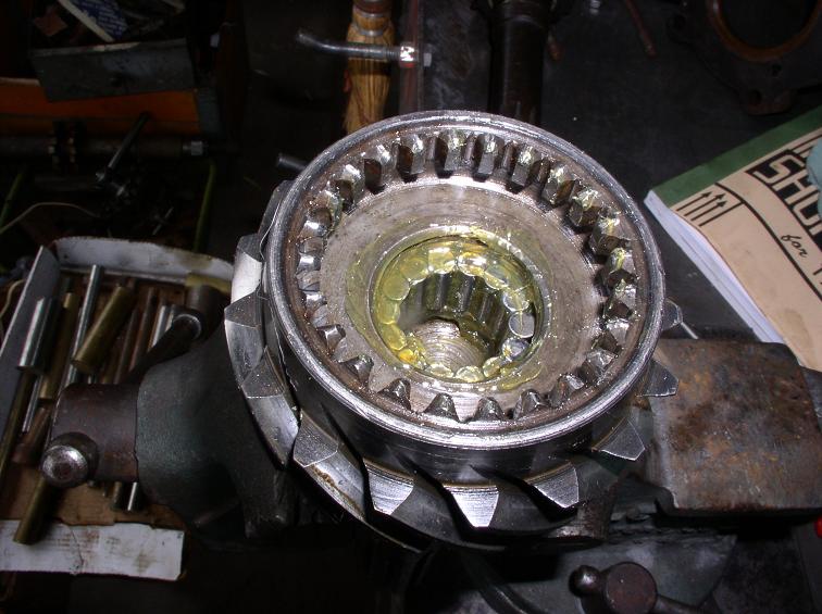

    that's exactly right, clean the races and bearings then use grease to hold the needles in place, not that big a deal
    LaSalle input here but you get the idea..

    you need to look real close to see it in the bottom of the groove, it might be up against one side. Easy to miss it as it is stainless color.
    Did I forget to address that in Fedco's thread? ... if you have spare heater hose laying around. I have one cut to the exact length of the cluster. I even use it on disassembly ... I get the shaft to start to move with a long punch, and then slide the hose into the bore to follow the shaft, as the punch keeps moving the shaft. I just hate to chance breaking a needle with the punch as they fall out without a hose.
    On assembly, put the hose in the cluster, then pack the needles and the "needle-thrust washers". Drop the cluster in, and the shaft will push the hose out and needles stay put.. (I always worried that if I used just grease, is there a way that one or two needles could get knocked loose, and remain in there trapped? Not sure if they could even fit alongside the spacer tube, but i use hose anyway. Maybe it's not needed.)

    Heater Hose! Very clever Frank. I was out there scrounging for a piece of bar stock that was hopefully within a few thousandths of the right diameter. I found a piece of aluminum bar that would be a bit smaller than the heater hose... Anyway, no need for it now! Awesome idea. I'll be using that for sure! Just gave the case it's first real degreasing. Maybe I'll get it taped up and blasted tomorrow. Thanks!
  17. Josh, I use a piece of conduit in place of the hose trick Frank mentioned. Both work slick as heck. Curious about that rear shaft. Can you post pic of it. Mine has the usual pia ring and another located on the shaft. I did not find the small spacer ring either. Only seen one ever and that was on a 37 Lasalle that had been rebuilt by a po. NW will have new snap rings if yours is torqued out of shape. Think they are $3 or so. I believe they have them made as they are narrow. Just had to get one for the 37 lasalle last week. Seems all the aftermarket bearing are sealed on one side. Never thought to ask John last week about that at NW. He is the go to guy there regarding the old trannies.
    And on reassembly stand the case on end when installing the cluster gears as it makes it a lot easier holding the thrust washers in while you insert the shafts. End play on the cluster should be around 12-25.....according to John.

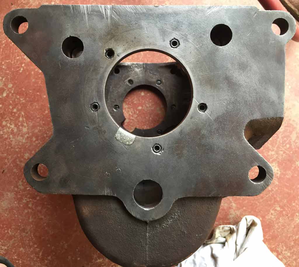

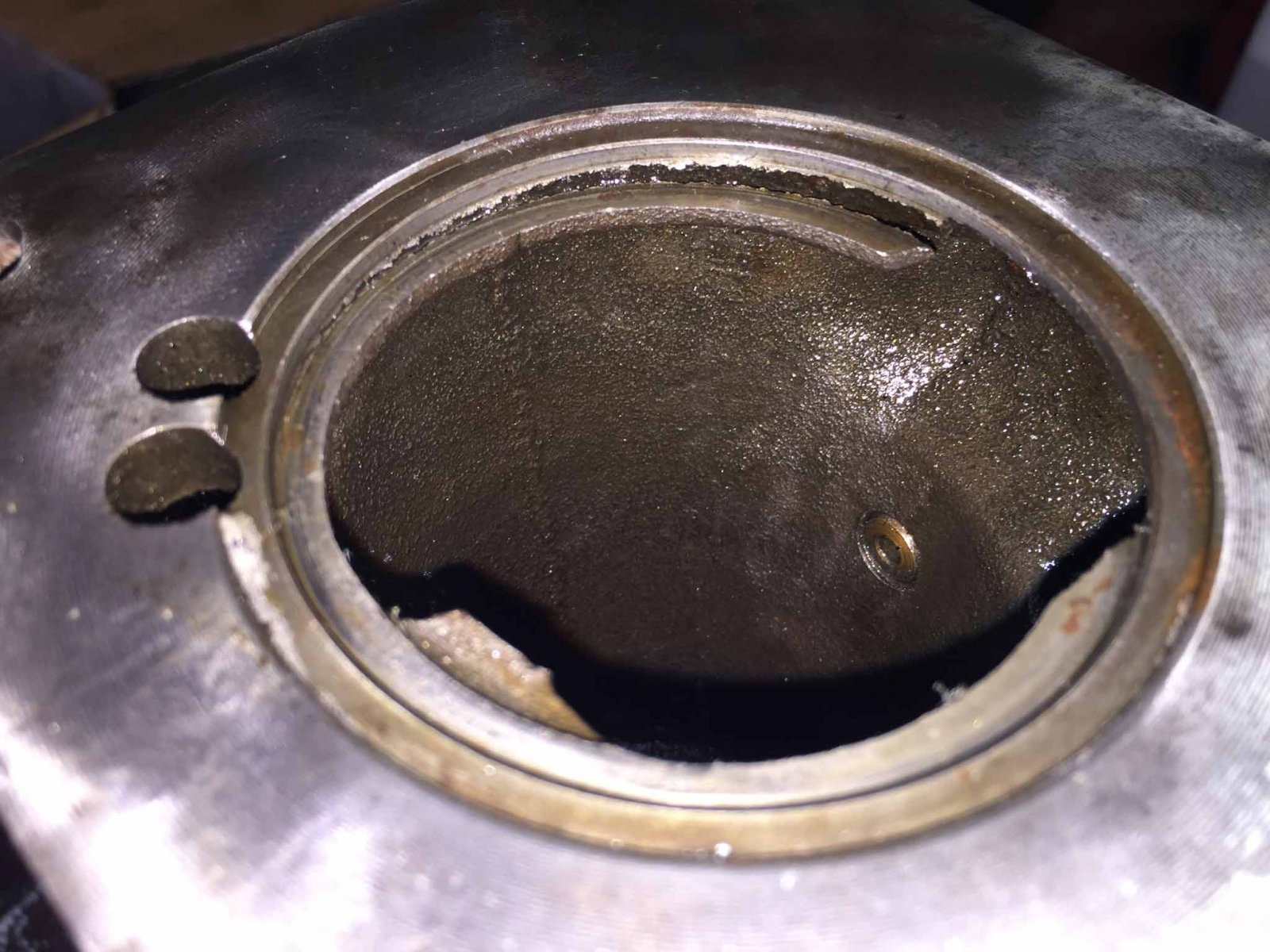

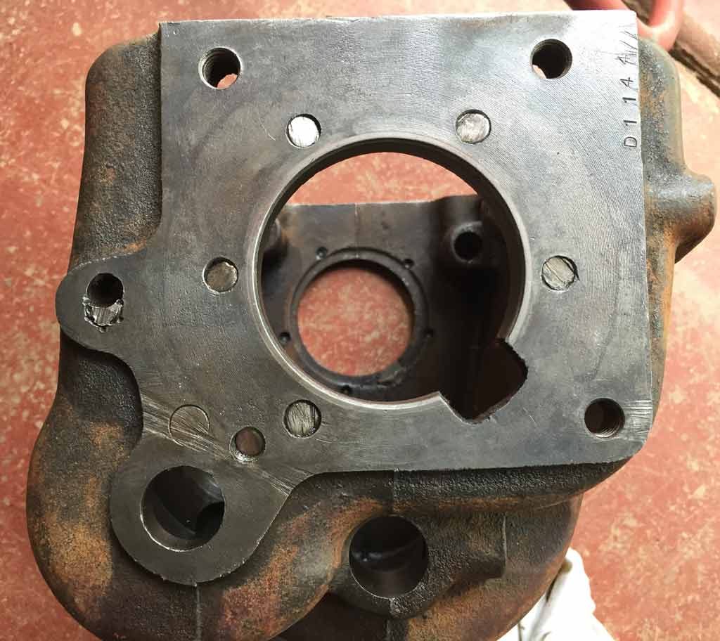

    Here are some pics of the case after it's bath. Some pretty ugly stuff going on htere... Any thoughts on the lead plug at the front of the case around the front main bearing surface?
    I wonder what all the extra plugged holes were for around the tail shaft housing?

    If I recall correctly, the old gasket sets for these transmissions, fit the Buick back to 1936 and up to the last buick stick in 1960, as well as 51 to 64 Olds, and not sure about Pontiac 56-7 Selector. So, the old sets would have the correct tail housing gaskets for both the old Buick, and the Selectors too.
    Ok, the front leaded plug. I don't get what they were doing, as that is the factory oil return from the input main bearing. Why did they plug it, because it does line up with the olds bell oil pocket hole. So they cut an oil path in the bell to drain any oil that got past the sealed bearing? Why? Did they not know there is a full face gasket?
    I don't know why they plugged the old 36-38 TOB/bearing retainer holes, unless they did not want a gasket???
    Ok, the back. Yes one plug is needed to fill an exposed hole that used to be one of the four tail studs. One must be moved and then plug the old location. One of the studs is shorter, so that it can't protrude into the case, and tangle with the gear. If yours uses bolts instead of the old Buick studs, make sure you prefit them with the tail. Some Selectors also had studs, but many were bolts.
    The other half plug. I believe that is the oil return from the tail housing. I think I added info on that. When you use the Olds tail, a tiny spot of the oil hole can be exposed, if the castings vary. I assume they dry fit the tail and saw a gap, then plugged and redrilled?
    The next one I do, I am going to try to rotate the tail, to see if that would help. I, and probably everyone back then, starts the tail fitting by elongating the two top holes in the tail in opposite directions, equally. It's just easier I guess. But I want to see if I can do the first of the top holes to favor that oil hole coverage. Might be more filing, but should work. I'd have to see about the lower right side though, before I start.
    So, I'm thinking I'm gonna take that out... Seems like a bad idea.
    Are you referencing the 6 plugged holes around the front mainshaft hole? Seems like your case as seen in Fedco's thread didn't even have those holes at all...
    So, next thing... I got the case and the tail shaft housing washed, taped up, and blasted today. While washing the tail shaft housing, I noticed the machined surface where the rear bearing seats is cracked. However, I think it's a secondary lip. I think the primary thrust surface, which the bearing snap ring is captured against is above it. So, the question is, should I take that cracked section of the cast out with the dremel and grind it all smooth? Or try to have it repaired? As you can see, it's curling down, almost like a spring. I don't see any way to repair it considering there is so little material there and no way to grind out the crack since it goes all the way through, and is almost more like it's peeling away from the case. Thoughts?

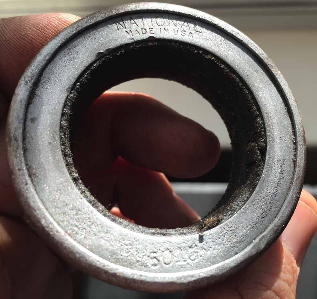

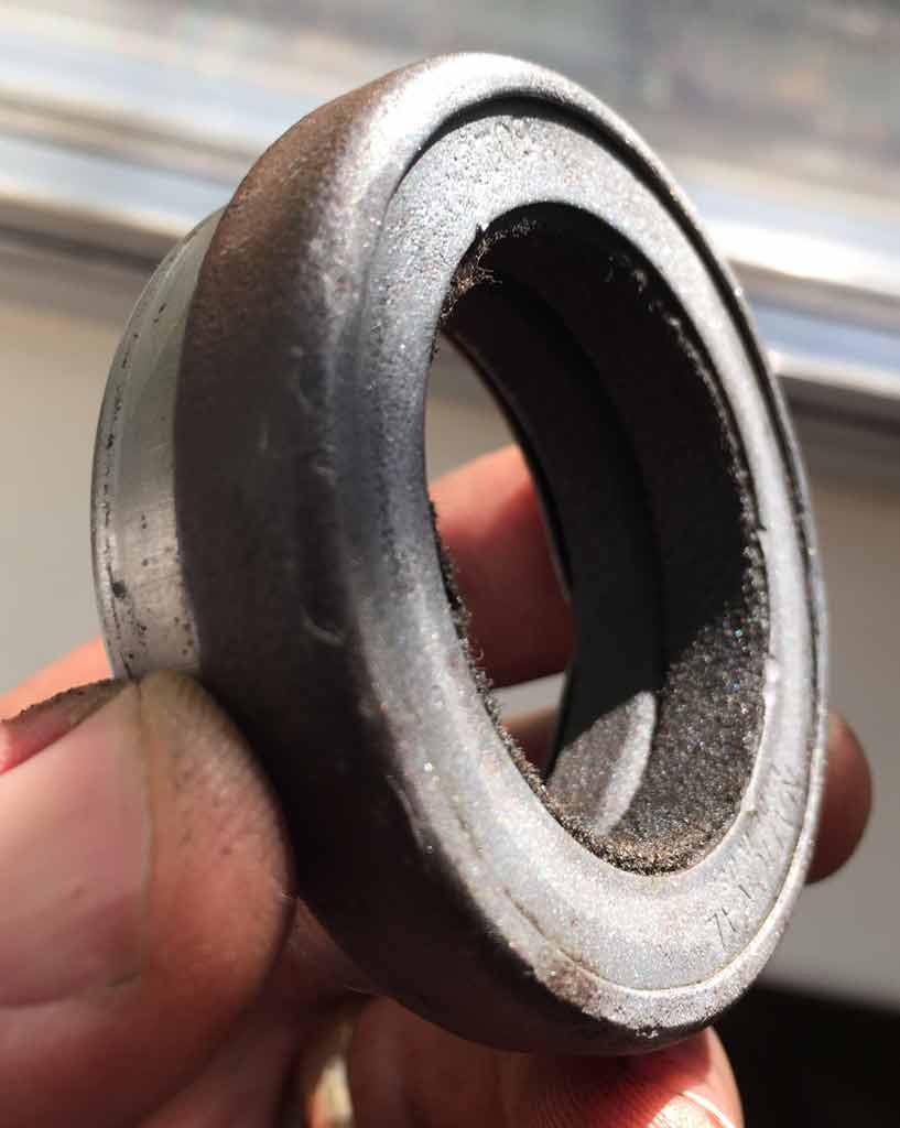

    Finally... Does this rear main shaft seal look familiar to you guys? The number is too far gone to really read. Possible candidates are National 6010, 6013, 6015, 6016, 6018, or 6019... None of which seem to cross! I'm wondering if you guys had this type of seal on yours or not.

    I'm sure I had an update on the cracked tail housings on that thread. I looked at quite a few here, and it was caused by casting core shifts. I had spare good ones with plenty of material backing up the bearing.
    Yes, it is now supported mainly by the ring....at least on the one side that is broken.
    The seal looks familiar. I can look up the GM number if you need it
    I did not go look at the thread pic that you could not see holes in my case. I just don't recall, but I do know that trans came from a cutdown doodlebug as a second trans which had no TOB /retainer. I think the seller said it was bolted to a huge flat plate and a small hole for the input shaft. I just can't recall if they plugged the small holes and used the 4 big holes...or not. That trans is in my 32, so I can't look at it

    The GM number would great, Frank. I will look at your thread closer to see if I can find what you wrote about the cracked tail housing. In the meantime, Walt, here are a couple pics of the tail shaft. It has two snap ring grooves as you can see... As well as yet another sign of some kind of grinding by a PO.

    Ok... Just spotted the part where you discussed the exact thing I referenced. So... Would you just cut that part and grind it all smooth to stop the crack... Hopefully you're not thinking I should scrap this one.
  28. On my Buick top shift tranny with the olds tailhousing I found a metric seal was a perfect fit as the OD of the original is non-standard . I ordered rubber coated seals off Ebay. The seal number is in my build thread, but I will try to dig it up.
    Finally... Does this rear main shaft seal look familiar to you guys? The number is too far gone to really read. Possible candidates are National 6010, 6013, 6015, 6016, 6018, or 6019... None of which seem to cross! I'm wondering if you guys had this type of seal on yours or not.[/QUOTE]

  30. Josh the seal is available from NW. Just received one and it looks like a factory item. It came in the rebuild kit for the tranny that I ordered.
