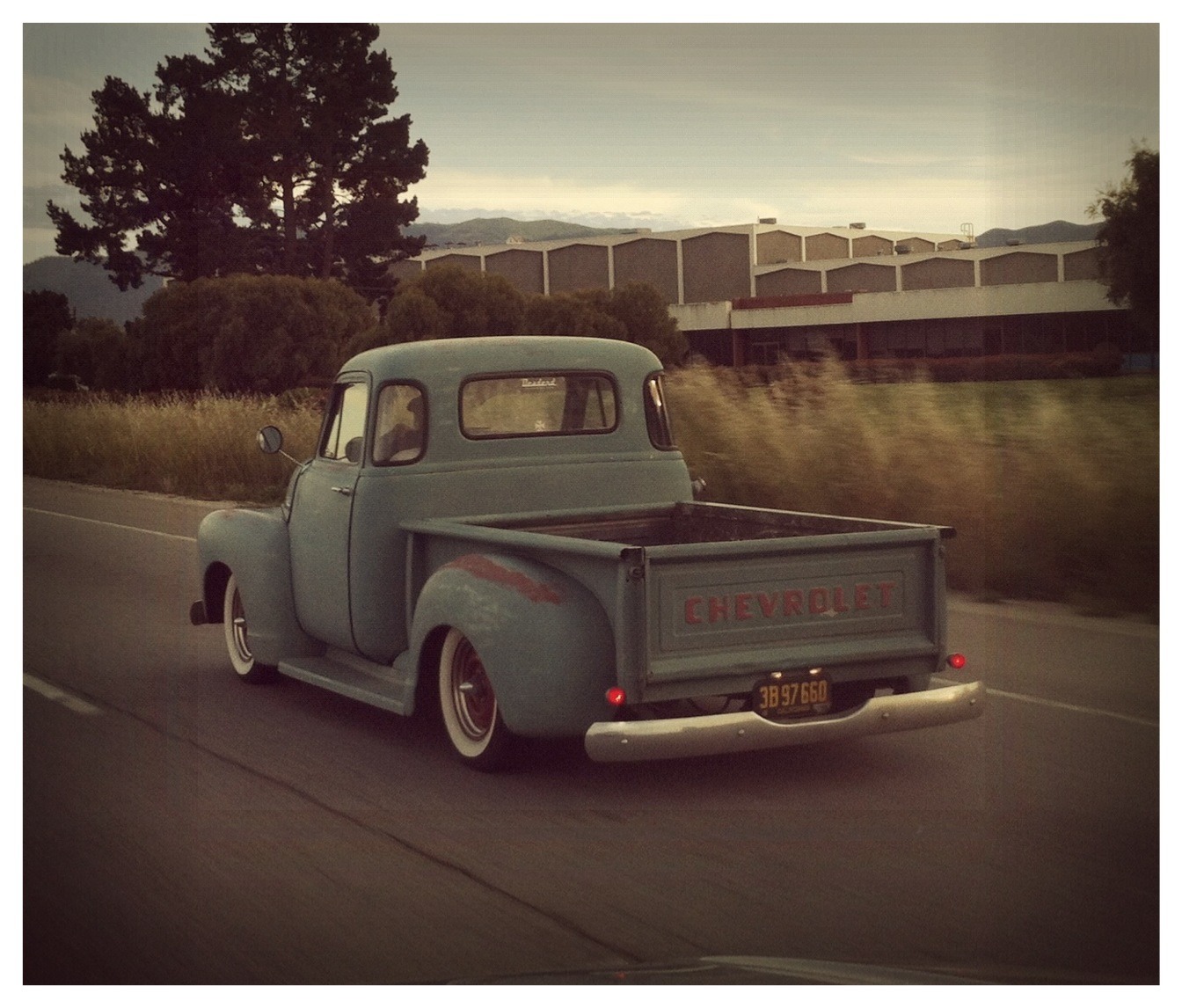

  21. Here's a pic of mine. It's the only one I've got on my phone right now. I'll add a better shot later. ImageUploadedByTJJ1340775205.104703.jpg
