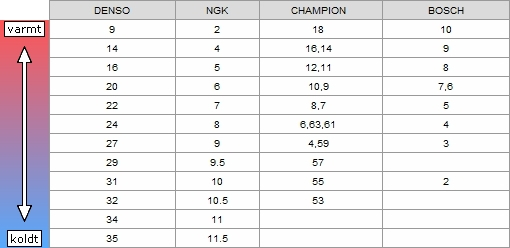

  8. volvobrynk
    Joined: Jan 30, 2011
    Posts: 3,587
    volvobrynk
    from Denmark
    I might be wrong here, but read the full post.
    Normally the R means Resistor/Radio protection, it has nothing to do with the type of ignition you are running, it allows people around you to listen to radio with you driving by, it also lets them watch TV, for those who doesn't got cable.
    Because otherwise it will give them interferers.
    But since most people got a Cable or the like of, and most Radio signals at digital, it's less of a problem.
    It most important with FM signals, and I believe you mostly uses AM. So it might not mean that much to run them with out the R.
    And going by the ES or S short, sometimes you can run the a long plug, it comes down to do you have the room for them. And then find the right glow value.
    But take this from a guy that mostly runs Bosch and NGK in place of AC and other of continent brands.
    We run them differently, because we want them from the shelf, and not the ones than comes in next week.
    I've spend the longest time going true "translation"charts to find a good match for a 265, a flat head 100hp 21 stud and for my Volvo to get the best match, performance and availability.
