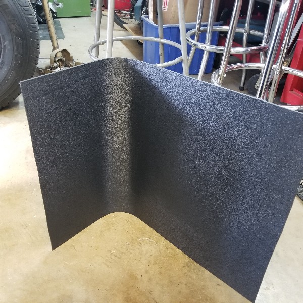

    Alright, time to bend! I didn't take pics of the actually torching 'cuz it takes both hands as it is and no time to grab the camera.
    Remember the marks on the tape? Transfer them over to the backside of the ABS with the factory edge (primary reference) on the bottom and lines at a 90* angle to the bottom. When you start bending this it's going to try to move in ways that will confound you, so SOMETHING has to be a constant. These lines will be your guides for the torch. The tools? A torch and a cloth.
    When you start heating the ABS, line the flame up with the OUTER lines because the overlap will heat the center. If you mostly heat the center, you'll have a sharp bend and inconsistent radius. Long, even, rapid strokes VERTICALLY. Trying to hold and heat it horizontally will give you a nice fold whereas vertically lets you control the bend. Play with some scrap to get a feel for how much heat you'll need, how the surface of plastic changes when it hits different temperatures and to get the feel of what temp to bend it and how much.
    You'll find it will tend to wave as the temp across it changes. Keep the heat as even as possible both horizontally and vertically to get an even bend. You'll see where an edge is cold has a hard line, so apply a little more heat. The cool thing about it is you can "knead" it on the concrete floor. With the towel, knead it flat on the concrete until you can feel it stiffen up (the concrete will help it cool quicker). It doesn't have to be molten to knead it either..... you'll have a decent amount of time to work it. The idea is to bend it with as little EVEN heat as possible to bend it.
    Here's the finished product. You will be tempted to keep heating and working it, but keep in mind where it's going, what will be trimmed off, and if working it is worth the effort.

    So, after bending it's time to start trimming. The shortcut is I can use the other side and mirror it. I can't trim it exactly as the other side because it's a '31 and no matter how "production" it was, tolerances were mere guidelines. The most critical area is trimming around the 1/4 window trim. I left about 3/8" of material (using a small cutoff wheel) so I can just sneak up on it and get a tight fit. The interesting thing is that no matter how clean the bend is the panel is under tension. When you start cutting and trimming it'll start to pop and move. Tomorrow I'm spending some quality time with the die grinder for finish trimming. There's only 2 weeks until the show so I have to kick it in gear.
