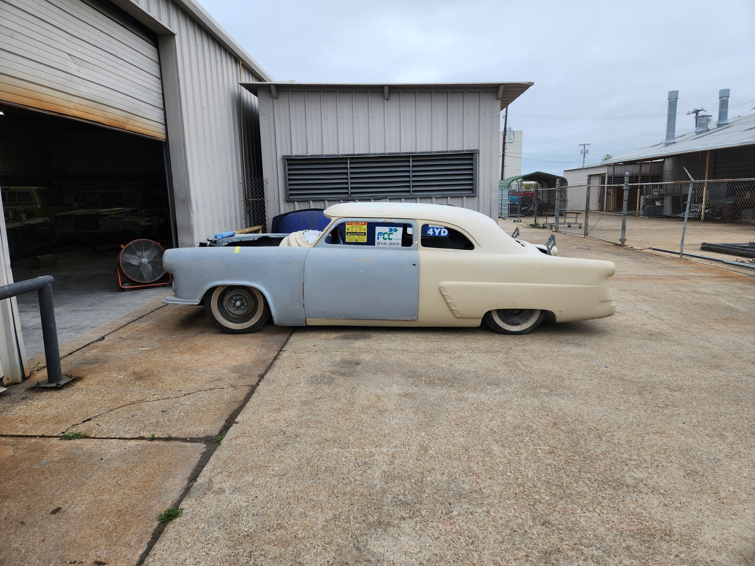

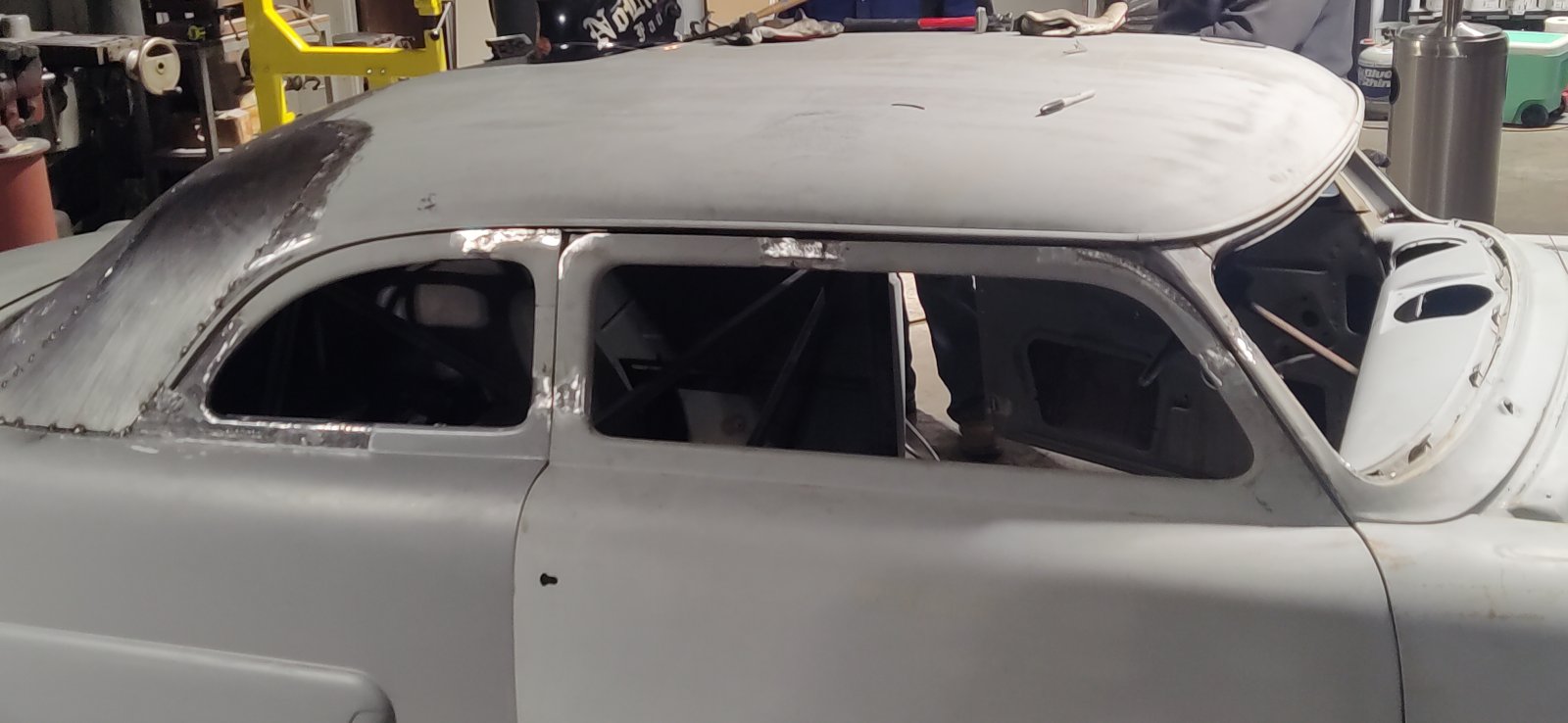

    I headed down to Texas to the Dallas/Ft. Worth area in order to put my touch on a '52 Ford car. We had a great class and got a lot done!! Here are the results! Not too many people get these cars "right" when they chop 'em, but I think we did pretty good for 24 hours of work! IMG_20221119_084719.jpg IMG_20221118_185916.jpg IMG_20221119_144332.jpg IMG_20221119_203839.jpg IMG_20221119_203853.jpg IMG_20221120_160200.jpg IMG_20221120_160256.jpg IMG_20221120_160148.jpg IMG_20221120_173634.jpg

    Looks great Joel! And, I agree that I have seen as many chops on those 52-54 Ford’s that aren’t right. I would call that one right. Looks like it will be a pretty kool car when done. :cool:

    Thanks Joel, looks great. In the pic below the top back of the door has been radiased. Just wondering why that is done and how that area will be finished?

    The top corner in front has been radiused as well! The corner of the door is cut off, welded to the body, and a 3/4" strip welded perpendicular to it to finish it off. It's sole purpose is style!

    You boys got it right ‼️. The rear window/roof treatment is excellent. What did you use for the rear window ?

    Thank you! I had some good advice! We used a '59-51 Ford sedan rear window.

    I have to say, this is one of the best looking chops I've seen on one of these. It's not cut too hard or dropped too much. The hard part with these is that with the sedan door, you really can't start flowing the roof down because it changes the angle of the door frame. The roof has to drop vertically. This is an excellent example where restraint pays off. The car is obviously chopped, and clearly has a more aggressive, sleek look about it. But it's not overly done or distasteful. Less is more here.

    Thank you! If you've been following my chops for awhile, you'll know that 95% of the time I practice restraint and try to make the roof as proportional as possible, usually I use the 2/3 to 2/3 principle.

    How'd you come up with the sections behind the quarter windows? Did you fab them from scratch or visualize them in another body part? Either way, it really flows well.

    They were made from 18g flat sheetmetal with a mallet, beater bag, and English wheel. Thank you!

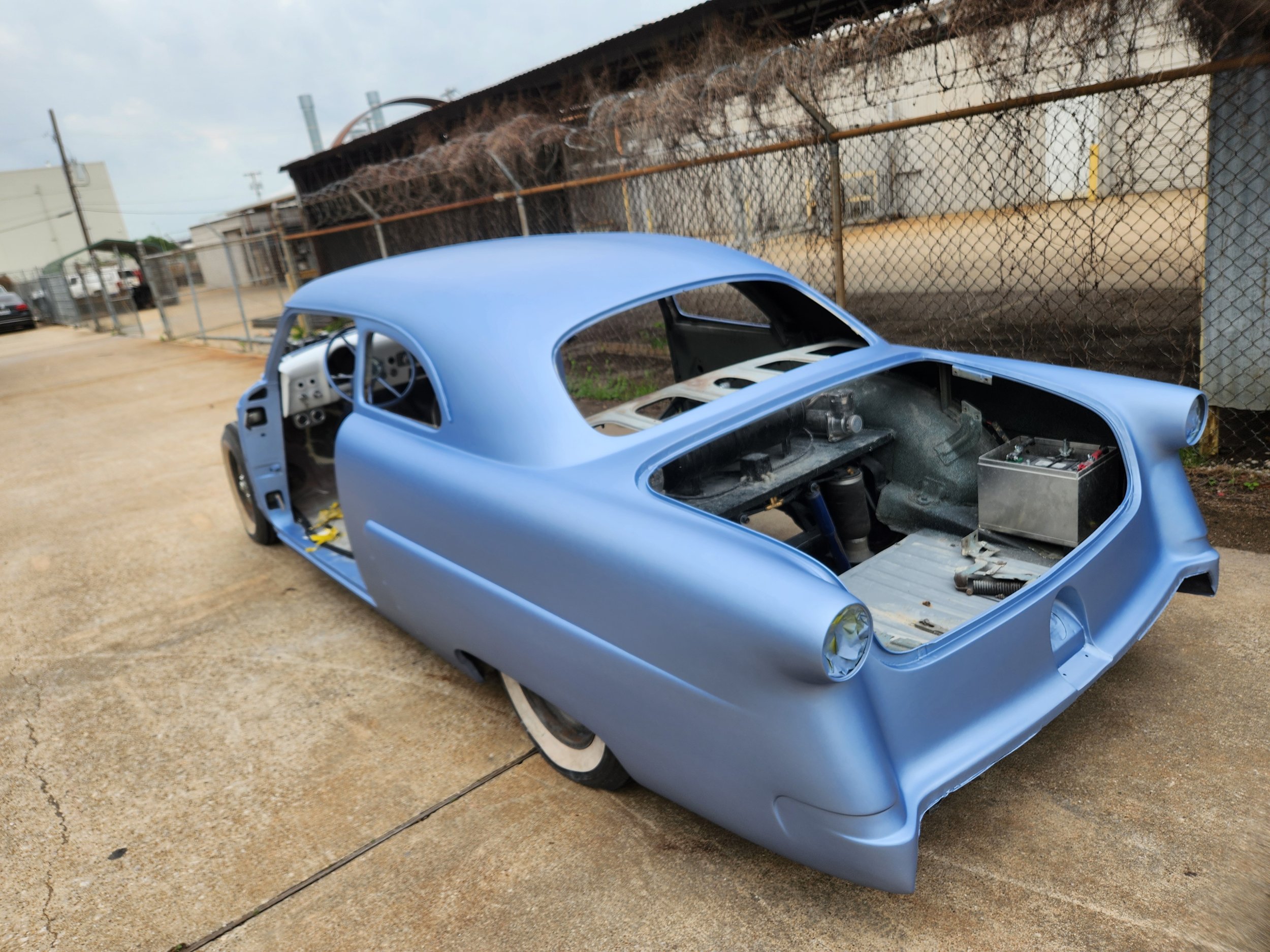

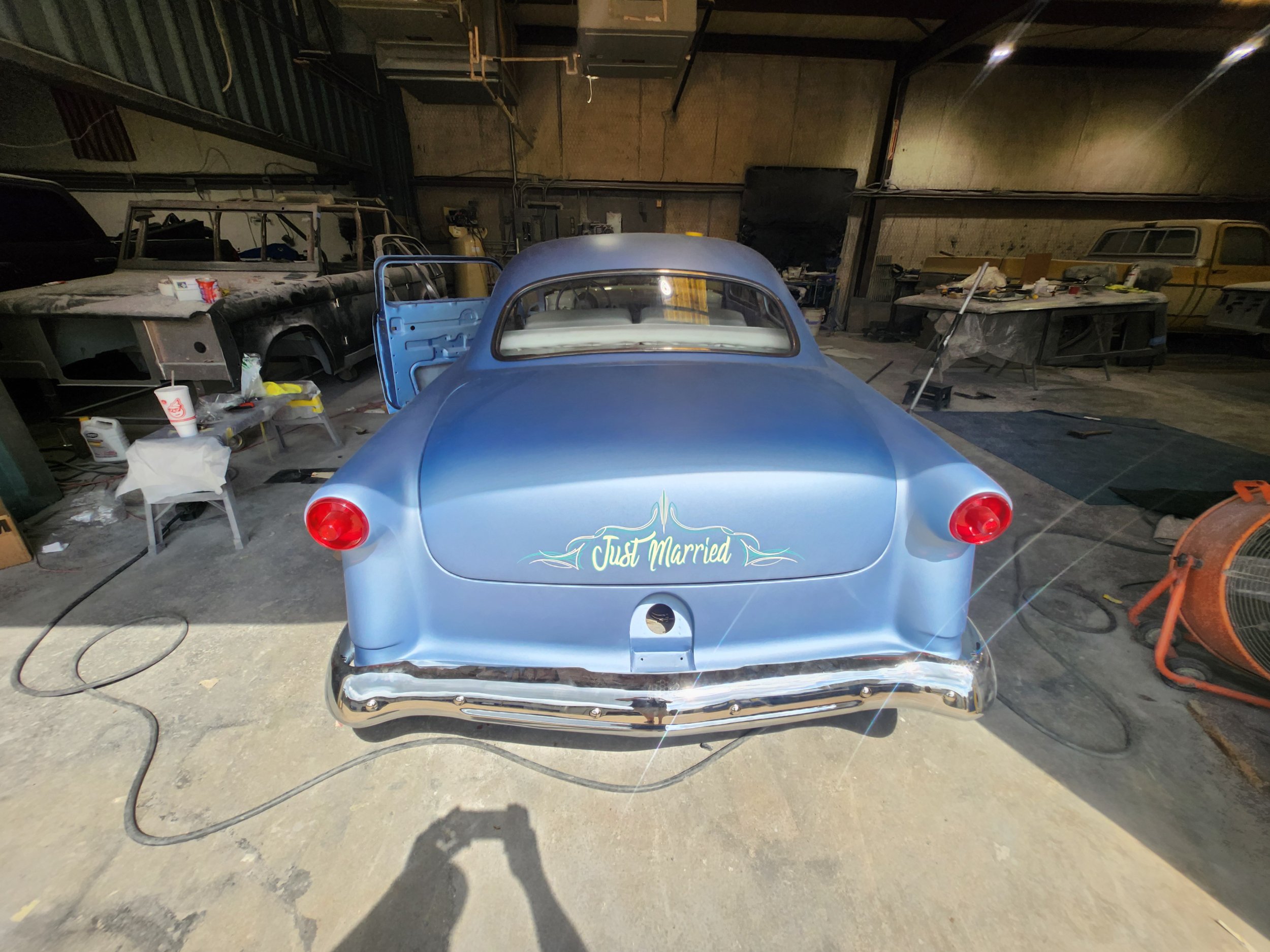

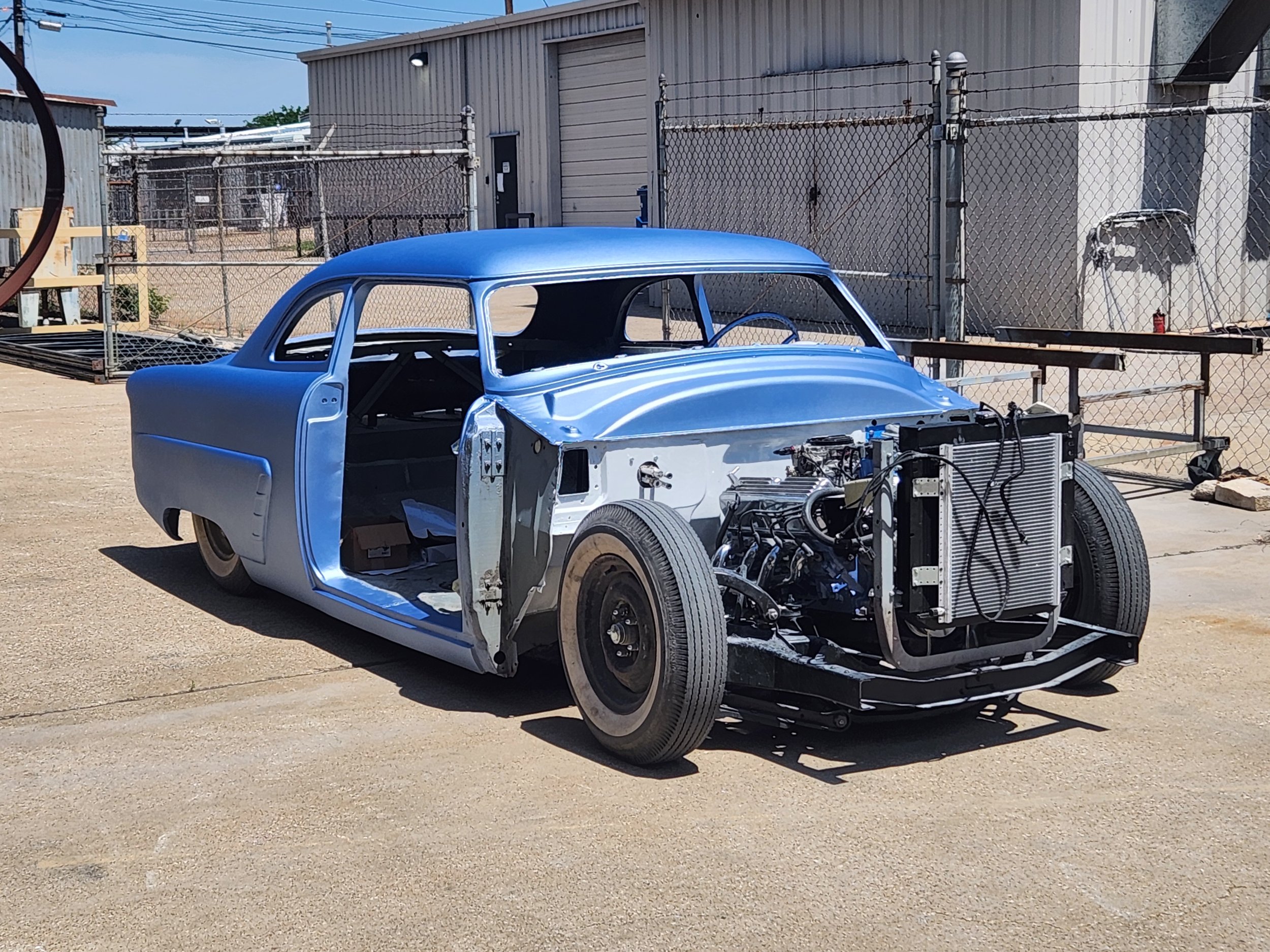

    I know this post is from a while back but I'm just now seeing it. Thanks for all the positive comments on my car. I've been busting my tail to finish this for my daughter's wedding May 3rd! She wants to use ut as her "getaway car" leaving the wedding chapel. Plan to finish paintwork by next week and get it reassembled. I'll post up pics if anyone is interested.
    Pinstriper40, drdave, Tim and 4 others like this.
  24. Absolutely, love to see any new pics!
    panhead_pete likes this.
  25. CaseyB
    Joined: Mar 17, 2006
    Posts: 54
    CaseyB
    Here's a few of where it's currently at. Less than 2 weeks to go....

    Been a long week but its coming together.... 20250430_205603.jpg 20250430_172532.jpg 20250430_172519.jpg 20250429_153110.jpg 20250429_153122.jpg 20250430_172330.jpg
