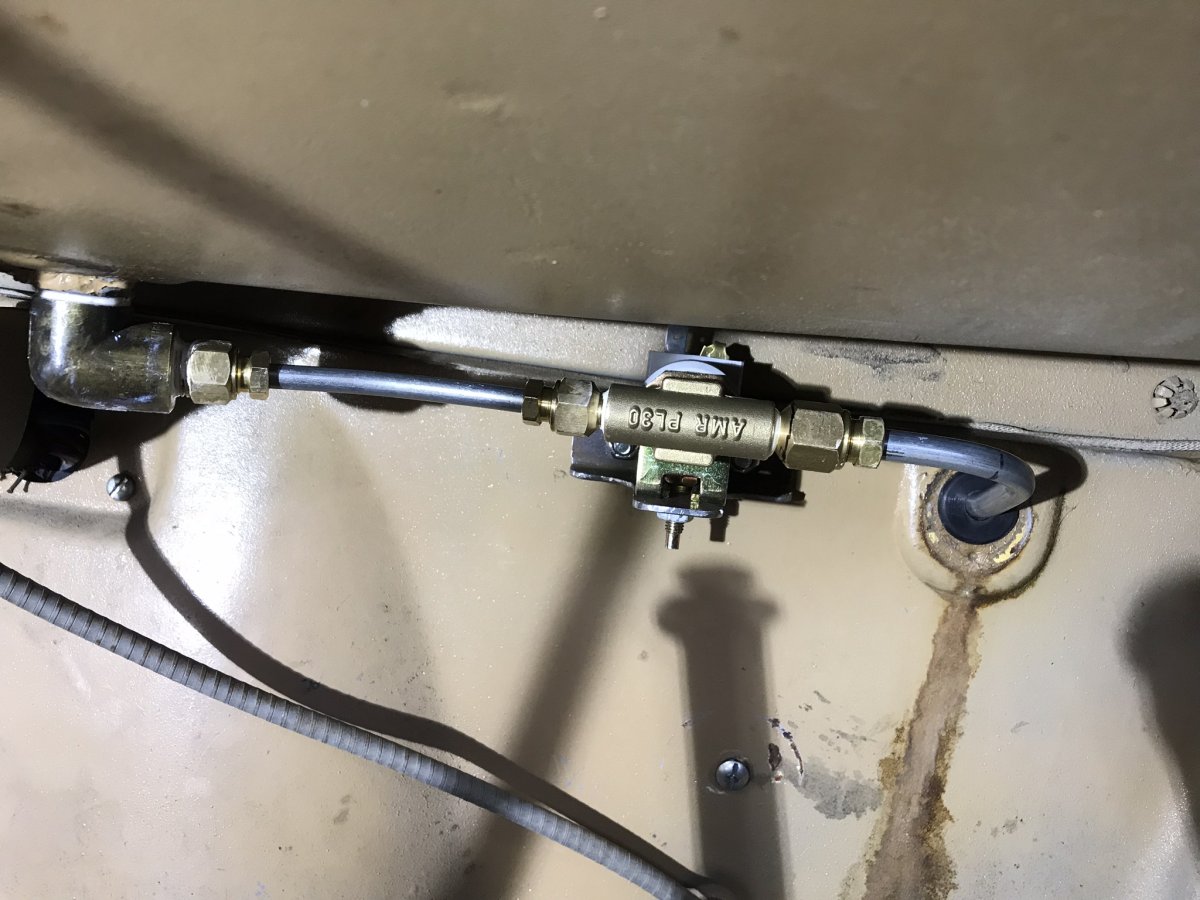

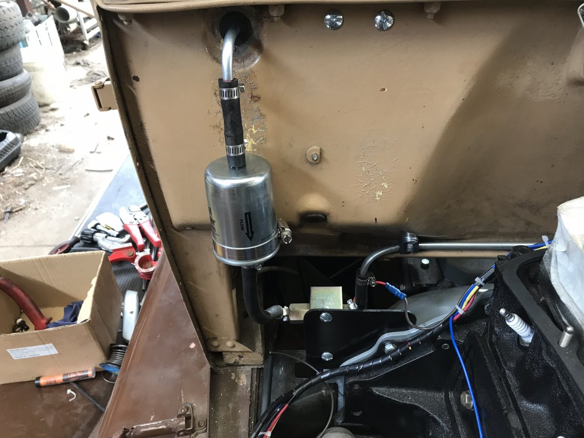

    I put mine just under the toe board mounted on the rear edge of the bellhousing,,I also put a 12volt cut off valve in the tank to eliminate the manual valve ,,and it runs through a decent fuel filter,,

    Yes there are. The Facet cube style pump that Roddy shows can be bought in a configuration that puts out low pressure and they are quiet and also shut themselves off when up to pressure.
