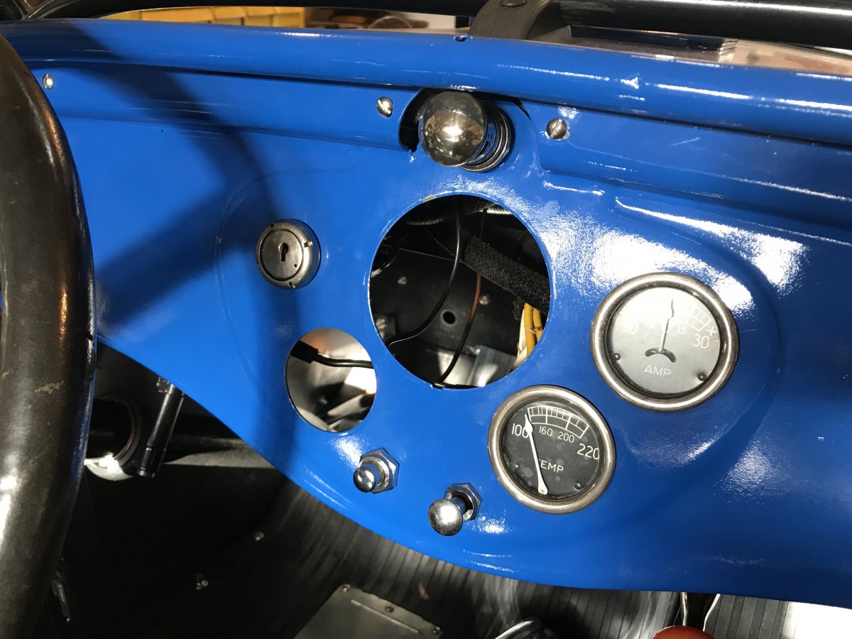

    My choke rod is a homemade affair with a knob out of a junk box. There was writing on the knob that said, “Pull for Reverse,” so I assume it’s off an electric motor. This elicited a lot of puzzlement at shows—Them: “Does that really make the car go backward?” Me (deadpan): “Yes. Reverse is servo-driven.”
    But I tired of the fun, and came up with this solution:

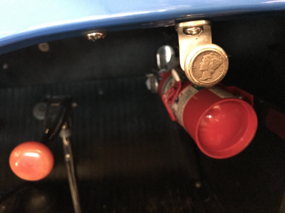

    It’s my contention that every hotrod north of the Mason-Dixon Line should have at least one component made from an old hockey puck. Here’s mine, the center-stop on my windshield.
    Again, in the interest of tradition, I was careful to select a proper Canadian-made puck from my bag of practice pucks. Didn’t want to accidentally use one of those Made-in-Slovakia things formed out of Soviet industrial waste.

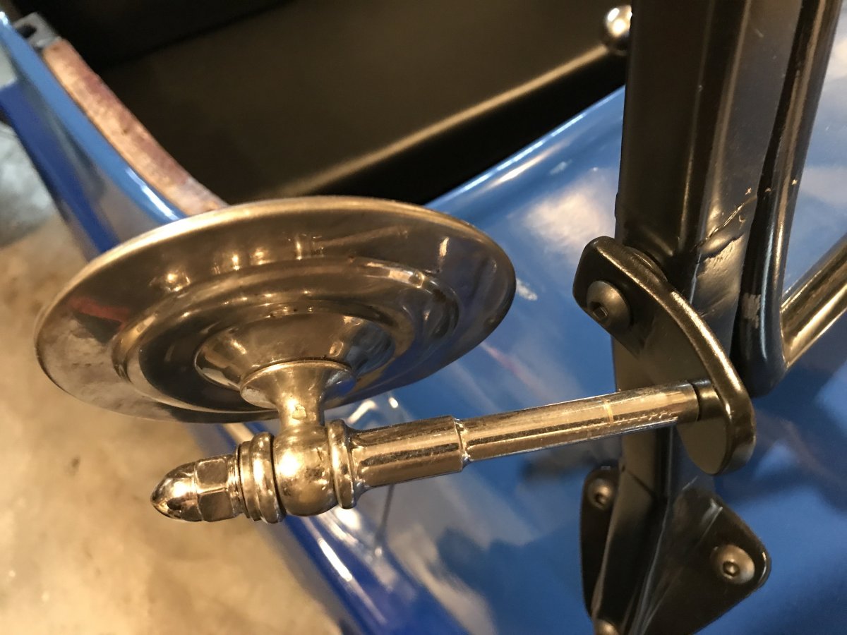

    While we’re talking windshield, I also made some super-simple brackets for my mirrors. These mirrors are vintage and very cool, but have only a tiny adjustment. Thanks to the bracket, I can actually use them now.

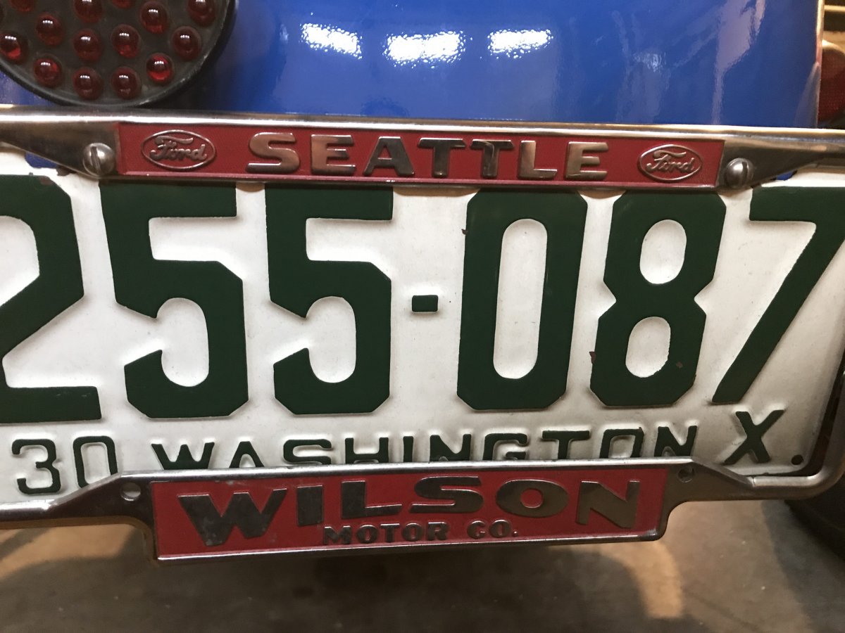

    Got framed
    While helping some friends clear out a relative’s house for sale, I found this very cool license plate frame. They were happy to give it to me, and I couldn’t get it on the car fast enough.
    Ballard’s Wilson Motor Co. was a Ford dealership dating back to 1923. Which means they were in business at the tail end of the Mercury Body run. And my speedster came out of Ballard. So who knows...?
    While this license frame is obviously much newer, it’s still damn cool.

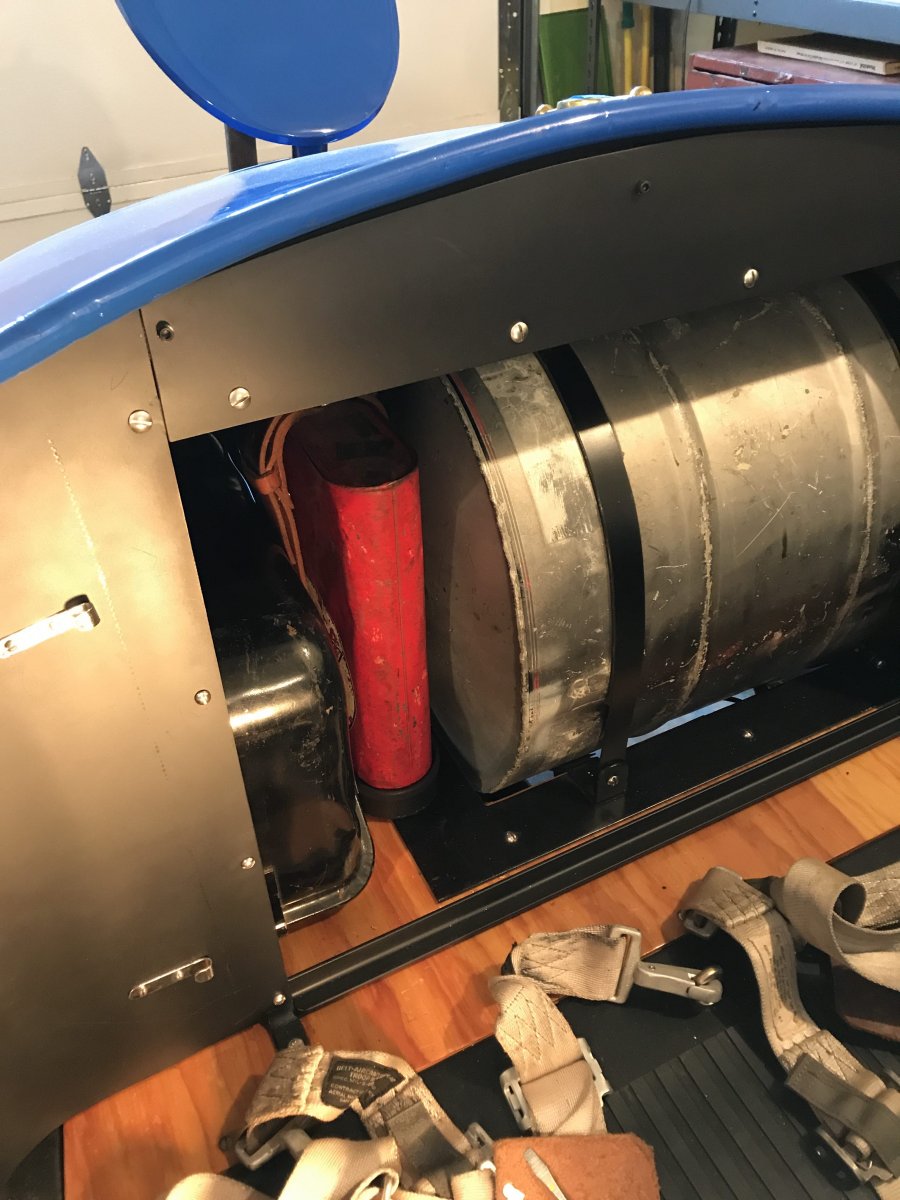

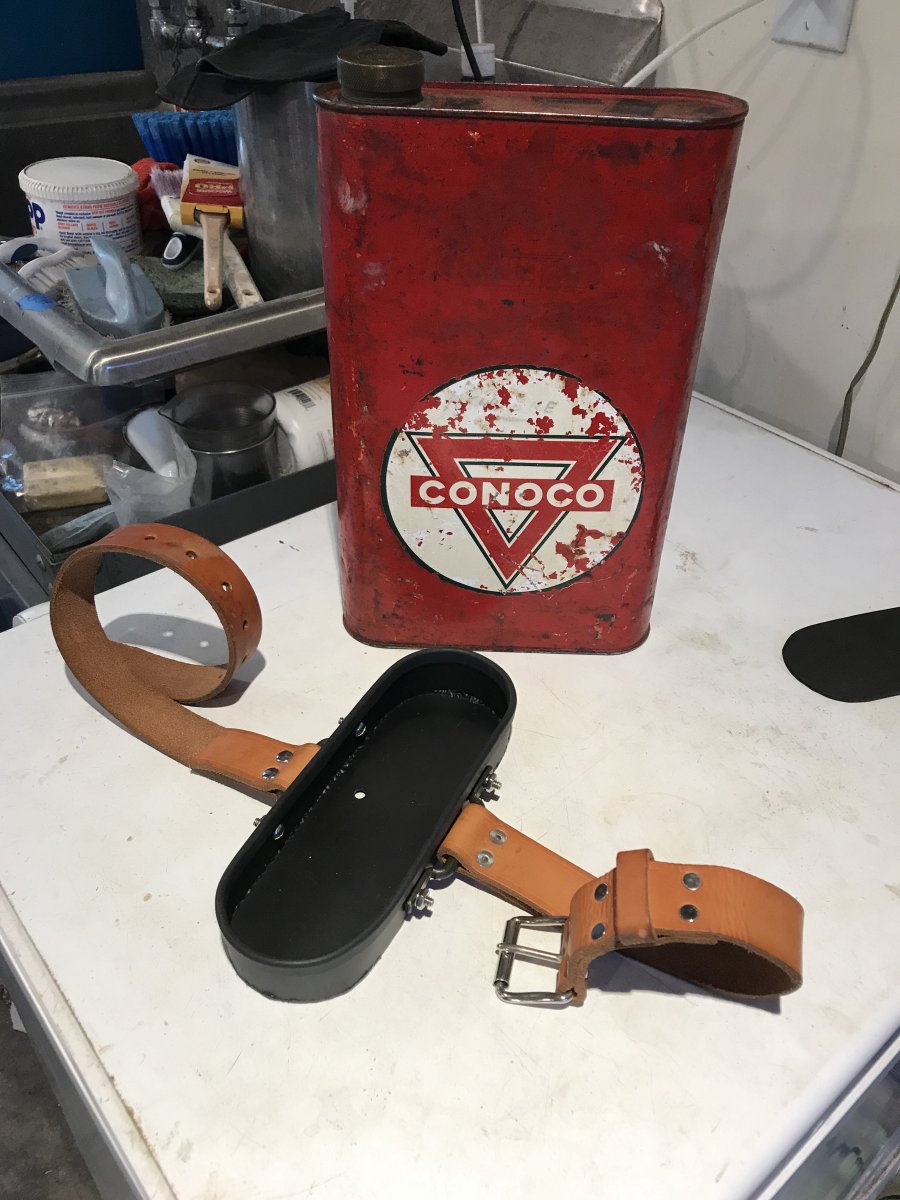

    Now that I’m venturing farther with this car, I need to carry a lot of emergency supplies. But the car is so small, every scrap of storage space is precious.
    I found this neat old gas can at the Portland Swap meet; still watertight. I built a holder with straps for it.
    It fits snugly between the battery box and fuel tank.
    Since it’s old metal that could eventually leak, I use it to carry extra coolant, not gas. For gas, I use a modern camp stove bottle, also in a home-made carrier.
    I figure the contents of that bottle are good for a couple miles at best—just enough to get me out of trouble. And yes, that is a rubber tire-chain tensioner holding the bottle into the carrier.

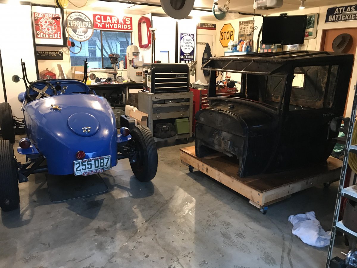

    The answer came home with me on the trailer last week.
    It’s an early ‘28, and remarkably rust free. Big shout-out to @Hitchhiker who put me onto it. I kid you not, the cab won’t need a single patch panel. It’s that solid. A little dented, but solid. The wood is even good! Still, it’s got a list of issues that will keep me occupied through several winters. Most notably the horrid farm fixes to the door hinges…
    Already removed the cab so I can get started.
    Now the speedster has a garage buddy, and I’ve got a fresh project.

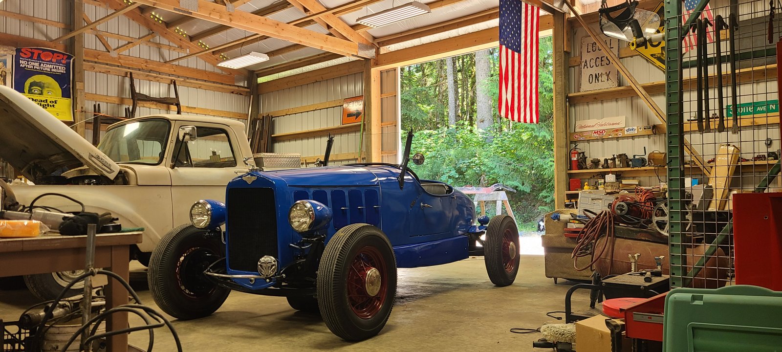

  20. I'll let @ClarkH fill in any details if he wishes....but basically the speedster is here at my shop for some stuff and I snapped this great shot of it under Old Glory.
  21. 41 GMC K-18
    Joined: Jun 27, 2019
    Posts: 3,636
    41 GMC K-18
    Simply one of the coolest cars around, in one of the coolest shops in Washington state.

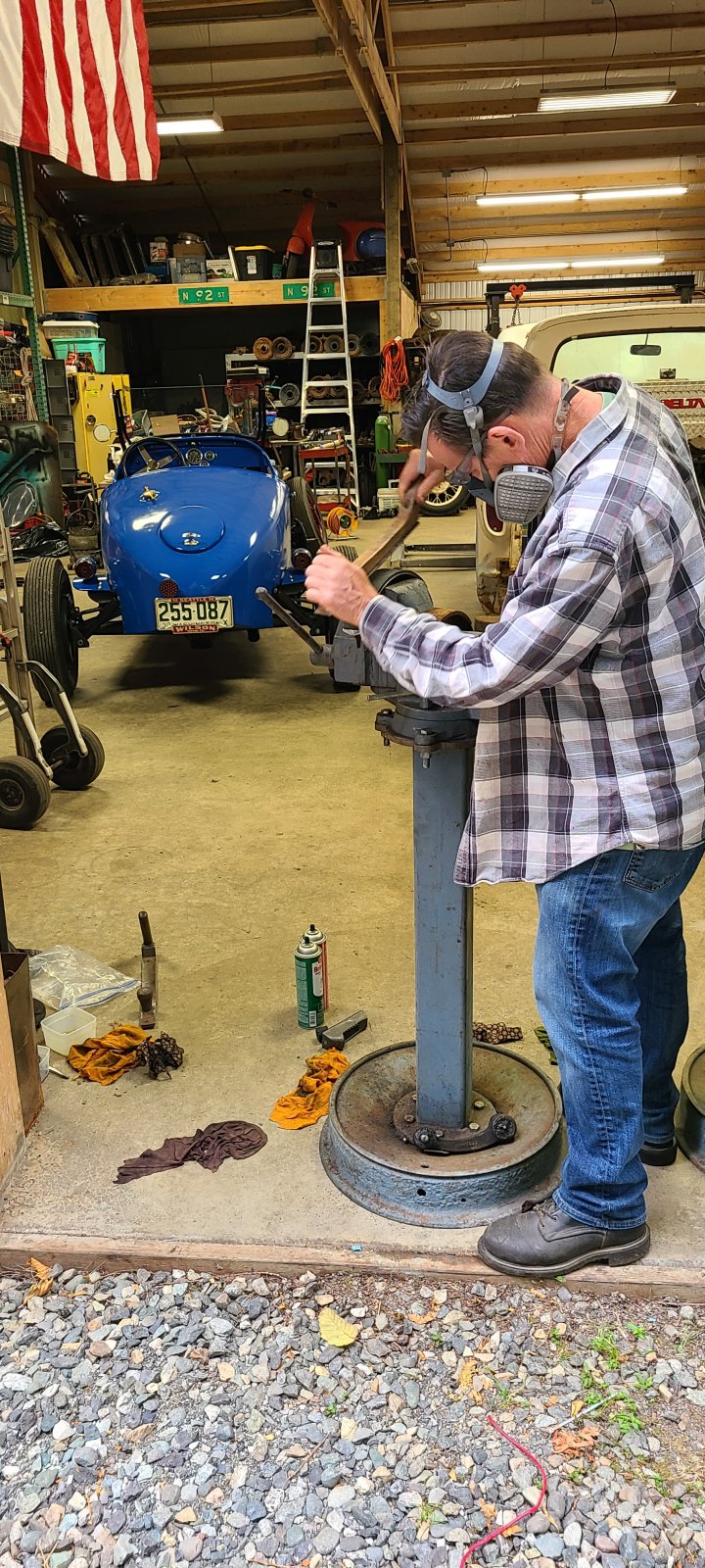

  23. Clark and I replaced the shoes, Clark fitted them to the drum with a body file(sounds hokey, works awesome) and we were able to adjust them to work correctly and evenly. I think arcing them to the drum was 100% crucial to our success. Along with using a feeler gauge for adjustment the car is locking up the wheels perfectly on our gravel test track. He took it home last night and we're gonna tackle the rears this week after a couple parts come in.

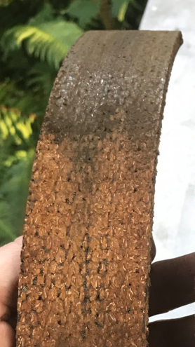

    Sure thing! Here's the lowdown on our DIY shoe arcing.
    The wear marks on the old shoes showed that the arc of the shoes was bigger than the drum, which meant the outer edges of the shoe material were making contact early, therby keeping the middle of the shoe off the drum. Like this, which is from the passenger side:
    The driver side was worse (see picture below). The driver side also has contamination (another factor), which darkens the material and kind of hides the arc problem. But if you look close at the picture below, you'll see that on the leading (longer) shoe, only the top and bottom inch or so are making contact. And there's even less contact in the rear (trailing shoe):
    By the way, in the above description I am not mixing up the leading/trailing shoes: On these early Lockheed brakes, the big shoe is the leading shoe. I know that's not what we were all taught in auto shop, but it's correct for these particular brakes.
    To arc the new shoes, we first did a test fit on the drum: I would hold the shoe agains the drum while @Hitchhiker used a feeler gauge to confirm the fit. At the outset in each case, the feeler gauge could be inserted at the peak of the shoe arch and slid sideways for several inches. So the center was high, meaning the arc of the new shoes was bigger than the drum.
    I used a body file to carefully remove material in a pattern that mirrored what you see in the first picture above. The body file is a trick I learned on the Hamb. I've also heard of guys using wood rasps and even angle grinders, but that strikes me as overly aggressive. (But of course, I'm an amateur when it comes to this.)
    I'd start about 3 inches in and work toward the edge, taking off more material the closer I got to the edge. I didn't use a lot of pressure, and the material came off in very fine pieces. Periodically I would stop so we could check the fit with the feeler gauge. In this way we kind of crept up on the fit without going over. When the fit was good I would use the file to chamfer the leading edge of each shoe (top on the leading shoe, bottom on the trailing shoe).
    At assembly, we were helped out by the fact that the front drums had a small slot cut into them that allowed Matt to insert a feeler gauge to confirm the shoe-to-drum fit on the car. This was recommended in an old Ford service bulletin that Matt found in his amazing stash of literature.
    Took it for a test drive and the difference was night and day. Before, the right front was doing most of the work; in a panic stop it would lock and the tail would whip left. Now both front brakes are activating in unison, no more freaky tail whip, and stopping distance is greatly improved.
    Looking forward to getting the rears done next. We had the parts, but Matt did not like the look of the bonding on a couple of the new shoes; he could insert a feeler gauge deep between shoe and material, which made it a candidate for cracking. So we're asking for replacements.
    For the record, we found and corrected few other issues. This included a weeping wheel cylander--brand new with only 500 miles on it. That was the drum with the contamination. And yes, it was an import.:mad: Fortunately Matt had a quality replacement on hand.
    Also, the adjuster hole in the left side trailing shoe was egged out. The adjuster cam still worked, but since that particular shoe shows hardly any contact, I think there might have been an issue under load. So that's something to look for if any of you are doing rebonded exchanges with Mac's, which is where my old shoes came from. Never again for me. New shoes came from the Ford Store.
    The silver lining to the cloud of brake grief: in all this adjusting with our ears close to the drum, we discovered a bad wheel bearing. We could just hear it when spinning the wheel during adjustmnt--cleaned the bearings for a closer inspection and the wear was evident. Fortunately, again, Matt had new inner and outer bearings on hand. This is all prep for an upcoming 300+ mile endurance run. A wheel bearing failing mid-trip would have made for a miserable weekend.
    Huge props to Matt for all his expertise. It's a nice payback for the umpteen moves I've helped him with. :D

    I’m not quite seeing the pattern you mentioned as being in the first photo but this is plenty
    Of info to go off! I’m tearing my back brakes apart for some service and have always kinda wondered how much contact is actually being made. Now I know how to check! And what to do about it
    Stogy, kidcampbell71 and loudbang like this.
  28. ClarkH
    Joined: Jul 21, 2010
    Posts: 1,424
    ClarkH
    Here's a close up of the pattern I'm referring to. Note that these shoes were orginally light brown in color.
    From the top:
    The first 1.5 inch of the shoe it is smooth and gray--full contact.
    The next inch that is also dark, but not as smooth--some contact.
    The next 3 inches is light brown, no visible wear--no contact.
    That same pattern is mirrored on the bottom.
    Hope this helps!

    Oh ok so the pattern your trying to file so the color/contact pattern of the existing touch surface is the same as it was but the brown center
    Actually touches the drum now.
    I was thinking you ment a pattern of filing only horizontal, cross hatched at a 90 etc.
    got it
