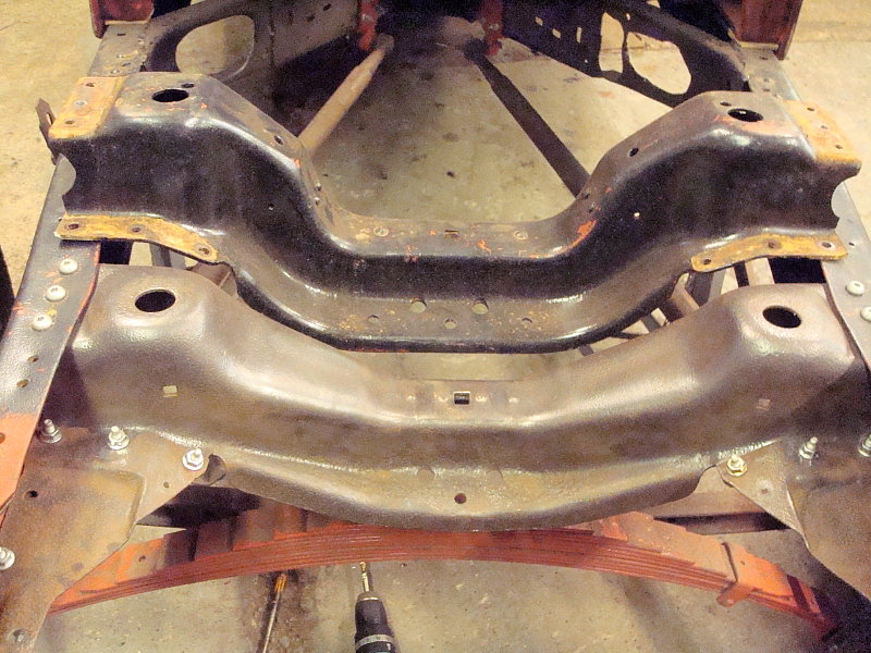

    This looks exactly like my 41's deep crossmember for the longer length of the 6 cyl introduced that year. I haven't measured yet, but I think that the 39-40 car crossmember will additionally lower the front end. I'll do that tomorrow, if you would like to know. Lower is better, right?

    Heck yeah, I'd like to know.
    I thought that it looked odd.
    Thanks,
    Rich

  5. doyoulikesleds
    Joined: Jul 12, 2014
    Posts: 306
    doyoulikesleds
    That crossmember looks like it woul make putting a 302 in there alot simpler
    LOU WELLS likes this.

  17. I measured both. There is a 1" difference.

    This kit also mounts the front spring hangers inboard of the frame.
    There shouldn't be a need for lowering blocks...

    Remove the 41 front crossmember...

    And install nice 40 crossmember...
