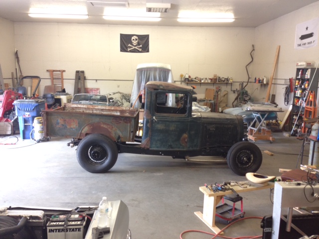

    Didn't make it to the Lonestar Round Up but had some straight pipes installed. Now we are getting ready to mount the pickup bed, it's a 1934 bed I found in Houston, Texas about 8 years ago...

    Was able to set the bed on top of the frame but there is a gap and can't figure out what's wrong. I purchased this bed a few years back as a 1934 Ford pickup bed. I'm wondering if maybe it's not a 34 bed, anyone ever had this issue?

    Just a guess but 32 had a 106" wheel base and 34 were 112" . Possibly a 32 deck. What does the tailgate look like?

    the length is 71 1/2", let me post a pic of the tailgate

    Need a closer pic of the side shot in front of the wheel. Is the body line dimpled for the rivet?
  21. That sure looks like it's a '32 bed.

    The bed you have is absolutely a '32.

    Yeah, I have a buddy that just confirmed this as well. If I can't find a 33 or 34 bed I'll just have to modify this 32 bed to work.
