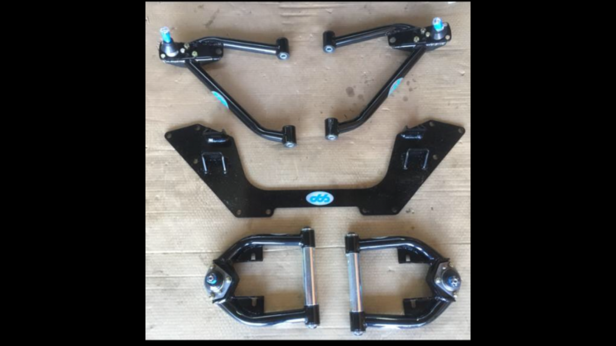

    Clips are nice as they make more room in the engine bay and take the rear steering linkage out of the path of the oil pan. CPP and CBR both have bolt on suspensions that maintain the factory clip. The CBR system offers a forward mounted rack and pinion conversion option.. CPP doesn’t have this option available. Another possible option is TRZ I believe they make make a rack and pinion setup for the early Chevy IIs but I haven’t looked at their stuff in depth..

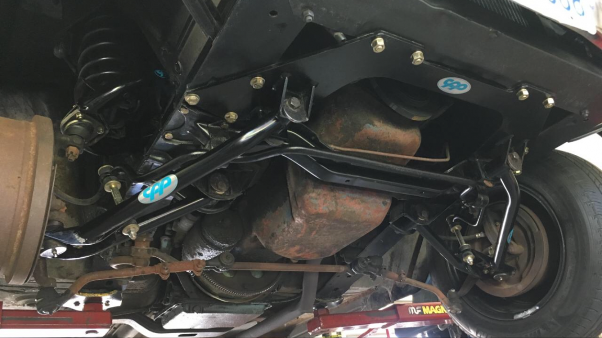

    Thanks for sharing, your front end sits right for what I'd be looking to do. You're right, doesn't solve the pan, and header clearance. I would imagine a clip would have a weight savings over the CPP kit?. The TMZ parts look impressive.

    The CPP kit doesn’t lower the ride height. I clipped one complete coil round off of my front springs. This brought the front end down 2”. This car is just a cruiser for now. I needed it to be a decent driver for the time being not a long term project.. The CPP kit fit the bill for what I needed at a very reasonable amount money. It’s a really solid setup, a very simple concept, and a quick install.. The 63 in my avatar is in the long term spot at this time and still has a ways to go. These cars are pretty flimsy and need structural reinforcement especially if putting in some decent power and sticky tires. A lot of chassis flex. Post cars are supposed to be a little better but I don’t imagine it’s by an appreciable amount..

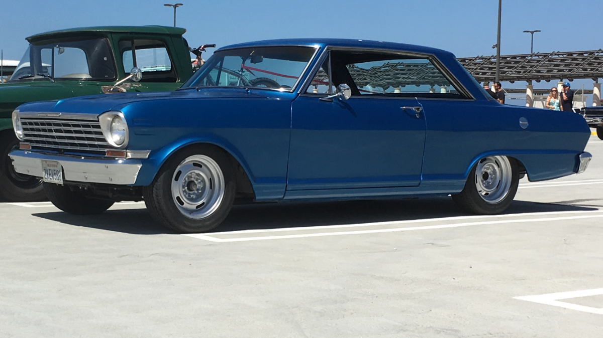

    Like this?
