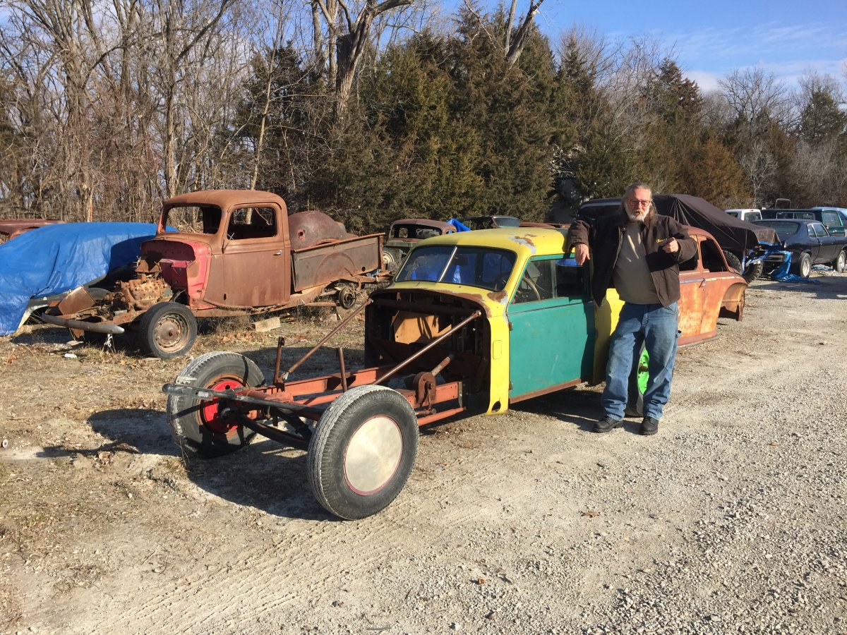

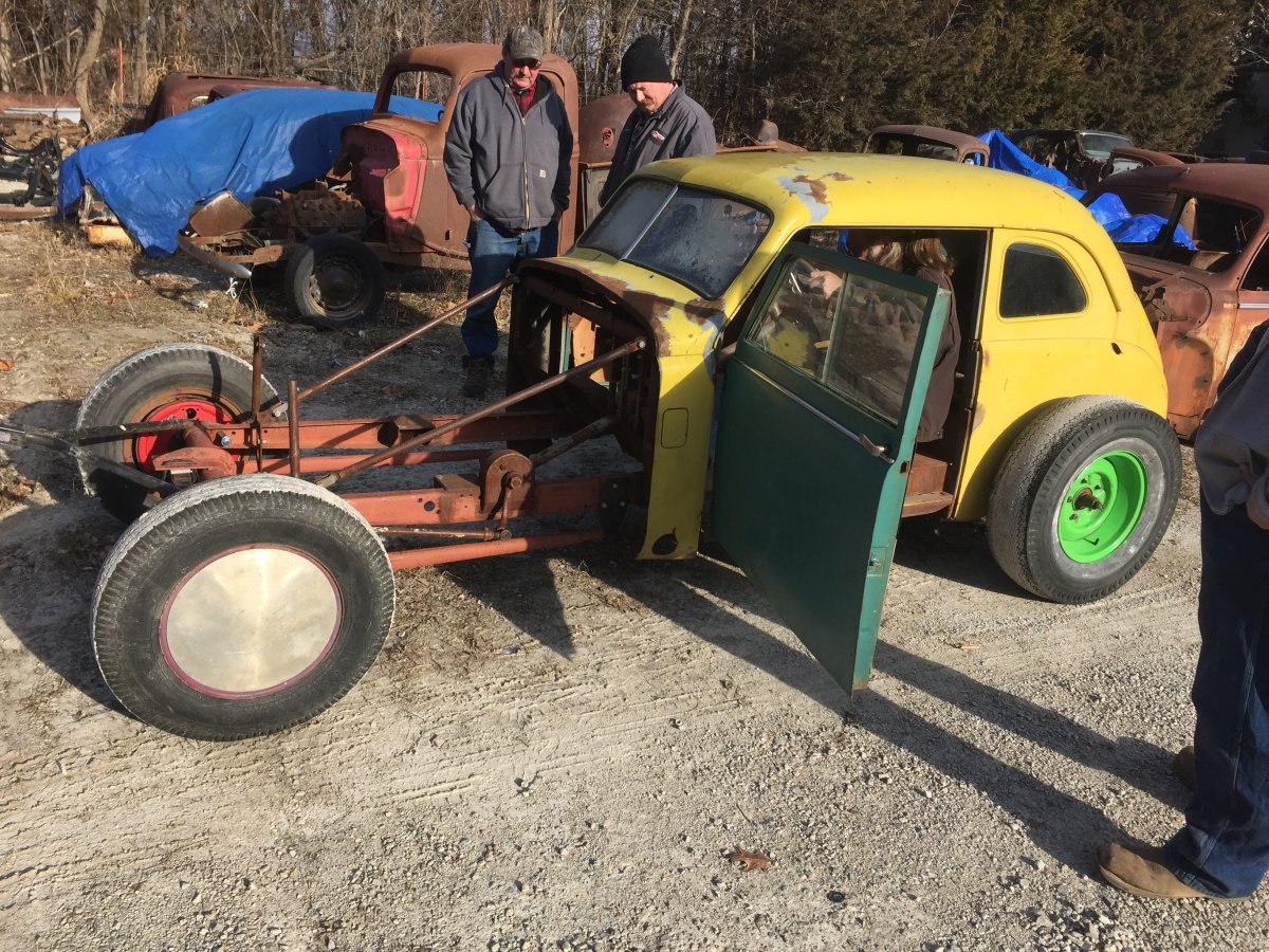

    Beaner, did you pick up the Crosley in Eudora? Surroundings look familiar. Looks like a fun project.

  18. Austin kays
    Joined: Jul 24, 2016
    Posts: 660
    Austin kays
    Yeah that's where it came from. Jimmy flowers had it

    Alright doing a mental inventory of what beaners got hanging on his walls I think what he’s gonna need in order to blast it around the block for the first time is as follows.
    -open drive conversion for the 40 ford rear
    -driveshaft
    -brake guts and cylinders for all 4 corners~ 40-48 ford backing plates
    - master cylinders, thinking he wants to run Chevy jam jars
    -ladder bars for the rear with pan hard bar
    The rest would be normal stuff like hardware, brake lines and fittings.
    I know he’s got a cheap 4 link and brackets on the shelf and Austin isn’t likely going to use the long rear wish bones on the model A so in theory we could use the radius rods/ bones as the lower leg, then use a 4 bar link for the top bar, maybe leave the ends adjustable and mount it to the lower with a tab? Use another one of the 4 bar links for a pan hard and then build something to bolt them to.
    Unless someone’s got a pete and jakes ladder bar set up and crossmember they keep tripping over lol
    Just doing some chores and thinking about what it’s going to take to get this thing in the track in August.

  20. Rich,
    I think that times go in both directions on the salt. I have spent some time looking at motorcycle records for example and seen them for 750CC modified as low as 74 MPH, in an era that a typical 650 Triumph stock would run in the 100 MPH range. On the other hand it seems like the blowfish went stupid fast with a 4 cylinder.
    I must say that there are some interesting Crosleys on this thread. I hope no one is expecting me to compete when it comes to fit and finish, I am just a broken down old mechanic and I would hate to have anyone to be disappointed.
    Tim's list is pretty close to correct, some of the stuff I can manufacture and some of it I will just have to bite the bullet and buy. Could be worse, I could have an empty garage and no prospects. LOL

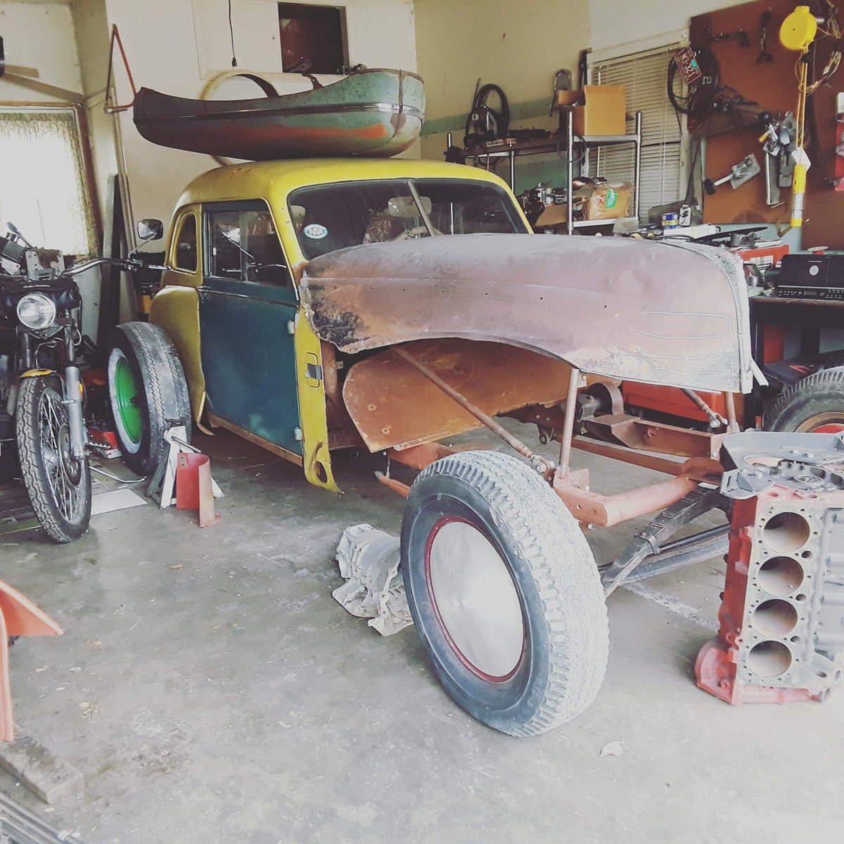

  25. So I was just over on the drag snake thread ( pretty damned cool build) and reading what @Deuced Up! posted got me to thinking. I wonder if I have room for my old plastic seats in the cab of this little bugger.
    I am getting over the flu a little bit so maybe today is a good day to drag them out and see if they fit. Gawd I hope so. Try and snag a pic later if I can.
  26. Tim
    Joined: Mar 2, 2001
    Posts: 17,097
    Tim
    from KCMO
    I bet your shoulder to shoulder. If there’s any interference it’ll be with the trans/driveshaft tunnel I’d guess
