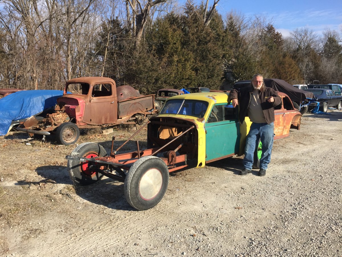

    The Old Crosley was actually in the possession of Jimmy Flowers when I first lay eyes on it. That was pre ice and snow the Saturday before Christmas. I talked to the little car for a minute, it showed me its private parts and said, "Can I come home with you Mr.?" How could I say no?
    We laughed over the weekend that my cars are progressively getting smaller.
    But you do got to love a car that makes a little bugger like me look big. :D
    We figure if I live long enough I will end up with a 409 powered skate board. ;)
    So loading was fun. 4 of us lifted the front end up on the trailer. I think that one or two could have loaded it as it sets the same way but the ground was a skating rink. We figure that as the car sits is can't weigh more than a thousand pounds.
    The trailer was actually overkill, it was a lot like hauling a go kart in a dump truck but it is what we had.
    So now we are home and getting it unloaded, we used some real flimsy harbor freight ramps, kind of cheating but well you know we had 'em.
    And here she is all nestled in her bed.
    Now see the nest installment. If you are still reading this tripe, and maybe I should thank Jimmy for putting me in this heap, @Austin kays and @raven for help hauling the little beasty.

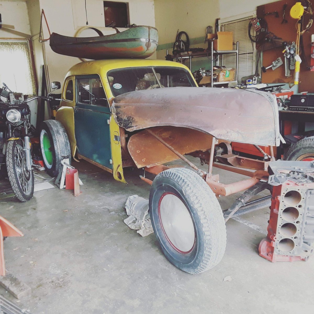

  4. So a little back story on the little coupe. The car was originally built in the '48-'52 time frame by a tool and die guy in East St Louis. It was powered by a full house 390" Cadillac flathead and backed by a '39 Ford transmission. It raced one season @ B-Ville then street/drag raced after that until about '57 when the guy got bored and decided to road race and bought a 2x4 Vette in road race trim from GM. The story goes on but we are really interested in the car right? :)

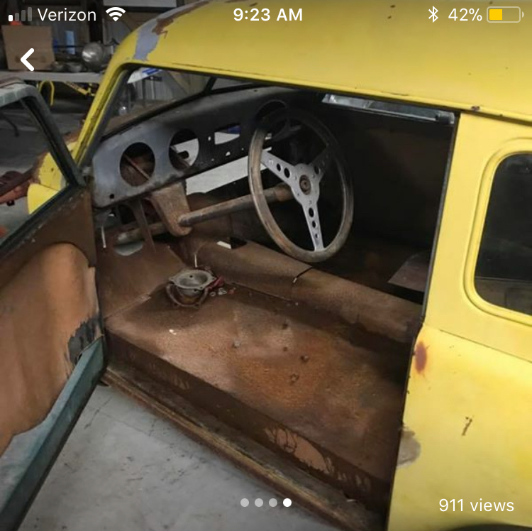

    It is basically a 48 or so Crosley coupe channeled on a stretched A chassis. It has '40 Ford axles (and brakes) on both ends as well as '40 wheels, an F 1 steering box, a home made steering wheel. The original door latches while they need a little adjustment still work, it still has all the original glass, original dash board and after that the body is little more than a tin can. I will get more photos in time but everything on the car is top notch, it is not built like your typical race car of the era.
    Now the builder took some of the inches that Jim ( @squirrel) usually takes out when he moves his rear end forward, what used to be a 103" wheel base ( I think) is now 111" and mostly moved toward the back. The rear is spring behind and the front axle spring in front.
    The car originally ran a nose made from 2 '40 Ford hoods welded together. The nose is long gone but I got a '40 Ford hood and a '39 Merc hood in the deal and I am going to attempt to make a nose that resembles the original. Wish me luck,

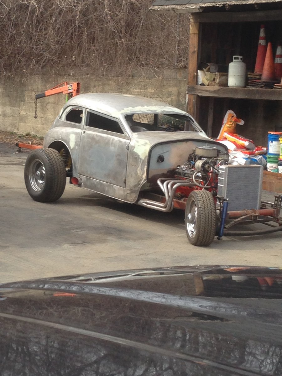

    IMG_1279.JPG IMG_2460.JPG Looks like my buddies car.

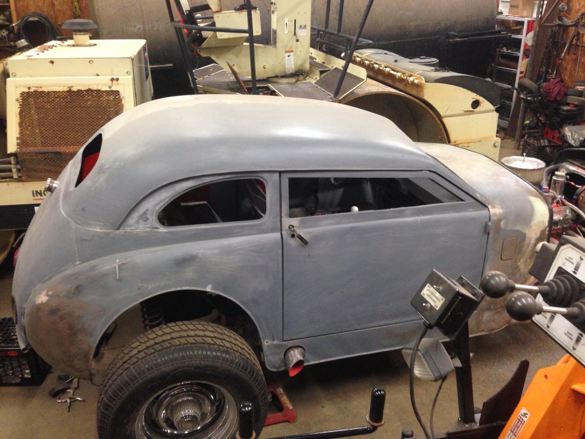

  17. They are all built a lot alike, I think that they didn't change the body from '48 until they went out of business. The original motor was smaller than my motor cycle motor. Here's a pic of a race prepped Crosley motor. All 750CCs of it.
