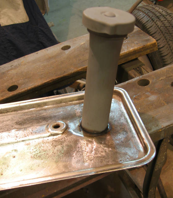

    Since the idea of this build was early 60,s I felt I had to do something about the PCV system. To keep a good working system and retain all the components this was the plan, relocate the PCV valve and keep the breathers, easy. Located another valley pan and made up a filtered baffle to allow vapor and not oil through and PCV valve mount in the rear of the pan and mounted an oil fill on the front of the pan. 1953/54 Buick valve covers were source without any oil fill and a pair vintage Offenhauser breather located to install on the valve covers. This will be complemented with a pair of 1953/54 Buick spark plug wire covers that I made mounts to use with the later engine.
