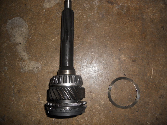

    I've searched high and low, found tons of info, but nothing addressing the assembly of the parts in the picture. I pulled the input shaft from my world class T5 to replace it, was a little careless, and a few small parts scattered when the input came out. I got the needles and thrust bearing sorted out, what I need to know is whether this "spring" is installed before the blocker ring goes on the input, or after?

    You sure that's not a shim from under the bearing retainer? I don't recall that sort of thing in the input/output shaft area...

    Hell, I'm not sure of anything except that it fell out when I pulled the shaft. Under the bearing retainer may very well be the spot. It's definitely intended to provide tension/thrust as there is a wave to it.

    The bearing preload & endplay is determined by shims under the bearing retainer. I've never seen them with a wave to them, but that doesn't mean anything.

    Post up measurements of it and one of us can tell you if it's a front maindrive bearing shim for sure.
    The wave of it reminds me of a reverse blocker ring wave spring from a T56 though.

    It is .015" thick, 2.50" outer diameter, 2.14" inner diameter.
    The transmission is a world class from an S10, 14 spline input shaft with GM pattern. I decoded it to 1993, but have since misplaced the tag and don't remember the number. It has the 3.76 first gear.
    Don't know if any of that helps to identify the part/placement. Here's a side view picture of the spring/shim.

    I have rebuilt several late model T5's and never had a wave spring. In my opinion it would not go between the syncro ring and the shaft. I would think you would put the wave spring into the trans first then set the syncro ring on the shaft and put them in as an assay. then your front bearing retainer to hold it all in. Maybe they use it to hold the end thrust on the input shaft out toward the bearing race?

    2.519" , 2.120" , .031" on a WC camaro V8 box. I'd say you have an acceptable but interesting input bearing shim.

    OK, three people now suggesting it is a shim for adjusting bearing pre-load under the retainer bearing race. That's what I'll go with on the new input shaft. Appreciate the feedback!

    I think I've concluded that is what this had been used for. All of the diagrams, pictures and videos I've viewed show nothing like this.
    The bearing on the input shaft I'm replacing is a bit sloppy, and who knows what has been done over the last 20 years? It turns out that it isn't needed with the new input shaft I'm installing. Adding that shim made things way too tight.

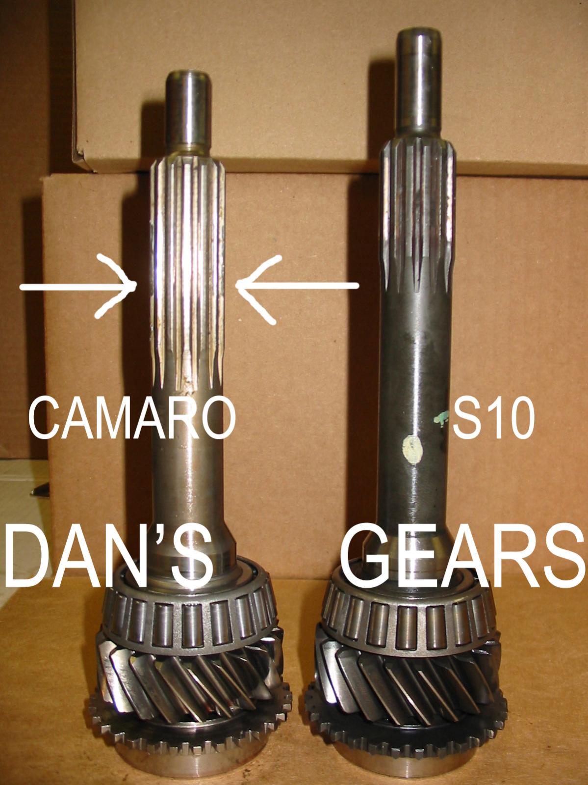

    For whatever it's worth, I am swapping in a shaft for a V6 Camaro in place of the S10 shaft. This will give me the right overall length and longer splines for mating up to sbc. I just need to cut down the throwout bearing shaft part of the retainer. Here is a comparison pic I lifted from eBay.

    Yep, the shafts are identical except for the spline lengths and overall lengths mentioned above. I have the Camaro shaft in the box now. Just need to figure out the amount to cut off of the bearing retainer. Hopefully I can get to that tomorrow, but likely not with it being mother's day. I'll just have to see what kind of mood my wife is in then...

    If you can't measure, I'd start with 3/8" and work up to 5/8" in 1/8" increments. The S10 input is nominally 5/8" longer than standard GM. Many folks find they need to lengthen the splines as well with a die grinder too. This will depend on your actual clutch disk - I prefer to modify the clutch disk rather than the input shaft, but that's not always possible...check and see.

    The Camaro shaft is shorter with splines cut further down the length of the shaft, as seen in the picture. I should be able to just bolt up the gearbox to the bellhousing and go once the bearing retainer is cut down
  18. Splines and pilot are hardened steel and will have to ground of with a stone.

    Die grinder with a cut-off wheel works...

    Regardless, it is WC (has front "Timken" bearing for counter shaft). It has a 14 spline S-10 input shaft and it has the standard GM bellhousing pattern. It also has the 3.76 first gear. I checked with a degree wheel to be sure.
    The shaft I bought, advertised as Camaro V6 input, and S-10 input shaft both have a 21 tooth gear and coarse 14 splines. It is my understanding that the V8 Camaro input has the fine splines (26/28?) and has a higher gear tooth count (maybe 23?)
