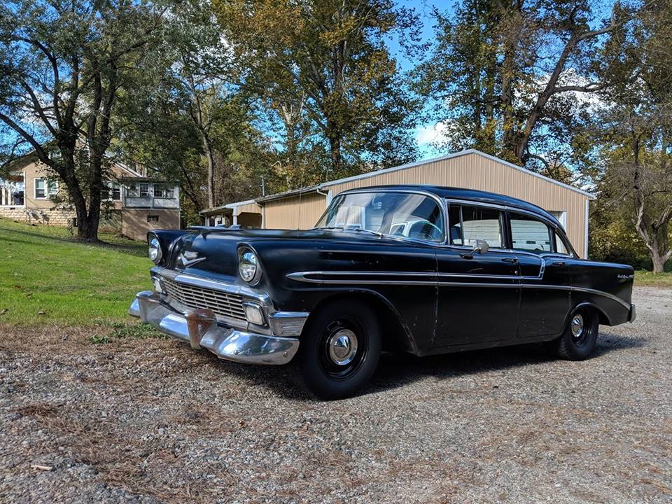

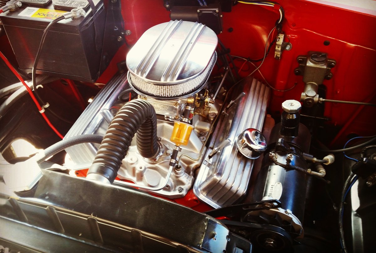

    Thanks low budget. If Tall T 26 doesn't mind, I will tell you the story of my son's 55. A 70 something farmer who attends our Church mentioned one Sunday after seeing my old cars, that he had one my son should look at (the 55). It was in his cattle yard where it's 265 died. I am not sure how long it sat there but guessing from his stories at least 20 years. It is a fairly rust free car with a virgin floor and braces. In fact the only rust is two spots on the tail pan under the decklid and two spots inside the rear door jambs in the dog legs. What appears to be rust in the headlight caps is in fact from the cattle rubbing against it.
    My son purchased it for $300 and spent the next year rebuilding all the brakes, suspension, fuel system and electrical. At that point, needing a drivetrain, we dug into my hoard of parts and came up with a .030 over 283. A used (with matching lifters) L79 camshaft, C4B intake and a 600 Holley. A 3.11:1 first gear Saginaw 4 speed. An Ebay clutch and radiator put it on the road.
    It has been to St. Paul for the Back to the 50s and to Des Moines for GoodGuys. Reliable as hell, gets 18mpg on the hiway and will bark the tires going into third. My advise for Tall T is keep it simple, get it running so your son can enjoy it. There will always be time for upgrades later.

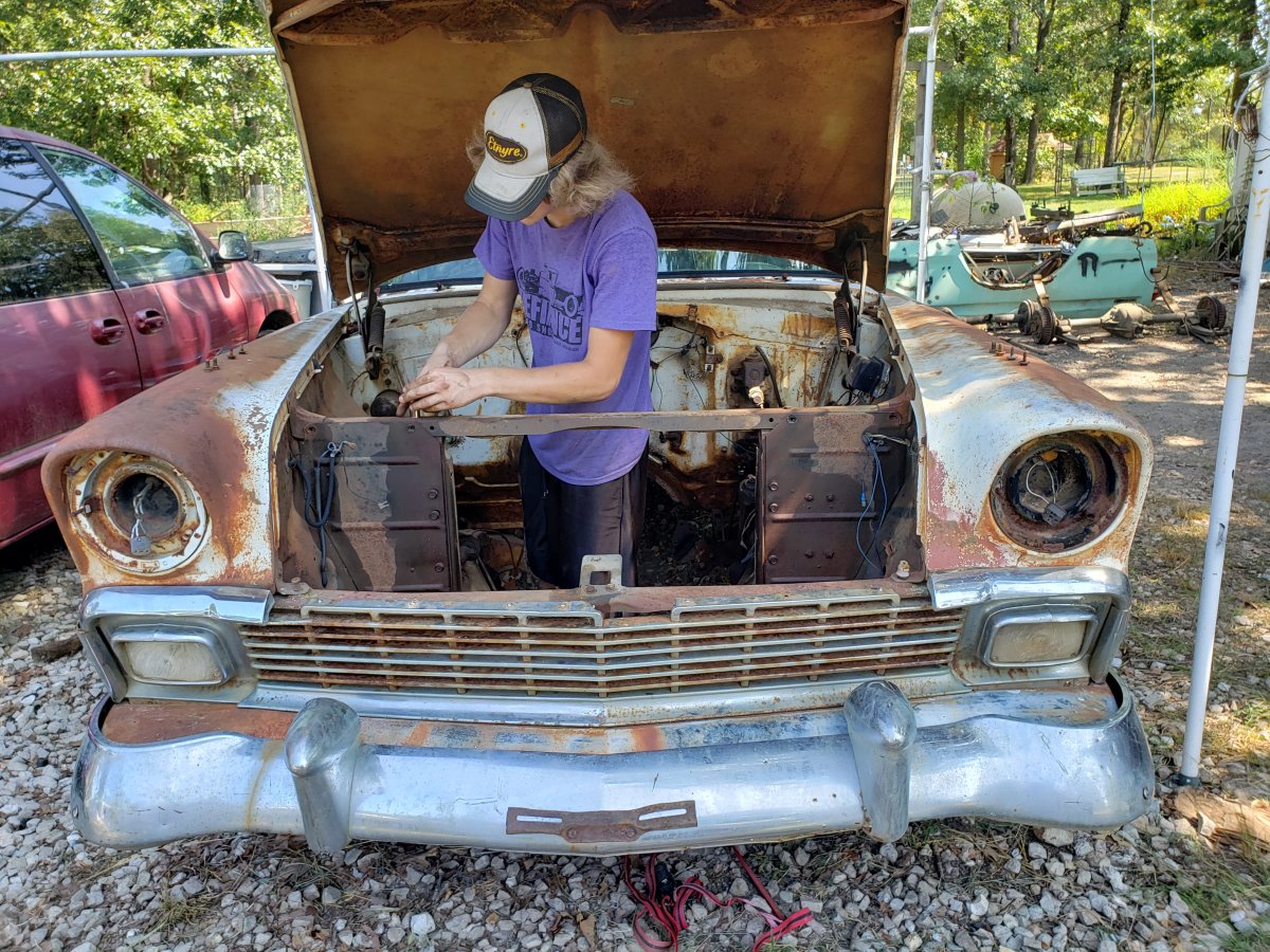

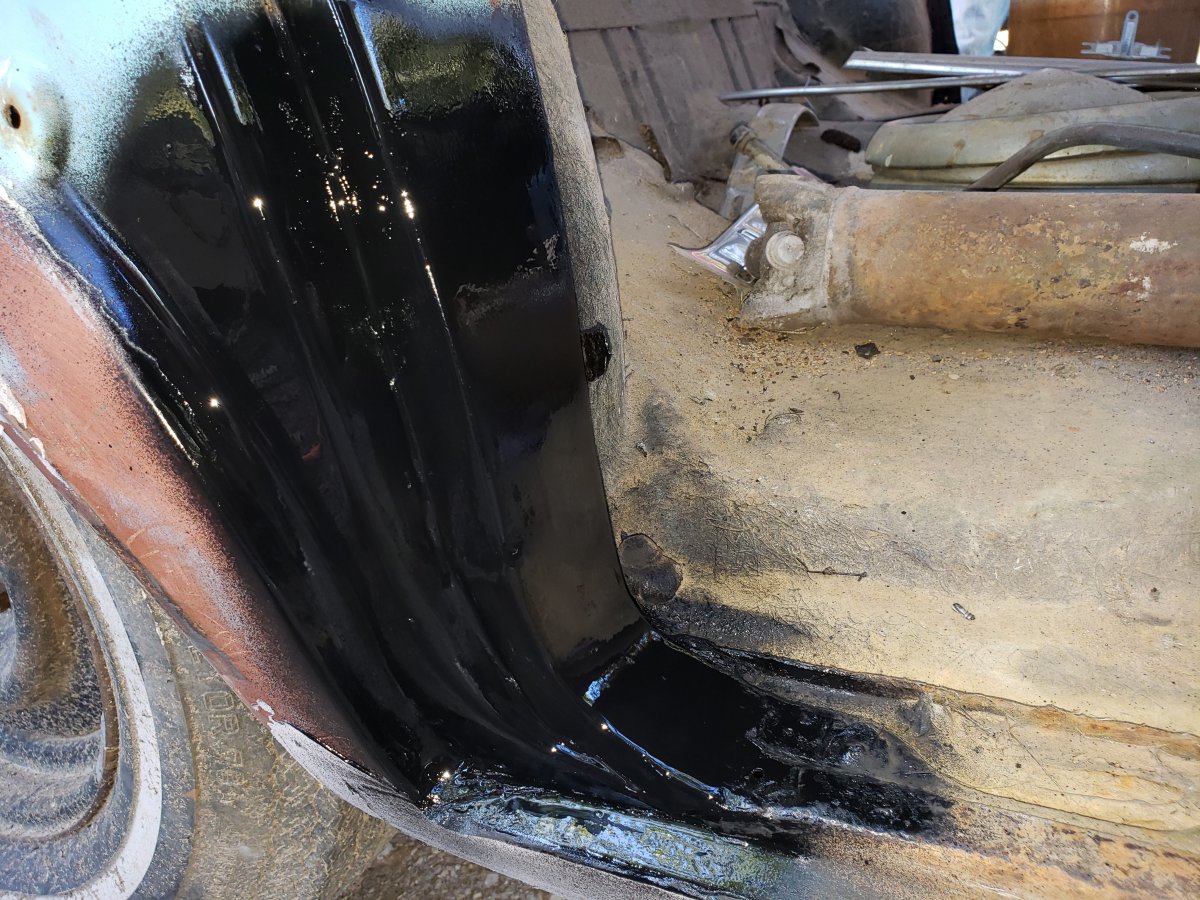

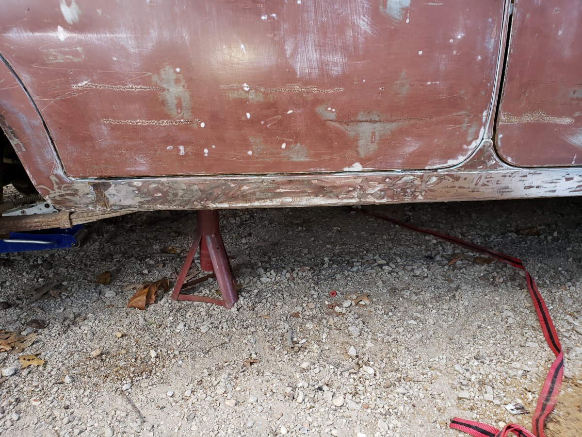

    Here's a few more pics., in some Camden is mocking it up to check and see what parts was in the crates. He also was cleaning up the engine bay a little to drop the engine and trans in. The next few pics. are where he needed to pull a small dent and or cut out and repair some rust. This I think catch's us up on the pics, up until we start again. Hopefully someday this will make him a great cruiser and something to be proud of. Thanks again for following along and sharing in his journey.
