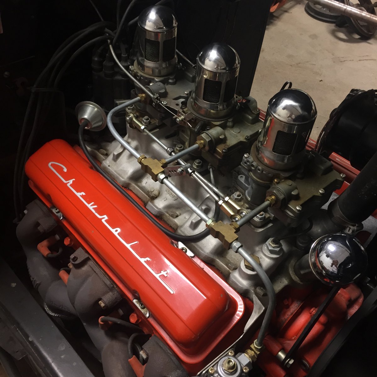

    Nawe... We are kind of going for a '56 look and feel for the car... It's getting three deuces...
    AHotRod and Hotrodmyk like this.
  2. DDDenny
    Posts: 21,645
    The battle's been won, better not press your luck.
    Ryan did originally say they had planned on giving whatever engine they decided on the requisite visuals.
    Hmmm
    Didn't the 283/270 come out in late 56?

    Bader2
    A 56 327?
    cactus1 likes this.
  4. Oh you mean more like this?
    -Brent-, dad-bud, enloe and 8 others like this.
  5. rod1
    Joined: Jan 18, 2009
    Posts: 1,465
    rod1
    I got a feeling..real close to that.Those cleaners are the Bomb
  6. Rand Man
    Joined: Aug 23, 2004
    Posts: 5,300
    Rand Man
    Let's say the rod was being built in '56 about the time that brand new Vette was flipped out on Range Line Road. The owner liked the little 265 so much, he ordered a new 327 in spring 1962.

    a near tragedy has been avoided we may all sleep better tonight
  8. DDDenny
    Posts: 21,645
    Dressed down 327
    Hot rodders never told the truth

    Great choice on the engine. The 327 was the best hot rod engine Chevy ever made.

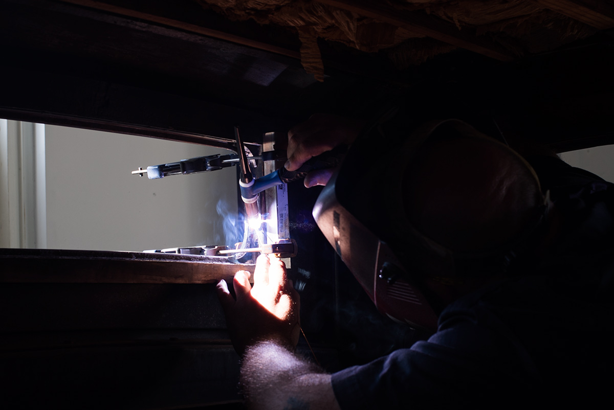

    Finishing up the chop today... The "curly-q" method went much quicker on the passenger side.

  21. Was it a case of figuring out the process making it easier or different fit of the sheet metal from one side of the body to the other?
    tb33anda3rd likes this.
  22. Ryan
    Joined: Jan 2, 1995
    Posts: 22,539
    Ryan
    ADMINISTRATOR
    Figuring out the process. Essentially, the more curly, the more shrinkage.

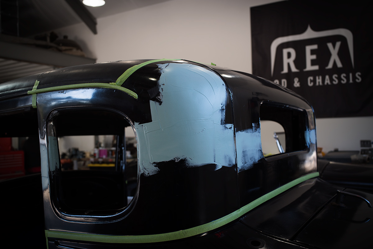

    Slapped on a skim coat of bondo last night. After letting it cure for a couple of days, most will be sanded off and then Keith will blend some new black paint into the old 60's era paint.
