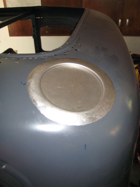

    I bought a gas cap from Crafty B for the car. I decided to mount it at the driver side rear roof area. I needed a flat spot to mount the cap so I mad a die set to create a gas cap insert panel.
    Here is what the die set looked like:
    I took a flat piece of sheet metal clamped it in the die set, added some force via an h-frame press and got this panel out:
    I then punched a hole for tge new panel:
    i then shaped the compound curve into the outer edge of the panel I made and trimmed it to fit the hole:
    When that was all done I tacked and then welded the panel into place:
    here it is with the cap in place:
